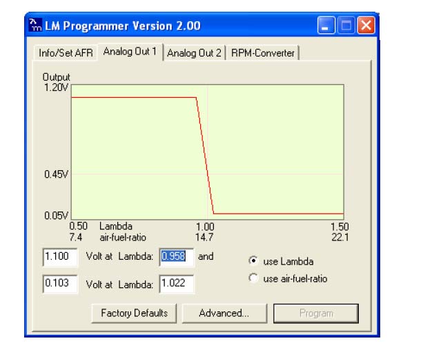

What settings are you guys using. These just do not seem right? See pic below.

what makes you think those aren't right? on the LC-1, those are your settings for your yellow wire. The 0-5v setting is for the brown wire. You need to make sure the voltage scale in LM programmer matches the voltage scale in the rtek software.
1 volt output = narrowband remember?
