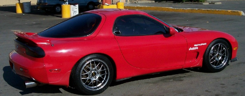

Manny asked and now receives.....pictures
Well, one picture anyway. Manny wanted to see the RG-Rs on a red R1, so here you go. This is my Beast with her new shoes. I did have to raise the suspension about a 1/4" to eliminate hard bump rubbing on the outer lip of the front tires.
Manny, there seems to be a LOT of room between the front stock caliper and the insides of the spokes. I didn't measure it, but I think it's about 'two fingers' (as in two fingers of booze in a glass).
In order to get down to the 100K file size limit I had to sacrifice a little picture quality. The edges are a bit fuzzy - the original photo has excellent quality. I am very pleased with the look and feel. My white side stickers don't match up very well with this more steal blue color (double black) - if I'm going to have stickers they now need to be more of the same color (gray or steel). I'll probably pull them off now.
Beast

Sweet! Fabulous! Enjoy! Glad you had adjustable suspension. 235/45-17 was pushing the limit with clearance because the tires are slightly taller than stock. I'm glad you're happy with your setup!

Is that a real pic, or photoshop? 17" all around? What size rubber?

Yes, I took that photo last Saturday after I raised the collars on my coilovers one turn and hand cleaned each wheel, treated the tires, then washed the car, engine bay, and treated the engine bay with C2 protective resin. The only thing I had to do was edit the picture quality down in pixels using my Kodak software because the original is 2MB and you can't upload anything over 100K.
My bank account is certainly lower - they'd better be real.
Toyo Proxes T1's.
Specs:
235/45-17 for BBS RG-R Type 722--8.5 x 17, 37-mm offset fronts; 265/40-17 for BBS RG-R Type 726--9.5 x 17, 38-mm offset rears
I'm not Amur - no photochoping for me. Manny helped me pick these out after a year of hunting around, and asked me to supply photos once they came in (he had a couple of threads on these wheels over the last year).
Beast

Beast, take Peter's comment as a compliment. Your car looks so good, it almost looks "too good", like the pic was forged LOL The setup looks great, and the BBS RG-Rs are light to boot Enjoy, Eric! FWIW, I copied the pic, and added it to my FD wheel pics archives LOL

Manny, there seems to be a LOT of room between the front stock caliper and the insides of the spokes. I didn't measure it, but I think it's about 'two fingers' (as in two fingers of booze in a glass). Beast
Interesting. Well BBS Japan said the 8.5 wides are the ones intended for Type FD Rx7s, so, I'm not surprised how generous clearance is. Of course The Type RS/RZ/Spirit R front brake calipers are LARGER/THICKER than the US spec front brake calipers, so. Anyhow...ENJOY!
