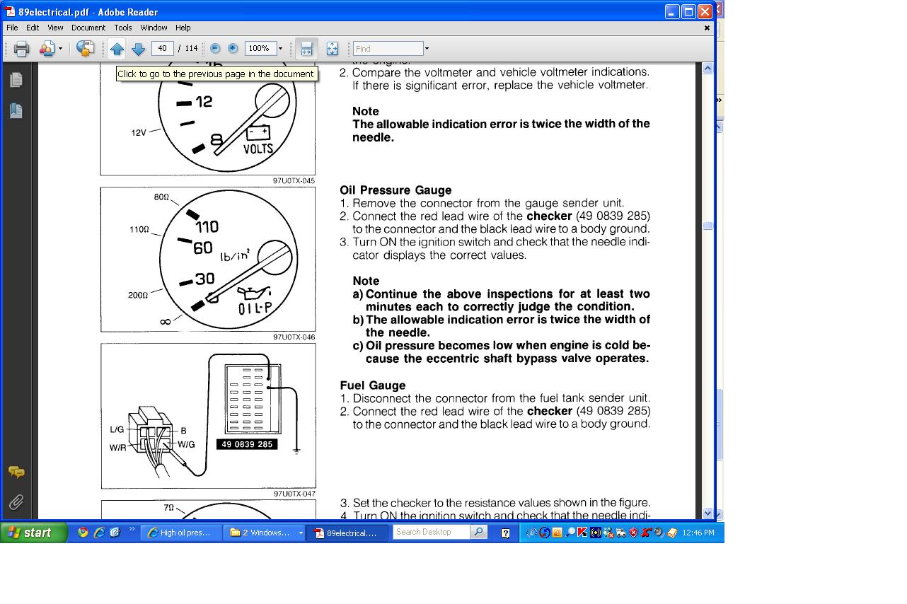

Pretty easy to figure out with little to no cost. Go to the ENGINE ELECTRICAL ..or it might be the Body electrical.
There you find out how to check out the gauges. For the oil pressure gauge you simply buy three/four resistors of the value shown in the picture. Then put the resistor on the output wire of the pressure sensor and the other end of that resistor to gnd.
The gauge will read a given value for each resistor shown in the picture. That should verify the guage being bad or the sender.

So I went to Fry's to get the three resistors called out in Hailer's diagram. They really didnt have any exact matches. Looked at different combos to get the right ohms and realized in those blister backs it was going to get expensive. So instead I grabbed a 250 ohm single turn linear potentiometer for $6.50. It's a Canadian made NTE 501-0003 KU2511S28.
I soldered two leads to the pot and put a mail spade bit on one end which I would insert into the sensor wire and run the other to ground. I used the ohm meter to calibrate the pot and tested the gauge. Changed the setting and retested.
The gauge is good. Fricken slow, but good. Have a mechanical oil pressure tester on the way.
