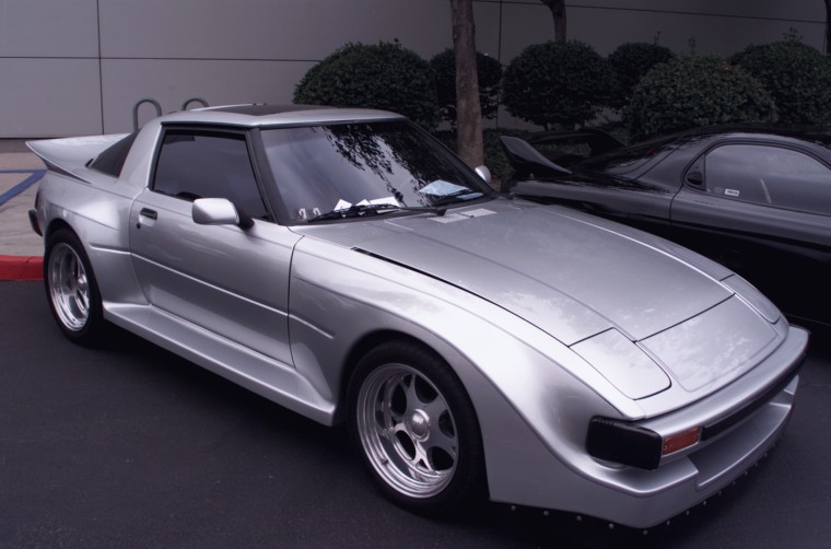

1) I don't believe that's a true Mariah Kit.
2) Mariah sells a rocker panel for it's Mode 4 (non-widebody) kit.
I bought the rocker panels to integrate with my Mode 1, eventually when I can afford to do it again.

I have the same kit, and it's not a Mariah product. Mine was made by the infamous CP Racing. Same kit is now offered by Black Dragon, made in Ohio. Both of which I believe are knockoffs of the old Pacifica kit.
I considered doing something similar to my rockers, until I cracked my lower shin on the lower front lip of the rear fender, ouchie.
My widebody is in the following link.
http://www.rx7club.com/showthread.php?t=462184
