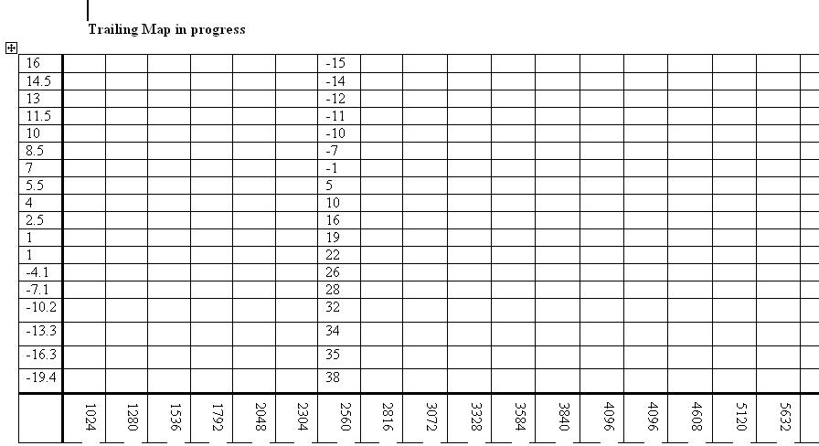

Can you take a look at the attached file, I have filled in the values for the 2560 column. Is this correct??
Do you actually have to input all of the values for all three tables or does the Trailing get filled automatically after doing the Leading and Split maps? I had heard that Trailing is changed when you change Split, but does it does it happen automatically in the software??
Thanks again for all the help with this.

just to confirm, the "split" map posted is in degrees of difference between leading and trailing, correct? It is not an actual trailing map, but a split map, right?
I was the one who mentioned 15 advance 12 split. That is common on FD's at 14-15psi with a medium single turbo. At 10psi on a BNR stage 1, that would be plenty safe, and then you can add timing if you are on the dyno or have an EGT gauge. Or you could go by the butt dyno but it's going to be a bit riskier. I like gxl90rx7's leading map though. When you get on to the dyno, you can experiment a little with the curve at high rpm. You want to have a little less aggressive timing at peak torque, whatever that may be on your setup.
gxl90rx7, you've got a lot of split in that map, more than most people would run if you poke around the single turbo and Power FC forums, and those are mostly on FD's with 9:1 rotors. More than 12-13 split is probably going to cost you power. I experimented with 10 and 12 split @ 18psi on a 60-1 turbo (100 octane unleaded fuel though) and noticed no real difference, so I kept it at 12. If it were me, I would take your 8.5 psi row on your split map and just copy the same numbers all the way up to 16psi, or you can adjust the split curve and have it increase more gradually to 13. There is no need to have more than 13 split on your setup (yes I know I am on race gas and you are pump gas). I wouldn't run more than 13 on any boost level achievable with the stock FC map sensor.
Before I went to the dyno, I had initially run rather flat timing up to 6000rpm and then advanced it up to 8000. When I got to the dyno I found out that my torque peak was around 5000 and hp peak was around 7200, so I advanced it a little after 5200. Even with this adjustment, all it did was add a few hp in the 5000 to 7000 range, but peak numbers didn't budge much. You would think it would make a bigger difference on race gas, but it didn't.
As far as tuning vacuum leading advance, I think you can keep advancing it a little more until around 5000 - 6000 rpm, and then I would keep the same numbers you have there already for the rest of the high rpm vacuum map. Normally when you let off the throttle from a WOT run you will be in the high vacuum (- 19.4 ish) , high rpm area. To reduce knock count you would want this to have a little less timing here. Can you datalog knock count (stock sensor) on the Rtek 2.1 ? Probably not, as it normally goes to the knock control box.
If your leading advance is too retarded under low load, you may notice some bucking around town. I had that problem when I ran megasquirt and my basemap was too retarded for my porting. Adding a little timing in the idle area might also improve cold starts and idle if you have bigger ports, but I'm not sure if the Rtek actually uses those numbers for cold start and idle or if it has some other [possibly inaccessible] map.
When I get a chance I will post some Power FC timing maps. They are in K/cm^2 but they will give you an idea at least.

(Leading) -(Split)= (Trailing)
So if a given Leading Map cell reads 32 and the corresponding Split cell reads -6 would the Trailing cell read 38???
I'm still trying to understand how one would calculate the Trailing map based on the other two maps? And we would have to enter each of the three maps manually right? or does the Rtek fill in the Trailing map based on the Leading and Split values we enter??
I've made up my mind to stick with the stock Load vs RPM timing maps for now but I would still like to learn more about timing so that one day I can make the switch to MAP based timing.
Thanks for the help guys.

correct, when you change the split map, the leading stays the same.. the trailing map will automatically update. But when you change the leading map, the trailing will stay the same, so you have to redo your split map after changing the leading
hope thats not confusing
definatly look at the timing map, the stock map has 35 degrees adv at 100% load near redline.. im not sure if that is a mistake, but it cant be good

This is what I'm currently running for split. I have the same numbers going all the way across.
PSI/VAC............Split
16.....................14
14.5..................13
13.....................11.6
11.5..................10.9
10.....................10.2
8.5....................9.1
7.......................8.1
5.5....................6
4.......................5.3
2.5....................3.2
1.......................0
1.......................-3.5
-4.1..................-6
-7.1..................-8.1
-10.1................-10.2
-13.3................-11.3
-16.3................-12
-19.4................-13
I have the slight bucking issue every once in a while cruising sometimes. So I'm going to be making some changes to my maps again to get rid of it. No problems with startups though.

so does the Rtek allow you to directly enter in a split number, or do you have to do the calculation on a spreadsheet and then put it in as trailing degrees?

It actually lets us input split where we want it. Then it updates the trailing on its own.

Before I went out tonight I gave it some timing in the low rpm and vac area and it seemed like the bucking went away. I'll have to drive it around a few days, do a couple of logs and see how it does.
Like GXL90RX7 said. If you make any changes in the lead map you have to go back to your split map and redo the cells that you changed in the
lead map.
