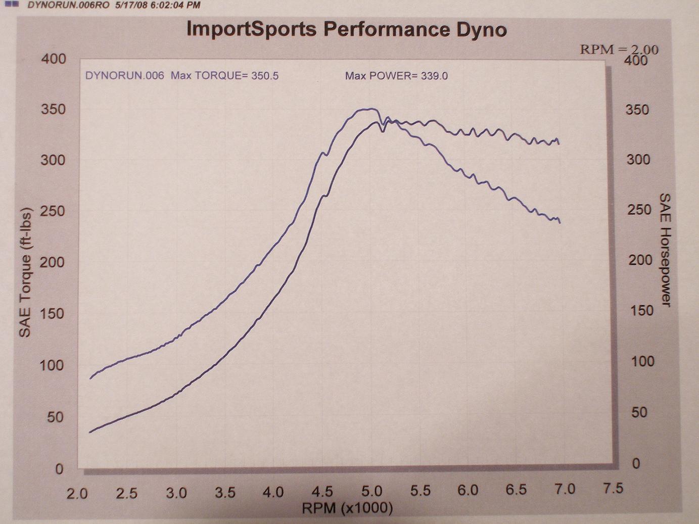

Here is the dyno sheet from the last pull. Numbers are a little lower than said, but my peak on previous pulls was higher numbers. Sorry it's kinda hard to see. I don't have a scanner so it's a digital picture of it. As far as what Steve set everything at, I haven't looked yet, I'm still just enjoying the drive. Next time I take my car out for a drive i'll log duty cycles and let you know where mine are at. Like Steve said my boost didn't hold untill redline (it would drop at about 5000-5500 rpm). Looks like it's time for a bigger turbo(well maybe).

i dont think ive ever seen a dyno chart that was so squigly after the peak..?
