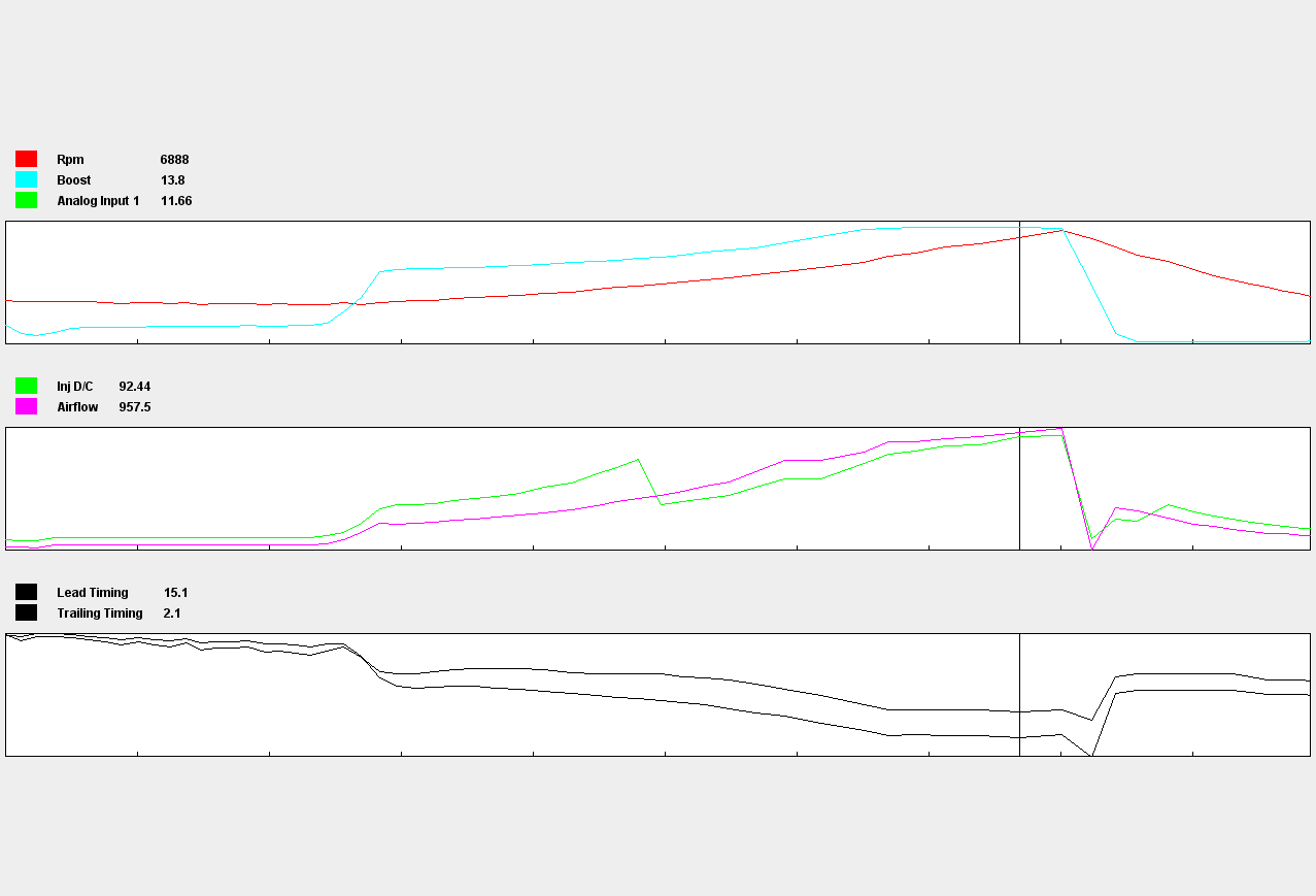

The correction for me at 14psi is 13.2+% 5120 rpm's and above. At 12psi its 8.2% at the same rpm's.
@ 6512 rpm the duty cycle is at 85%. Above 6888 rpm its in the 90's. So I'm about maxed out right now.

nice, your airflow is way higher than mine, i mine never gets above 700.. which may be why i run so lean. softer afm spring?

No I don't think so? Did they make different springs for the S4 cars? The AFM is stock.

Very nice graph, you have ample area under the curve and a pretty flat torque curve as well. I bet that thing feels like a beast on the road.
