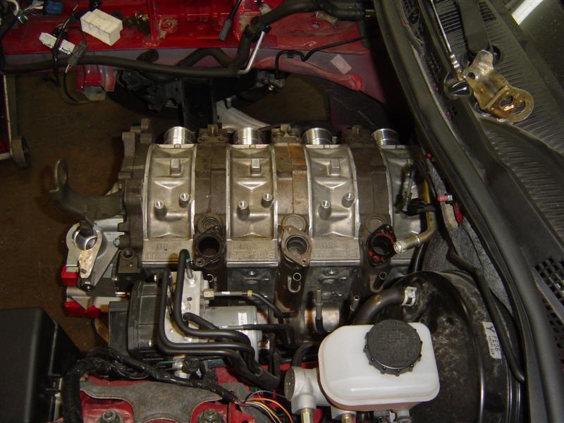

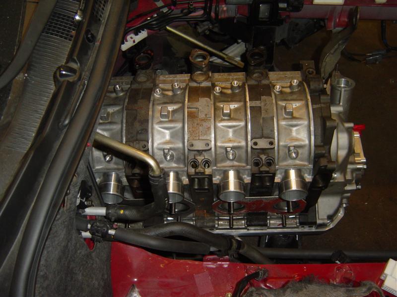

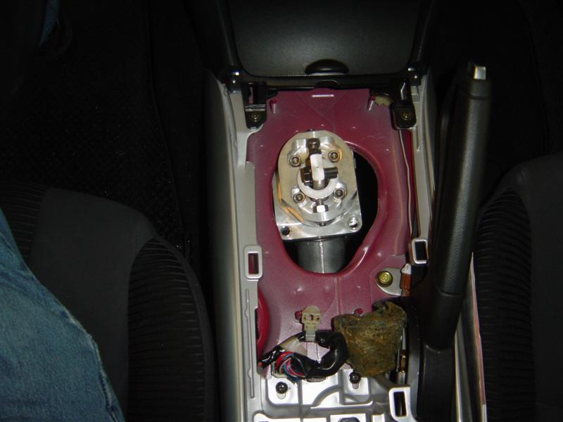

New pics
Here are the latest pics.
Name:	DSC06657 (Medium).JPG
ID:	287653   Click image for larger version
Name:	DSC06656 (Medium).JPG
ID:	287654   Click image for larger version
Name:	DSC06655 (Medium).JPG
ID:	287655   Click image for larger version
Name:	DSC06654 (Medium).JPG

WOW that thing is long.... how far back was the tranny moved? How was the balance on the scale? My engine is so far back that I had to install a filter relocation kit because the pedistal is right next to my gas pedal and the front cover lines up in the original position... Cool project, so where you gonna put that turbo?
It's only like 4-6 inches forward of the 13B. The stick is perfect in that position also. It's moved back pretty far. The rx-8 tunnel is very forgiving in that department not to mention being dry sump helps a great deal.
The trubo and the header is not that tricky. Now I have no clue where the downpipe is going to end up.
I say rear mount the turbo!!!
