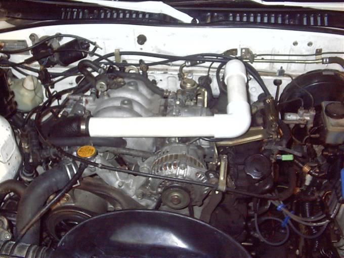

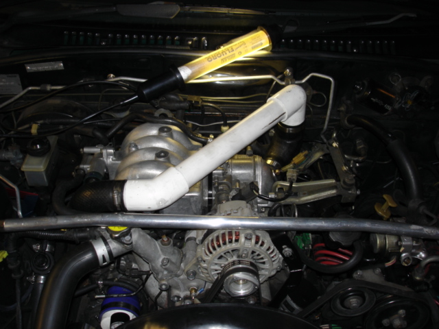

Here's a jpg of NZ's PVC pipe in lieu of the intercooler arrangement. Removal of the intercooler gives you access to the adjustment screws while the engine is running.
I'm making a lot of assumptions. I'm assuming there is no air leak. Like around a ACV blockoff plate etc. Big assumption.

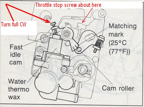

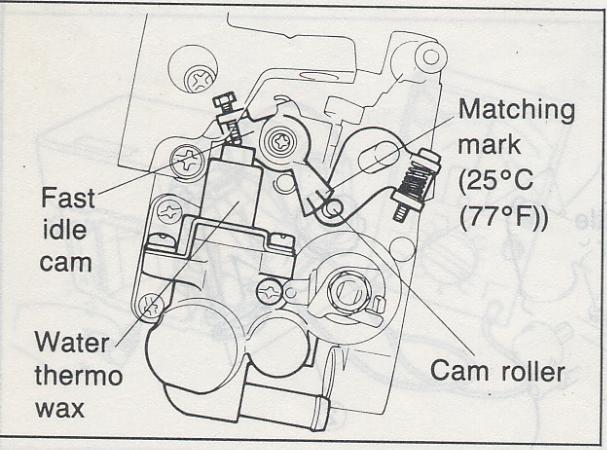

In the second thermowax pictue................turn that screw all the way clockwise. That should seperate the fast idle cam from the fixed pin, especially if the engine is full hot.
There is no clear picture of the throttle stop screw. It is about where I suggested in the jpg. IT is a small screw with a 8mm jamnut on it. When the engine is full hot there should be no light b/t the screw end and the throttle shaft stop. IF you see air, most likely the thermowax is holding the shaft open a touch.
Or before you start doing anything, stare at the throttle stop screw and the air gap and lift up on the screw that I have an arrow going to saying *TURN CW*, That act should lift the fast idle cam off the roll pin making the throttle plates close completly.
I'm assuming there is a touch of slack in the throttle cable also. Just a tash slack.

Turning that screw all the way cw is NOT the proper way to set a thermowax. That was just to confirm that is the thing causing the problem of a high idle. Later you can set it right per the FSM. You can fudge on the FSM to work in YOUR favor though.
