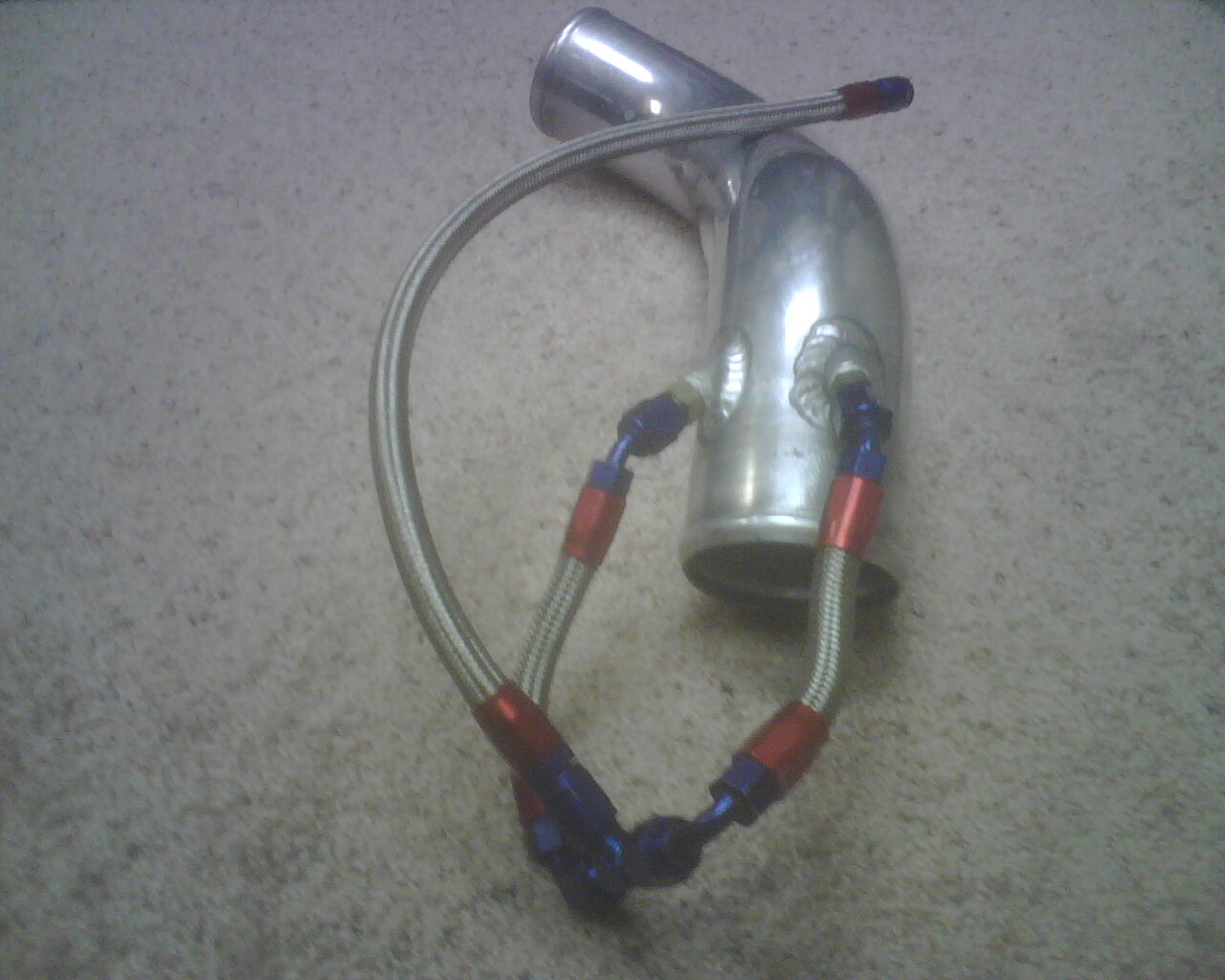

I am considering doing AI a little differently. I want to set it up like a separate fuel system. I would use 1 or 2 injectors that fire from the signal to the secondary injectors. Total injector impedence would need to be within ECU spec. Initial sizing would need to be close and fine tuning could be done with a pressure regulator. Has anyone done something like this yet? Anyone see anything wrong with this?

AI thru fuel injectors has been done. if you search a couple of the key forums...
Aquamist... though may be currently down is one of the best.
Turbobuick... 200 pages of threads
EFI101... amazing tech
i believe there is an injector degradation issue w straight methanol but can't say for sure.
as to running it off the secondary signal. i personally don't think that would work well. i run a Power FC Datalogit and looking at a graph of the primary secondary interaction it seems that the commands are all about overall duty cycle.
i do think the optimum setup would be to stage off duty cycle but no one seems to be able to grab hold of this calculation from the ecu and turn it into something workable.
i do think your general plan will be the type of AI system we will run in the near future. i considered something similar using some AQ components and finally decided that i had enough tech hurdles and i needed something that would just plug n play.

I suppose having the most important variable unadjustable is a little risky. Adding an auxiliary injector controller would give the ability to tune the system properly.

I have a GT35/40, 850cc/1600cc inj, twin RP fuel pumps, making 500hp on Race gas. I bought a setup that uses twin M3 nozels in the IC charge pipe with all hoses and fitting. All I need to buy is a pump, a relay, and maybe a level indicator. It sounds like the twin M3's will put me right under the 400cc per minute range right? I was planning on using Denatured Alcohol from Home Depot instead of Meth. Is there any reasons why I shouldn't go this route?
I also called Snow Performances tech support and he told me twin M3's would be way to small.....is that because they were thinking of using the Boost Juice 50/50 Water / Meth? Any help would be greaty appreciated as I'm sick of rolling around on the street with 14lbs of boost!

Here is a picture of the charge pipe I have....
