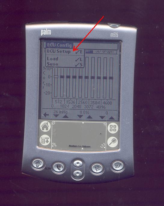

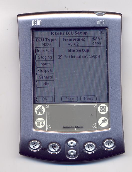

Originally Posted by rb240z71
Any update on the idle adjusting function?
I saw a prototype.
It has you go to TUNE....ECU SETUP......where it has several new selections that are: INJECTORS, STAGING, INPUTS, OUTPUTS, GENERAL, IDLE.
Hit the IDLE and then the screen also shows IDLE SETUP with a box to check called SET INITIAL SET COUPLER.
Hit NEXT and it will mention if you engine is warmed up or not. IF the engine is warmed up it'll say YES and you go to NEXT.
The next page tells you if the TPS is right or wrong. It should show 20percent on the screen. If not, then you adjust your TPS screw til it shows 20 percent. Once that is done hit NEXT.
On the next page will will say adjust the rpms to 750 and it has a display of the current rpms. Once you set the rpms to 750 it acknowledges that and you go to NEXT.
On that page it shows a slider for the voltage output of the Variable Resistor (the one in the enigne bay is now disfunctional). It tells you to slide the slider to to acheive the highest rpm. You slide that b/t voltages to acheive a proper idle.
ALSO, on the Fuel Bar graph they had the first bar from zero to 512 rpms instead of whatever it is now.

Hailers is beta testing the S4 NA. Things that he sees do not necessarily apply to the S4 TII.
As stated before, the N332 update will include the VarRes as analog in/software control of the VarRes.
RPM range has not changed in the N332 update, though there are 4 more points in between. (14 vs 10).
