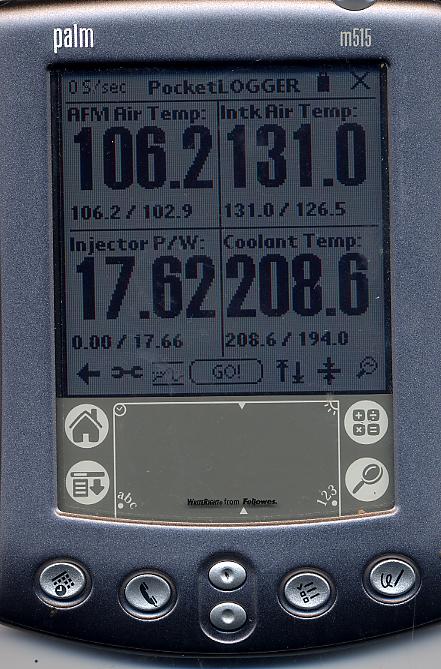

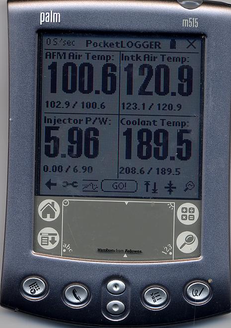

I know I'm butting in where I was not asked. But here are two jpg of the pulse width. One with the 3B connected and one with it disconnected. Quite a differene in pulse width. Fairly Hot engine as seen with the temps shown.

HAILERS is offline   Reply With Quote
butt away - more correct information is always good. The value fits well with the graph. In the case where 3B is disconnected, the ECU would just think the engine is running really slow. Fuel would be as a function of AFM, air temp, rpm, etc. as for normal running.
