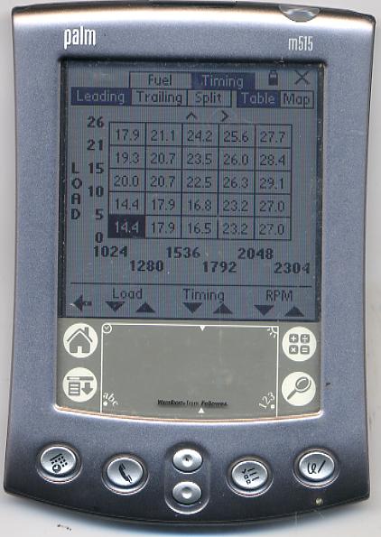

This is the stock settings. As you can see it is not all the settings. You have to use the arrows to move to the higher settings. And I have not fiddled with them.
They don't show below 1054 but you know that is stock timing 5 and 20.
Again I know zip about timing. Only what I've seen. Usually at a steady speed, say sixty or seventy mph the lead and trail will be almost together. Like 31 degrees advanved. Step on the pedal and the timing goes down in the teens. Like I said, I know zip about timing and what someone should advance/retard to.
Got a Zeitronix wideband with the Pocketlogger software yesterday to go with the Palm and installed it on my old 86, bone stock n/a for a look see. Seems to work just fine except I need to put it on one of the turbo cars.
The n/a has airpump/cats etc. The airpump is messing with the wideband readings. Reads in the 14.7 range at idle, which is a false reading because of the airpump. Pulled the blue relief solenoid connector and it drops to the real deal of 13.2afr. In other words its unusable on this car unless I disable the airpump which forces me to take the cat out so I don't ruin it. Blah, blah. Rambling Really don't wanna mess with the n/a car. Too many irons in the fire for me.

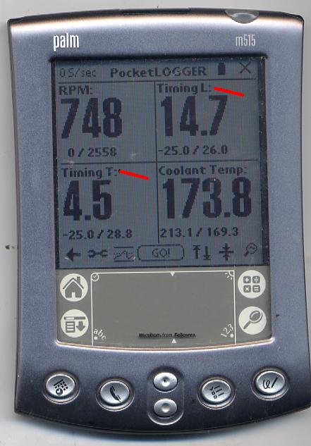

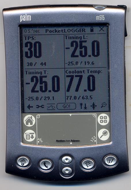

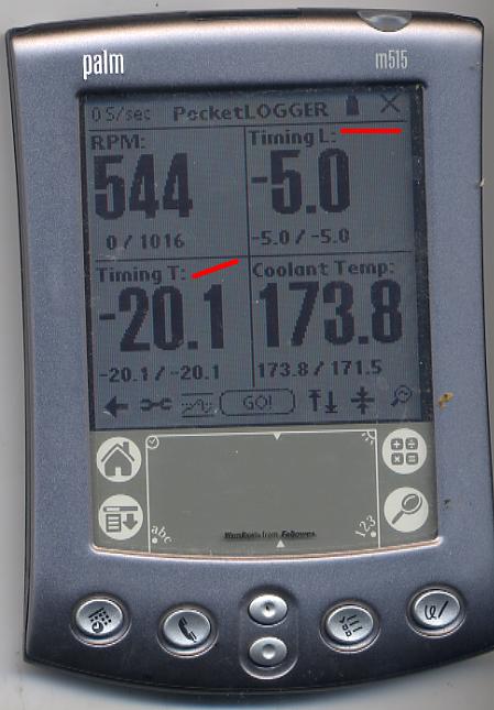

Here's what timing looks like with a cold engine. Factory retards the timing during start to minus 25 on both.
Second jpg is timing at idle and a really too low of an idle. I've fixed that idle deal.
The third jpg is only interesting in one respect. All I did, at idle, was turn the a/c on and walla, the timing advanced. I did not know or have a clue that the timing did this at idle when the a/c was turned on. Only happens at idle. Turn a/c on at speed and there is no change.
