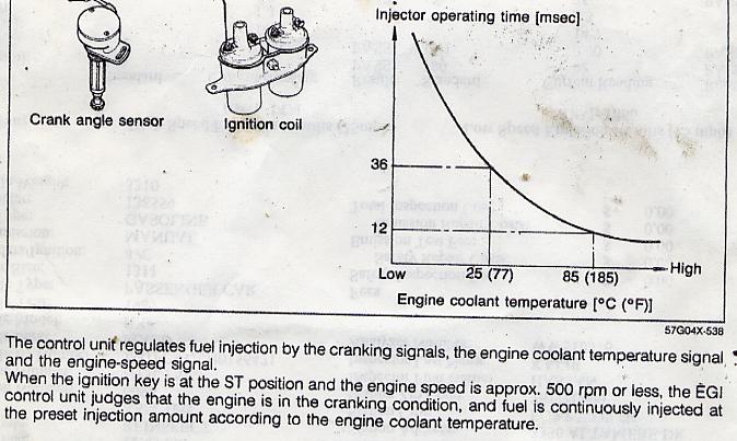

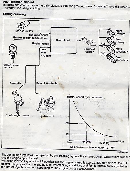

I kinda goofed. If one has a RTEK2.0 he can go to the diagnostic screen a view the START signal as he puts the key to START. If he sees a check next to START when the key is to START, then the signal is getting to the ECU.
IF someone does not have a 2.0, then he can just put a meter on pin 3B and look to see if 12vdc shows up as the key is put to START.
IF you have no START signal at the ECU, then the ECU will use the AFM signal for fuel during starting. That is NOT good. Normally the ECU uses a internal map that uses rpm, waterthermo sensor signal and the 12vdc showning up on pin 3B during STARTING.
If the ECU is using the afm for fuel duing starting, it'll be too lean a mixture, especially with a cold engine. BUt with a very hot engine, it might actually help to not have that Start signal on pin 3B.
Takes but moments to check out with a meter. Beats wondering day and night about it and getting nowhere.
