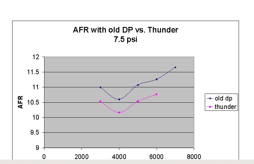

I started rich to be safe and was suprized on how well the car ran. Seems rotaries will run ~10.3 or so. I had to fix a lot of stuff on the old car to get enough fuel. I have made a lot of logs and have a big data set to study. After I changed my original downpipe and midpipe with a one piece thunderpipe I noticed that my "dyno runs up a hill" were ~0.5 ratio richer than before. Nothing else was changed. I found that my original setup was leaking air and making the WB read leaner that it really was. Note the graph of AFR with both pipes. I learned not to just trust wbo readings blindly. Glad It was an error in the safe direction.

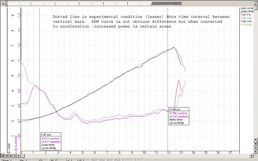

I leaned the region between 6-10 psi and 2000-6500. I was shooting for max flame speed that happens around 11.1
After several back to back runs up the hill I can overlay the two logs. The dotted line is the leaner setup and it is easy to see that with the leaner mixture I get to 6730 rpm in 11.88 sec whereas the richer set up only gets to 6650 rpm in the same time. (this was not pl viewer). I have a track event next week so I will be able to tell more then, This is just the average improvment and I really want to know where in the power band the improvment is.
By doing a bunch of calculations, I an turn RPM into ft/sec and then by math convert that to accelaration. Knowing the weight of the car and acceleration I can estimate torque. This map gives me more torgue between 2500-5000 just where I want it. To really do this right I need an accelerometer. But for now the estimates seems to work OK.
