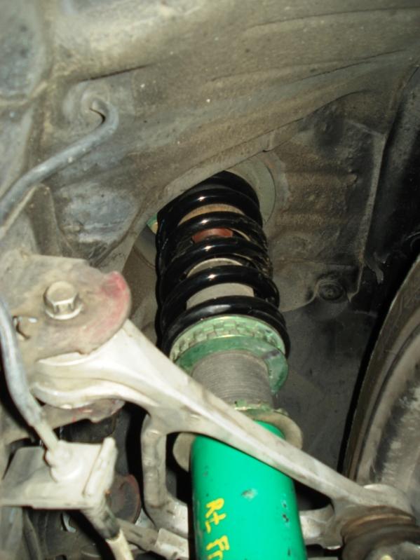

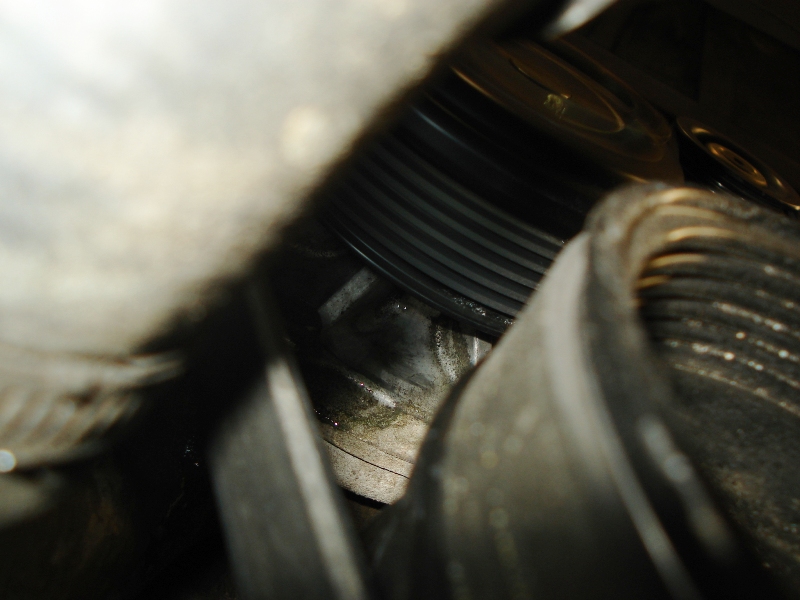

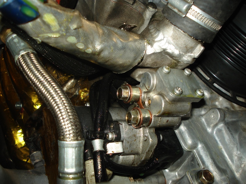

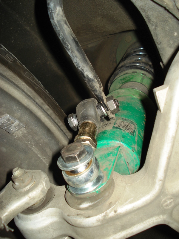

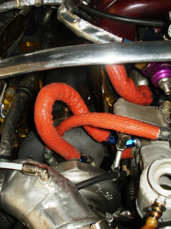

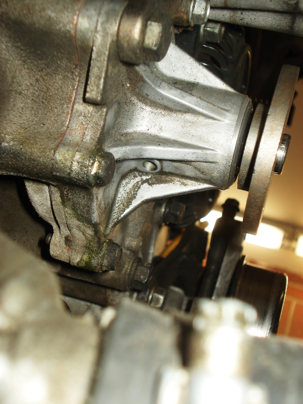

Well, I sprung a few leaks this last weekend. The Mazmart pump seal is going away and is dribbling coolant. Already in the process of getting a new one. Also was leaking at the turbo coolant outlet line. It was just too short to maintain a seal so I made a longer loop, just need to shorten it a little. Also it was leaking at the filler cap of all places, so I replaced it.
I also finally got my 12Kg springs that was on back order from Tein. Put them on the front, as well as put my .120 front bar in, man what a difference should have done this awhile ago. I moved the 10kg springs to the back, but the rear wants to step out sooner, may revert back to the 8 Kg springs. I also put on my new rear swaybar end links finally.
Also need to replace my leaking oil injector lines with some custom SS braided units I will be making.
Peace
Hey Adam,
You might want to check your bars etc. RE-Amemiya recommended to me 12/10kg and stock bars, but that was with their dampers and 265s, different stuff.
Where did you get the rear end-links? I've been wanting some to match my fronts for awhile, don't trust that plastic.
Where you running SS lines before?
Also mind if I steal some of your cool little ideas like the electrical switch in the bumper, etc haha? I've had some cool ones like that too I can share but don't really have a build thread yet, just a garage list.
