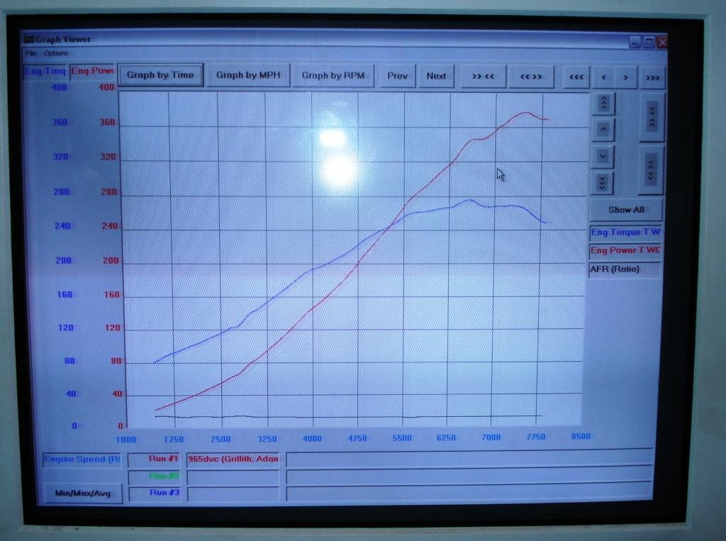

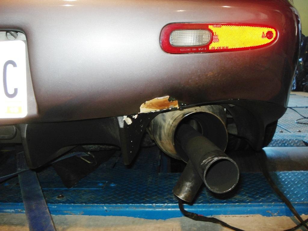

Well, it was a productive dyno session, but ran out of time to finish the initial tuning. Most of the time was spent playing with the Synapse WG settings to get it to achieve the desired boost. We got it, but I still need to play around some more. Wasn't able to touch any of the Chuck Westbrook's base timing maps. Once I start playing with the timing I should get a lot more power, as it is the timing is super conserviative, which isn't a bad thing. Was able to achieve 373whp and 268 ft-lbs torgue at 15 psi. Had a few hiccups while on the dyno; I melted one of the straps and melted the paint off the bumper. Fortunately Haiphem caught the strap before we did another run, which would have been really bad. And the melted bumper was from the exhaust tube that was put on. The bumper and the exhaust tube melted. Will fix the bumper later, right now I have some heat shielding on to prevent further damage. I will post video later.
And it wasn't IPD, it was another shop IPD contracts work out to, that has a Mustang Dyno. I will get the full details on these guys later. Haiphem is going to Cali this week so the next dyno session will be Monday/Tuesday of next week. This current tune should be good for Packwood this weekend.
Peace

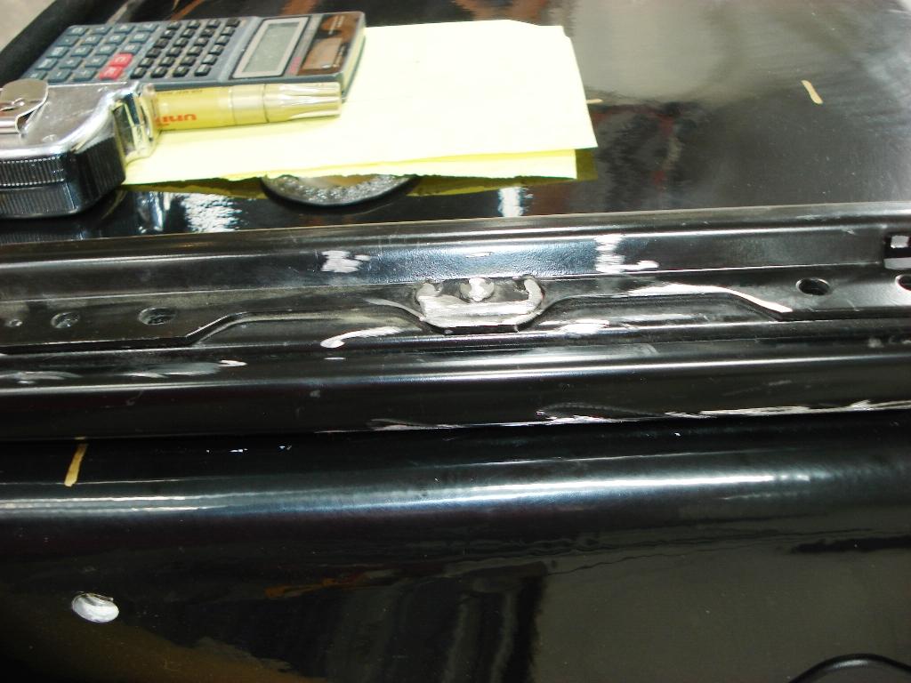

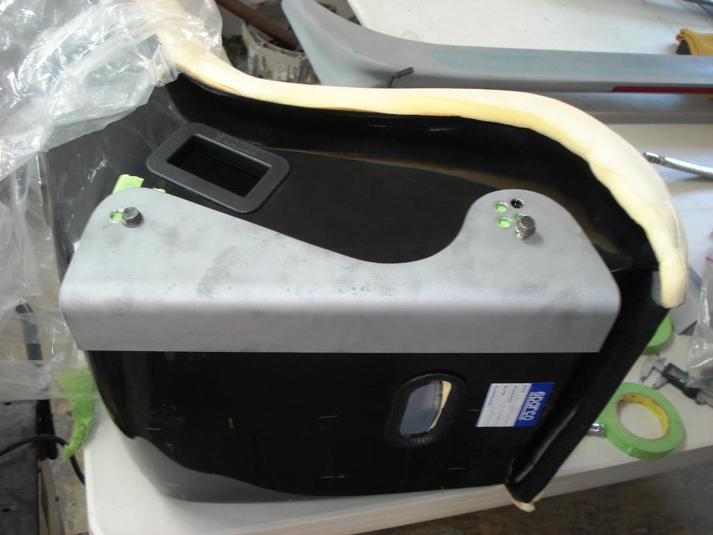

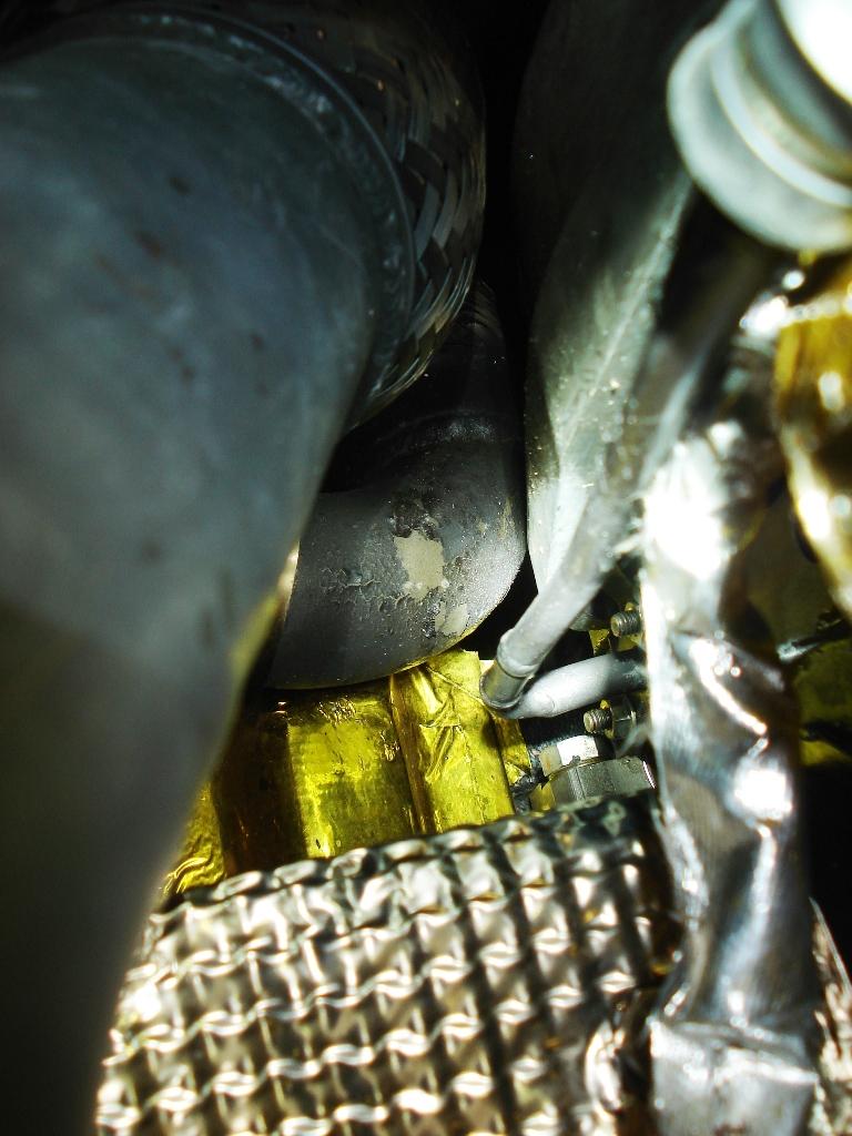

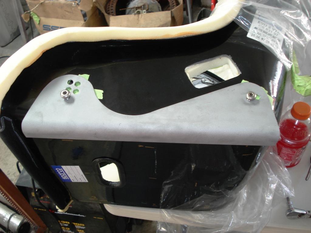

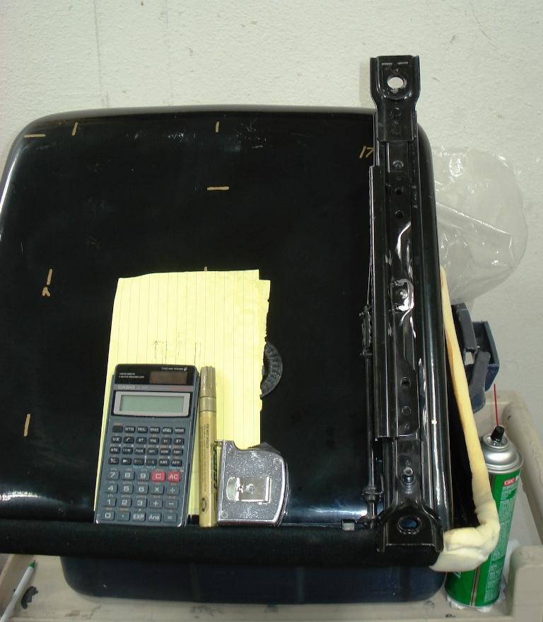

Well, finding a few little things that need fixing. The big one is one of the -10AN oil fittings on the drive oil cooler is leaking. Will need to replace that. I was able to get an air filter on the TB BOV and fixed a few little issue with vacuum lines. I have now offically killed two EGT probes with less than a thousand miles on them. I'm seriously thinking of going to the SPA dual egt unit now.
Started working on the seats last night and I will be forming up some side mount plates and then weld them to some modified stock rails. The Seat buckle tab and bar had to be removed, but I have a fix for that, the only potential problem is it won't work for a short driver.

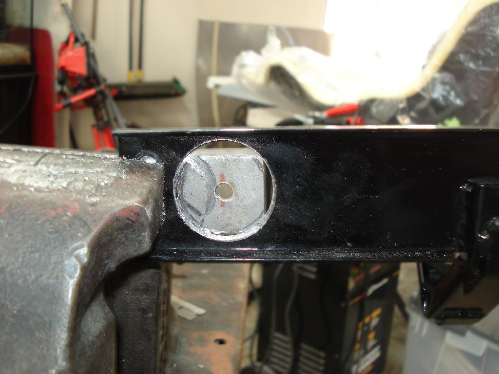

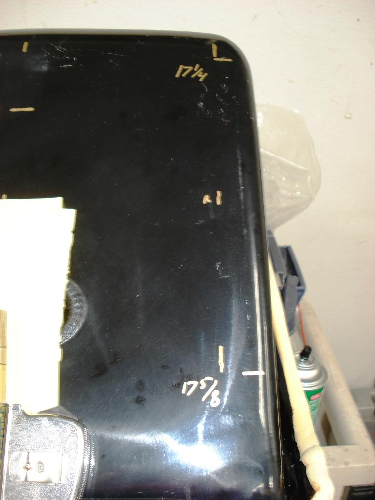

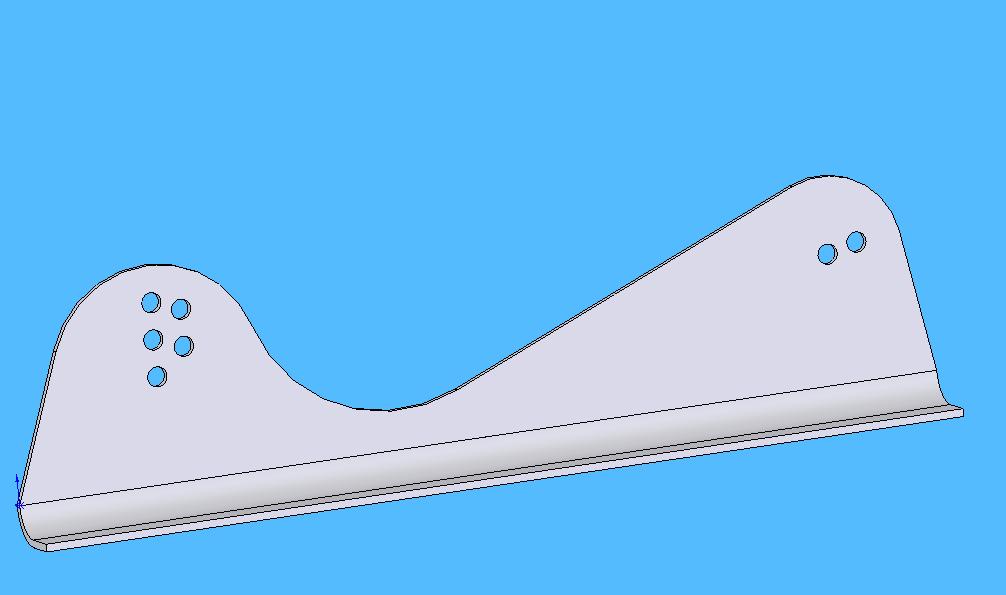

Side Mount Brackets design, just need to make them out of 50ksi steel plate and weld them on after fit up and Modification of seat.
Name:	Side mount Bracket.JPG

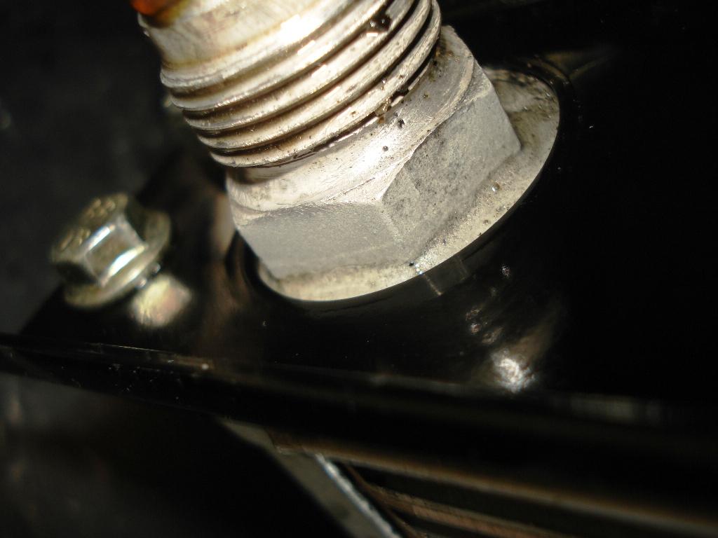

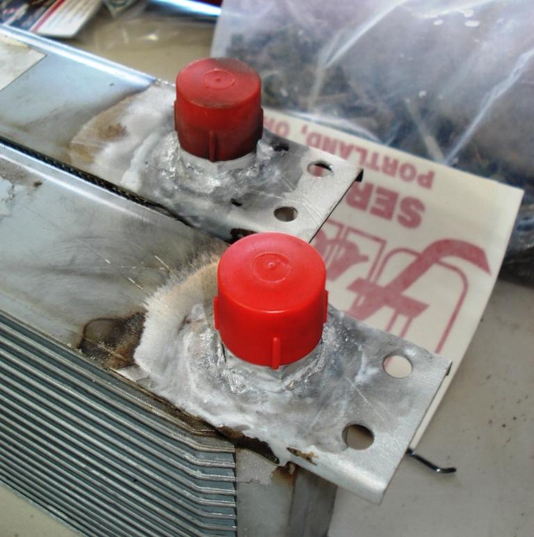

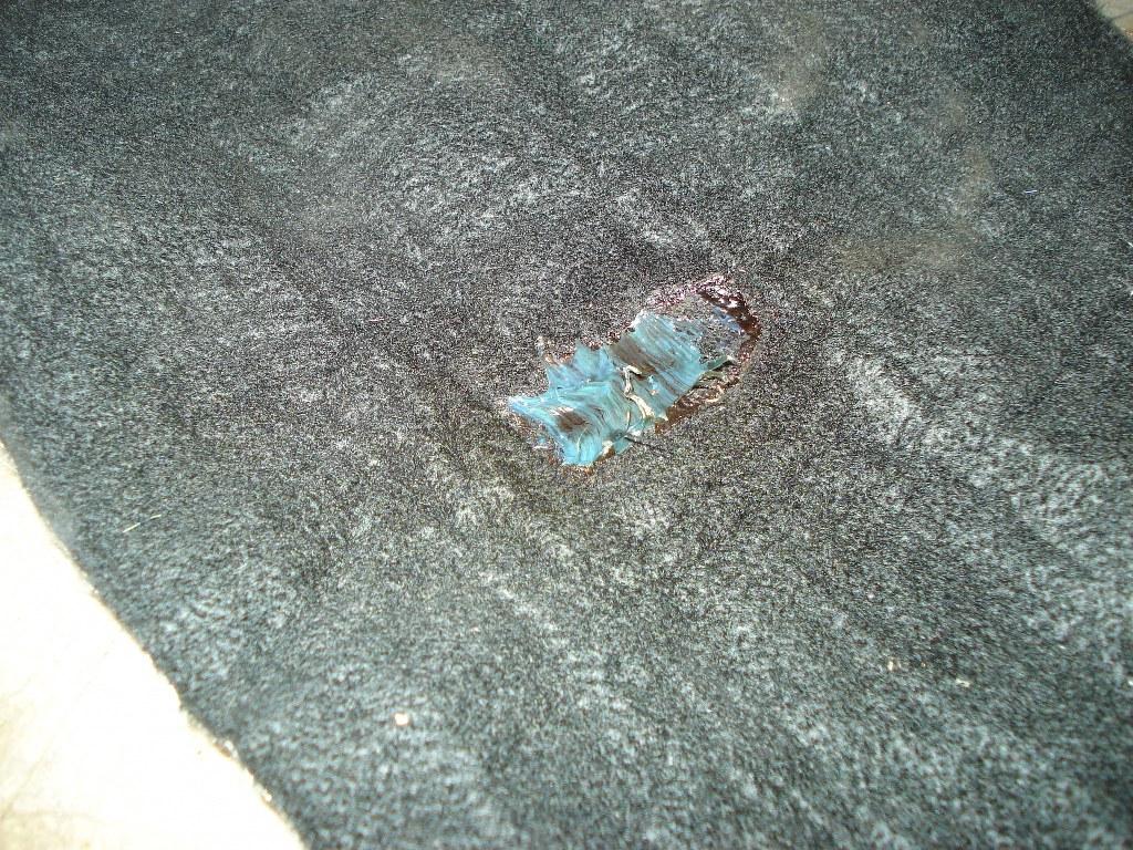

Found my oil leak, my Mocal oil cooler sprung a leak at the fitting. These things are rather fragile, that's two oil coolers now that started leaking at the attachment fitting. Anyways, got them fixed and also made the seat brackets. Tonight is going to be a late one for tomorrows AutoX.

damn, looks like you're off to the moon with all that foil !
That is the most high tech FD engine bay I have seen. Almost looks like you stuffed a satellite under your hood. lol
your engine bay is so crazy with the gold, it's like strait out of star wars.
