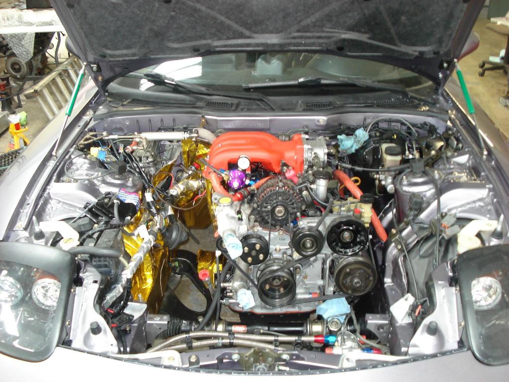

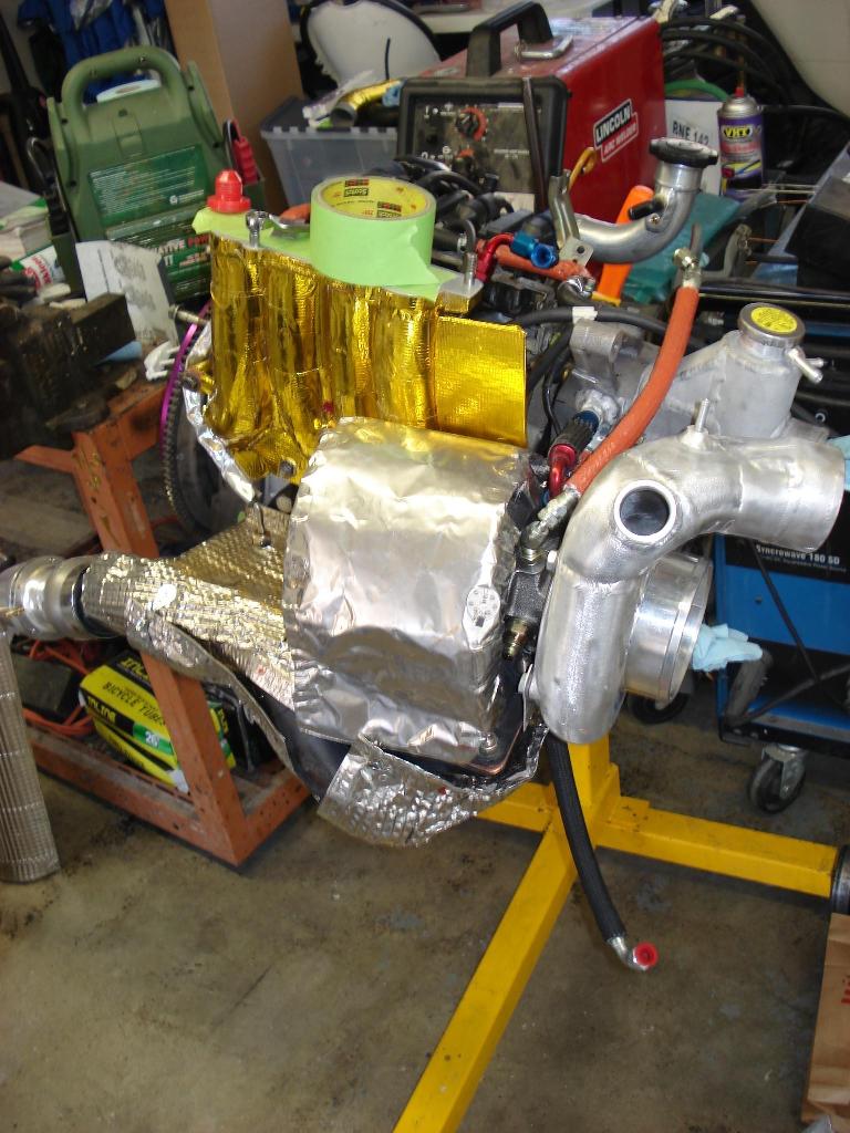

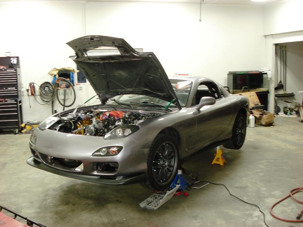

The motor is finally in. Had a few hang ups, but they're squared away.
ID:	303165   Click image for larger version
ID:	303166   Click image for larger version
ID:	303167   Click image for larger version
ID:	303168   Click image for larger version

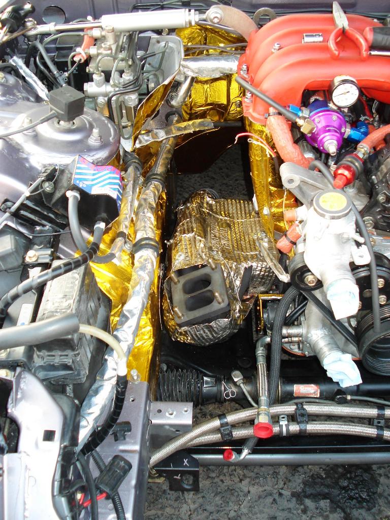

Pyrosleeve, nice touch. I have some of that on my car.

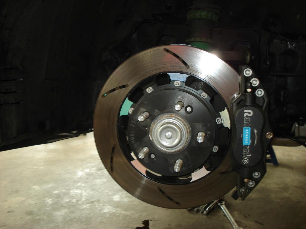

More info on the brake setup? They look like full floating discs.

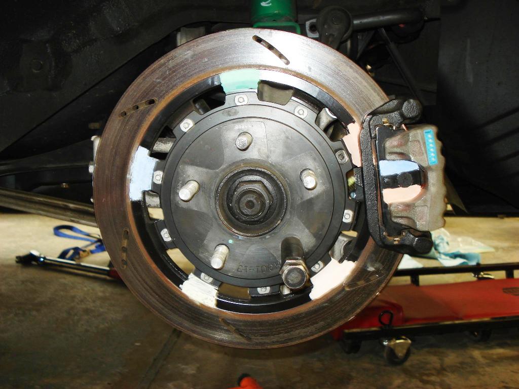

Racing Brake BBK Kit and yes they are fully floating rotors front and rear. I had Rafik my helper put thermal paint on the rotors and pads, as well as put thermal temp strips on the calipers. I got in on this kit during the GB stages when it first came out.

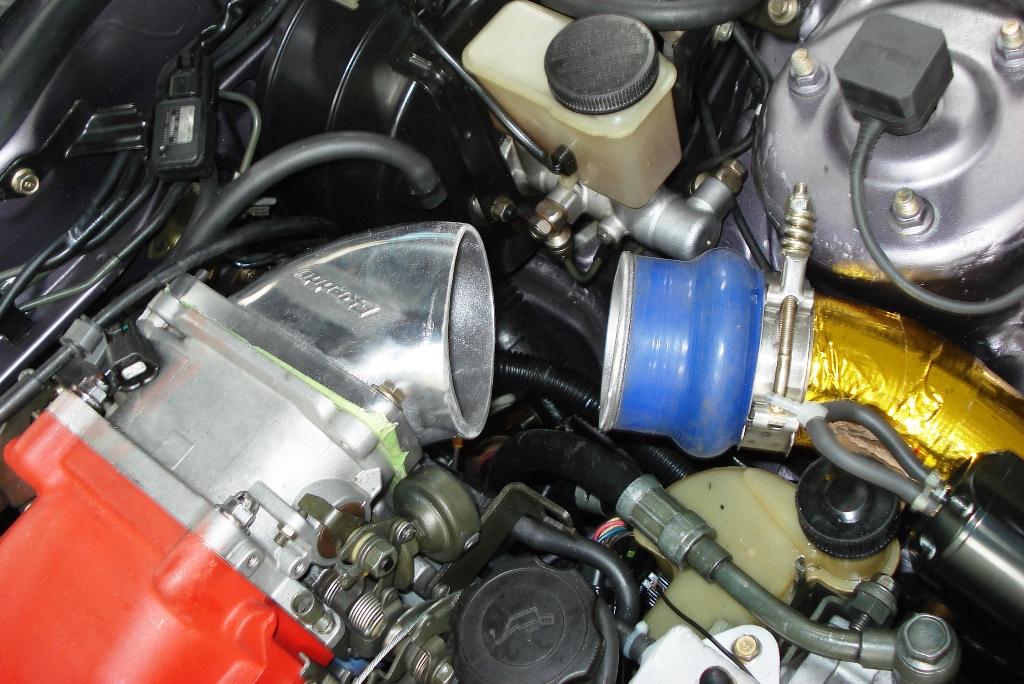

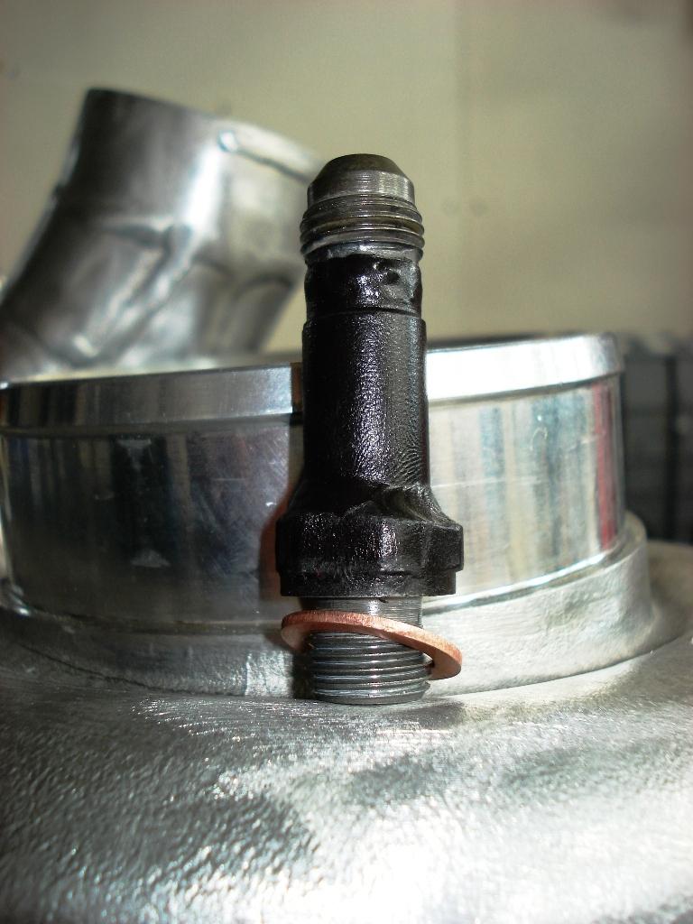

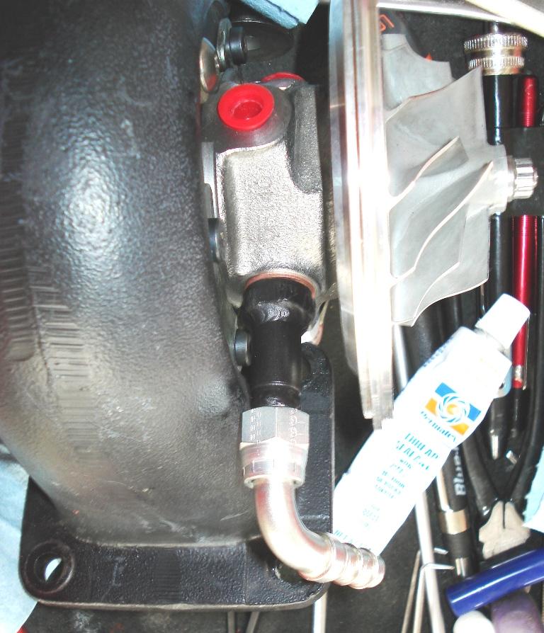

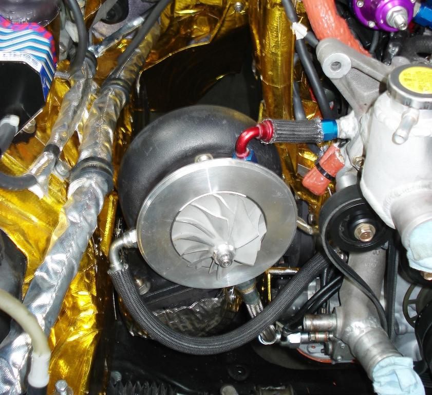

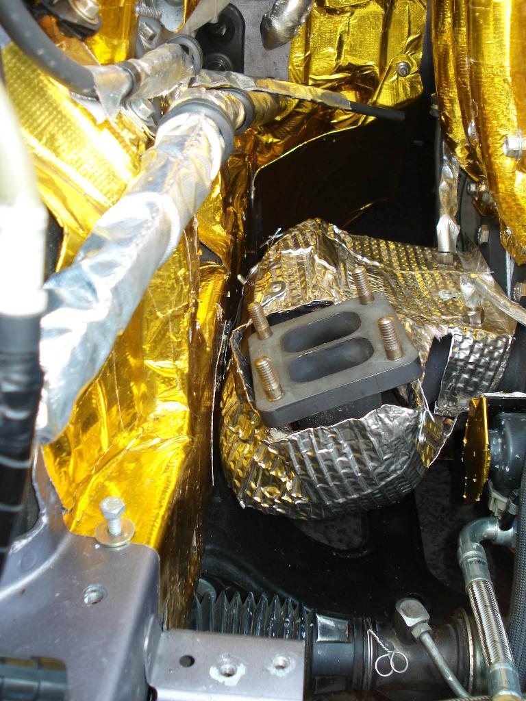

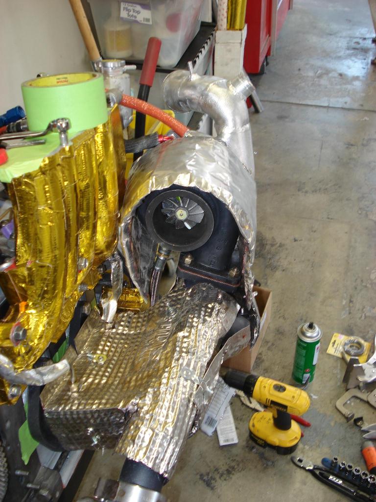

Alright, I got my gaskets in and I broke down and made a water inlet fitting. I took Barry Bordes advise and lapped the mounting face of the turbine as well. Tomorrow I will be going to oil filter supply and see if I can get a oil inlet fitting. Also, oil catch tank version 2.0 is made, just need to relocate the breather filter tomorrow and it will be done.
Happy Fourth of July everybody.
[/quote]
[/quote]
[/quote]
[/quote]
[/quote]
[/quote]

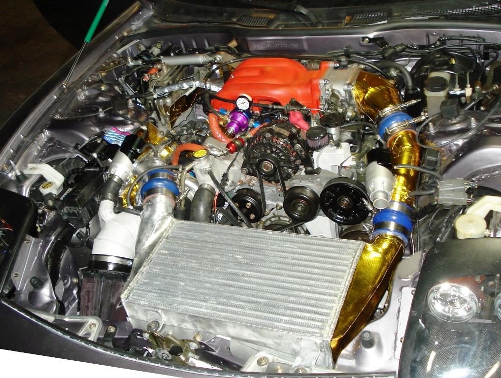

ID:	303989   Click image for larger version
ID:	303990   Click image for larger version
ID:	303991   Click image for larger version
ID:	303992   Click image for larger version

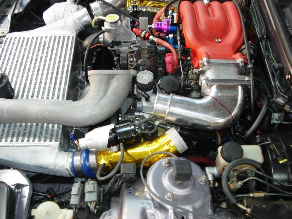

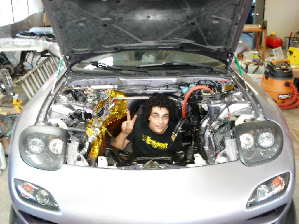

damn, looks like you're off to the moon with all that foil !
That is the most high tech FD engine bay I have seen. Almost looks like you stuffed a satellite under your hood. lol
your engine bay is so crazy with the gold, it's like strait out of star wars.

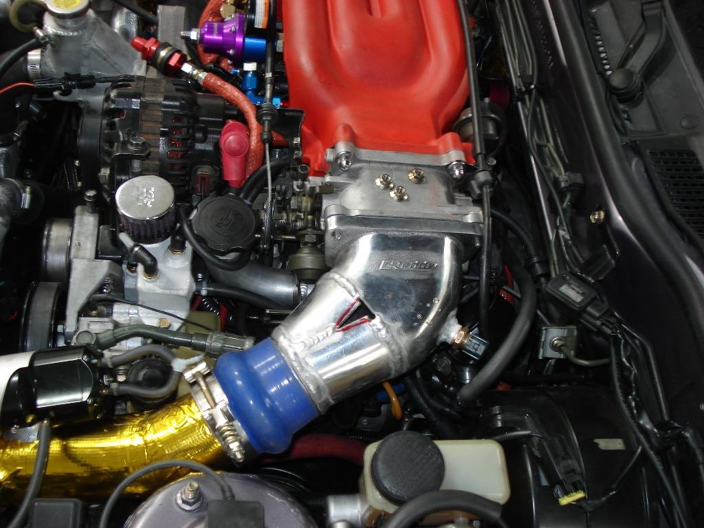

ID:	303995   Click image for larger version
ID:	303996   Click image for larger version
ID:	303997   Click image for larger version

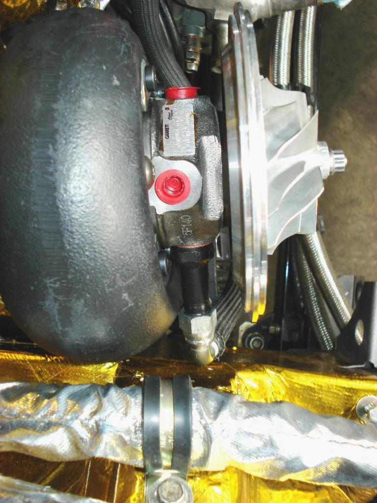

Well oil filter supply wasn't open, so maybe Monday for the oil inlet fitting.

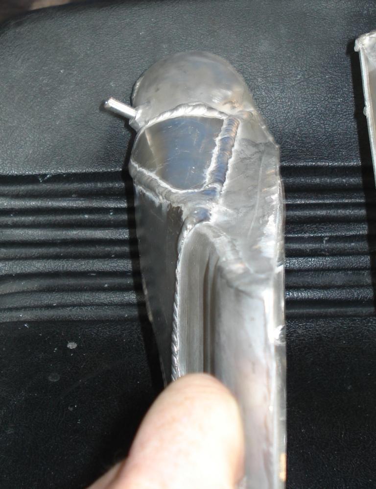

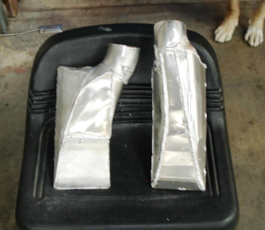

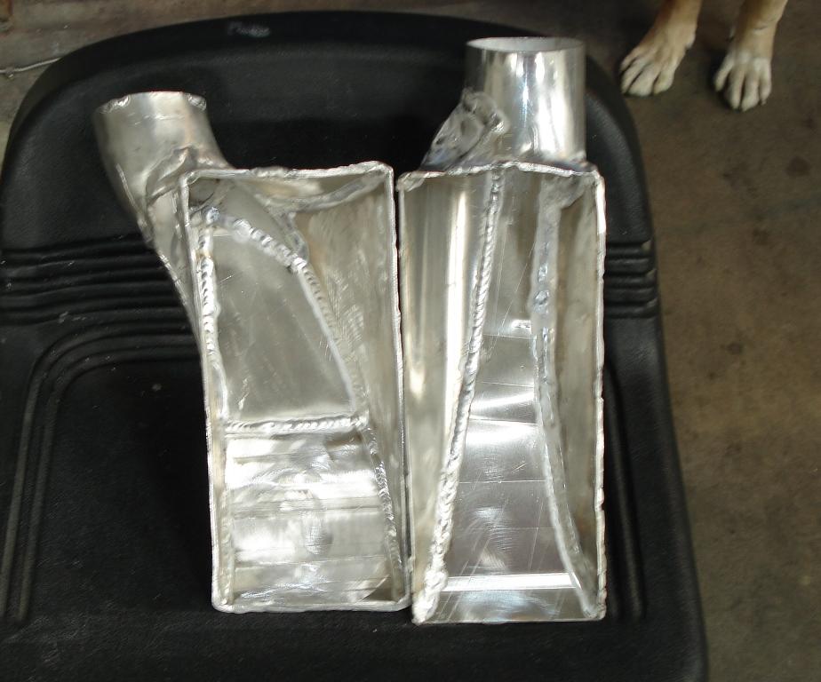

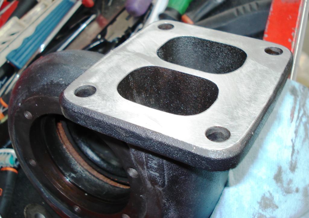

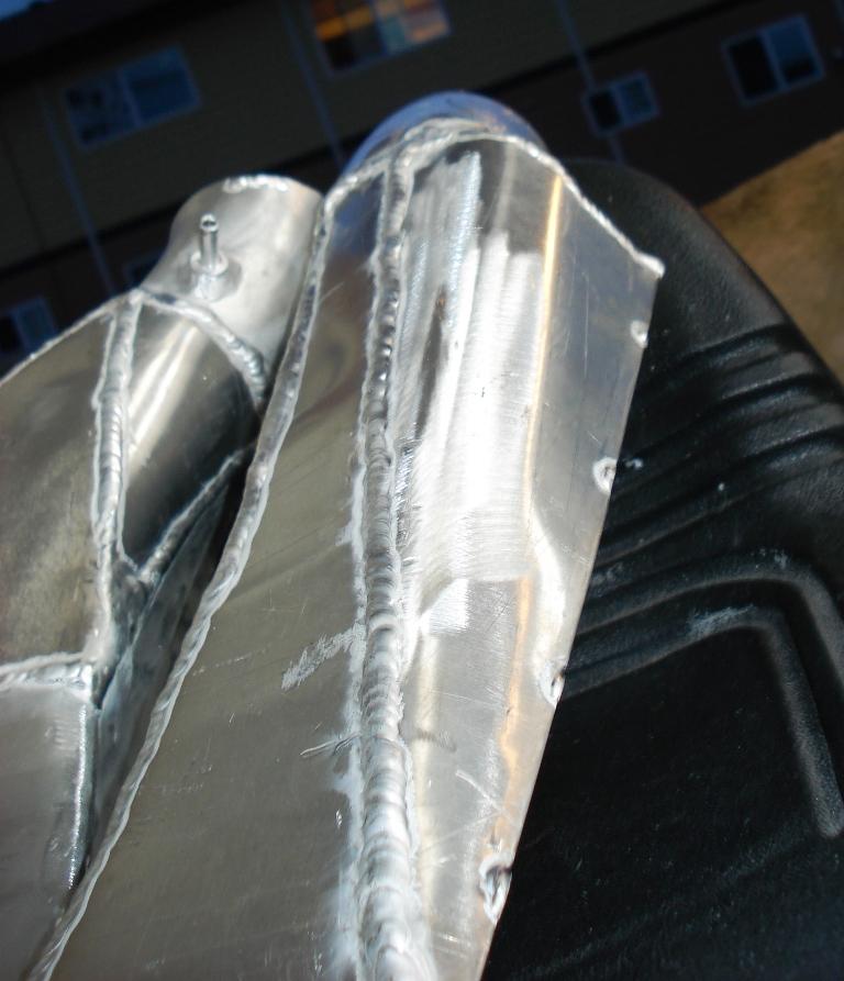

Anyways, IC end tanks version 2.0 made. Just need to grind, port AND POLISH before welding them on to the IC. The oil catch tank is done.

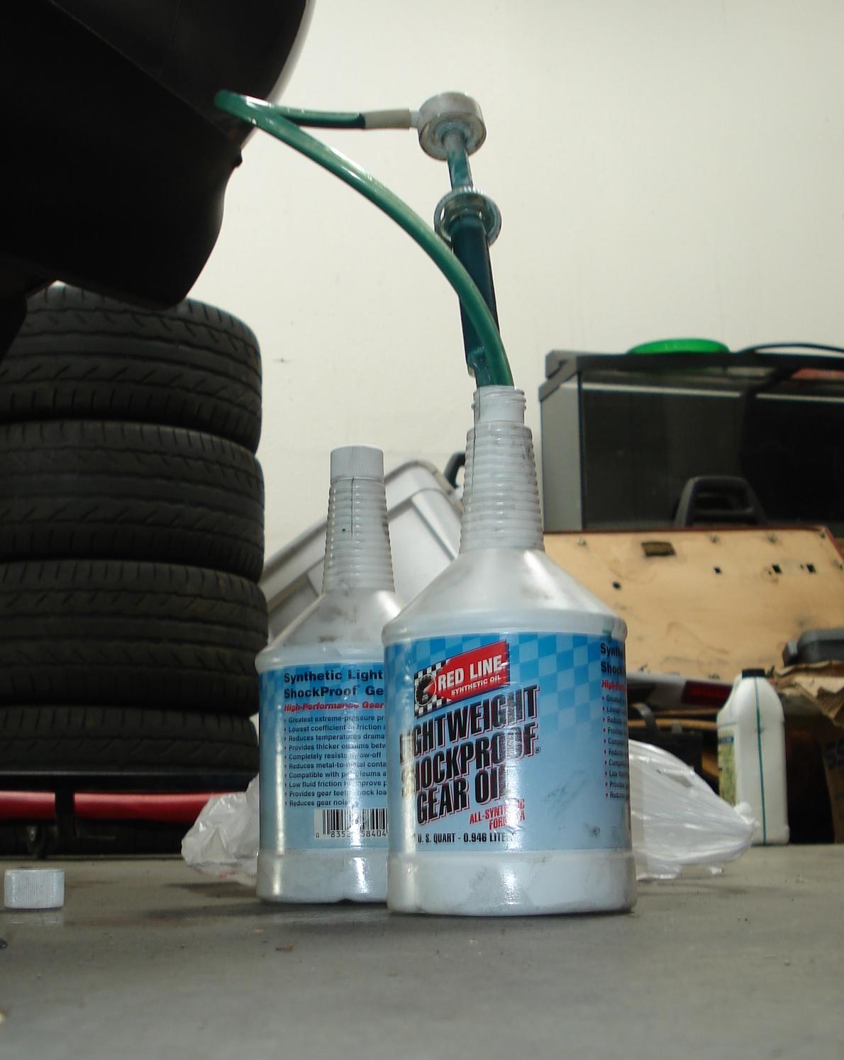

Started adding fluids. I used the good shyte.
Peace

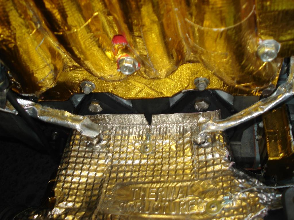

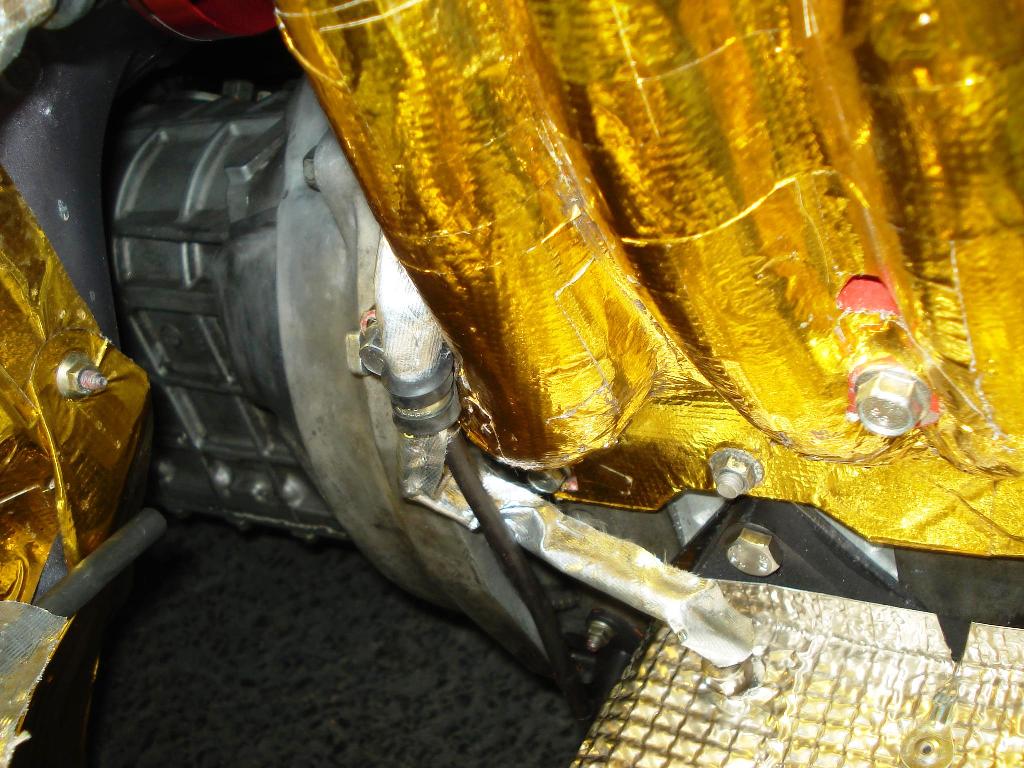

The gold stuff from: http://www.pegasusautoracing.com/gro...ID=HEATBARRIER

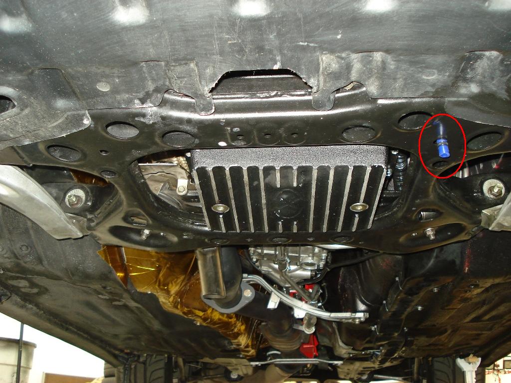

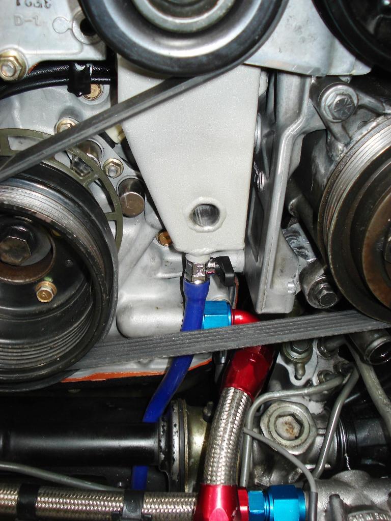

Exhaust heat shielding, well, I got it from work. They were used on a test and then put in long term storage. The guy who did the testing said I could take whatever I needed.

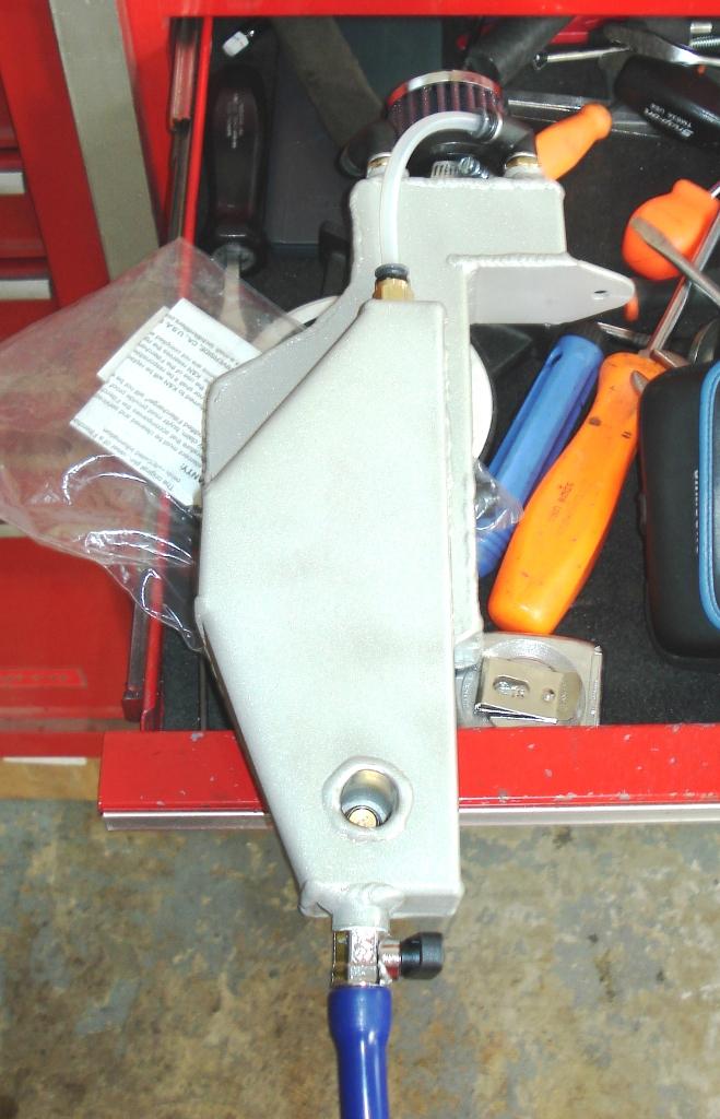

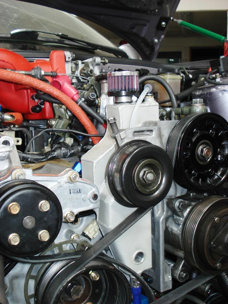

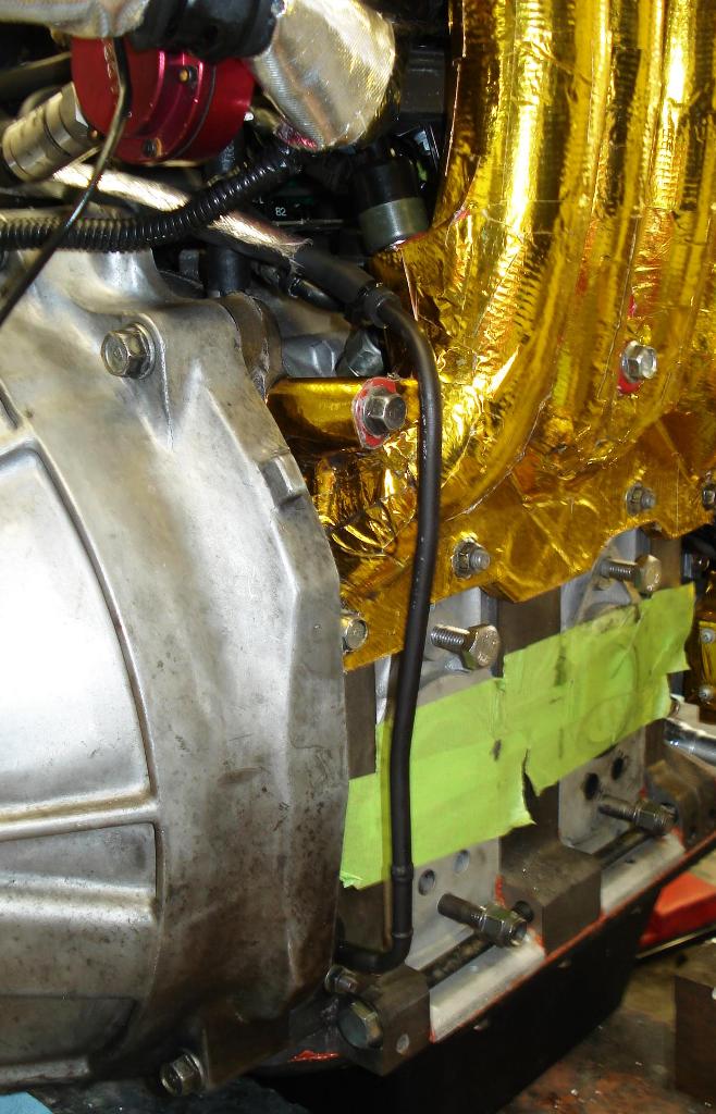

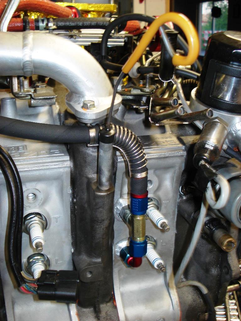

See attached if any one was wondering where the oil catch tank drain line went under the car.

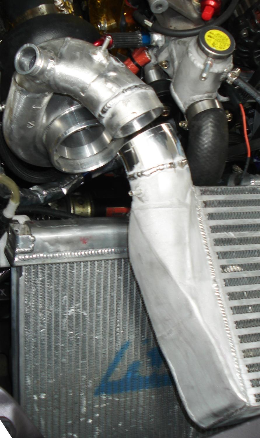

IC endtank were ported and polished(internally), welded on IC core and found I needed to tweak a few things . TB elbow next.

Ordered an oil inlet fitting from Horsepower Freakz! It should be at Apex by tomorrow. Yes!

Now you need some Wiggins clamps for that piping. Are you planning to sand and polish the new endtanks, remove the exterior welds?
Warning:Objects in mirrors may disappear rapidly.
RX72NR is offline   Reply With Quote
Old 07-09-08, 12:49 PM   #822
afgmoto1978
Location: Portland, Oregon
Posts: 2,504

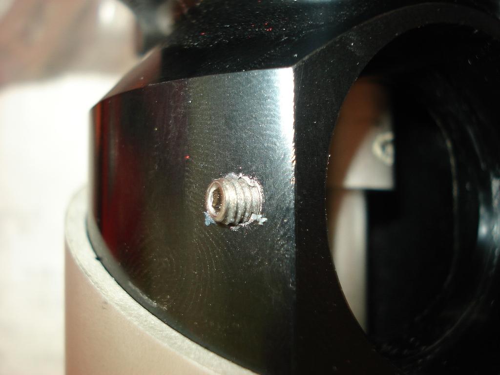

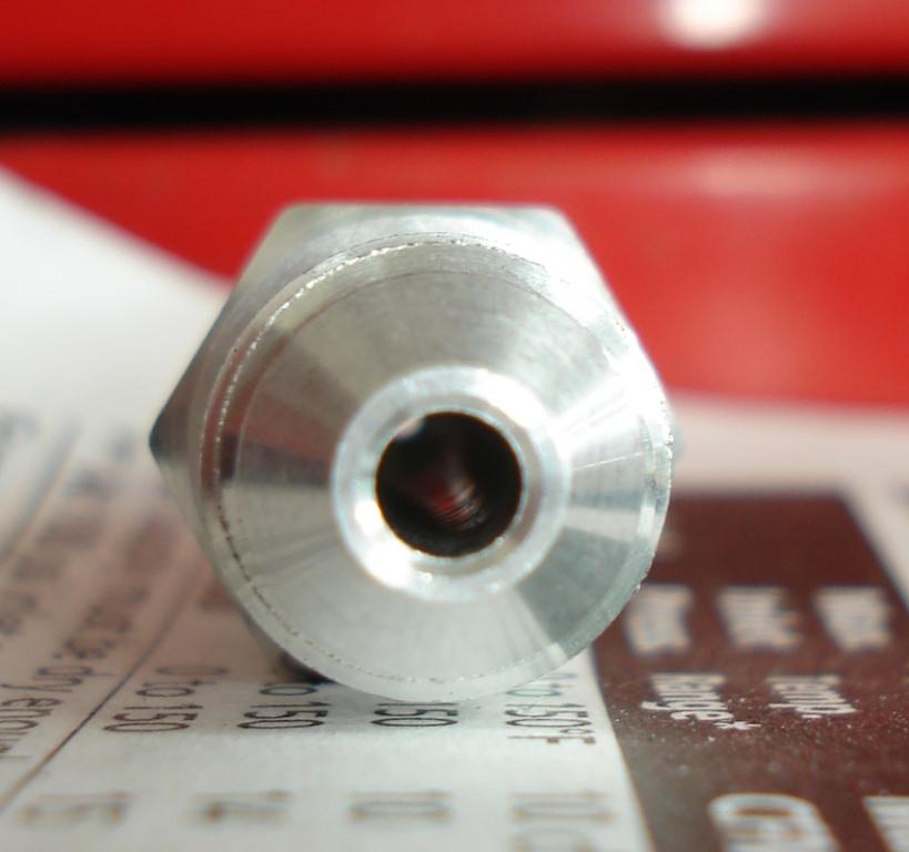

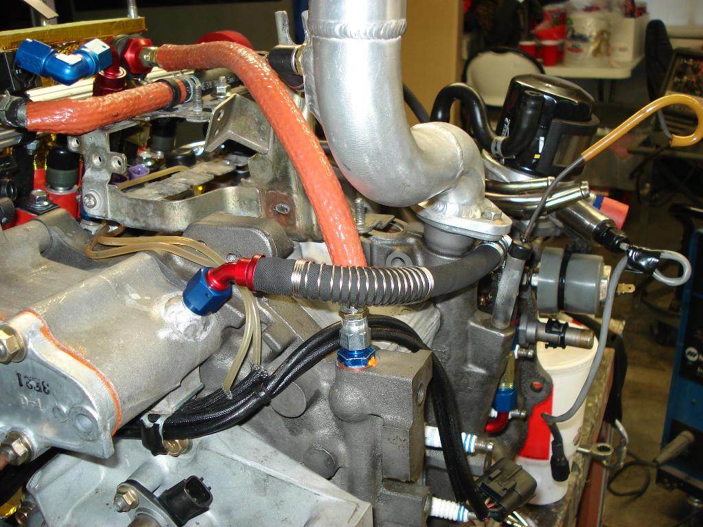

Wiggins clamps are cool items, but goddamn are they expensive! Maybe....
The insides of endtanks are ported and polished smooth. The exterior welds are ground down a little, but not all the way. I'm not a big fan of polished aluminum, don't ask me why. I'm going to brush finish them so they have a satin raw finish. The IC outlet tank will be covered in gold foil. Same thing with the new TB elbow I'm making.
Almost done with the TB elbow, just need to make triangular plates to fill the holes. Then porting and polishing of the insides and wrapping it with gold foil.

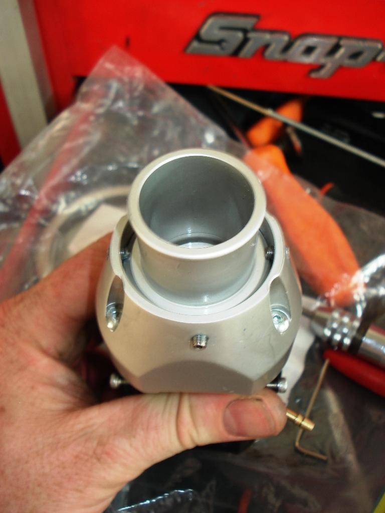

I also made some mods to the Synapse BOVs mounting setup. The set screws that came with the kit are M3 unit and getting a Allen head tool in and tightening it is a bitch, so I put M4 set screws in place. I also put two more set screws on the recirc fitting mounting. The K&N filter I had attached to it was causing the recirc fitting to get crocked.

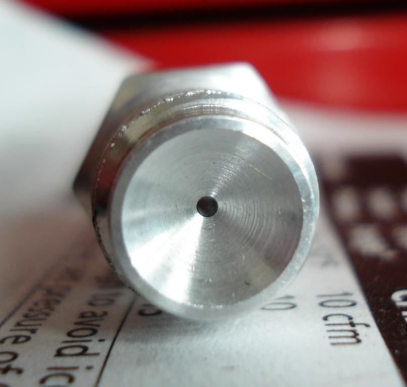

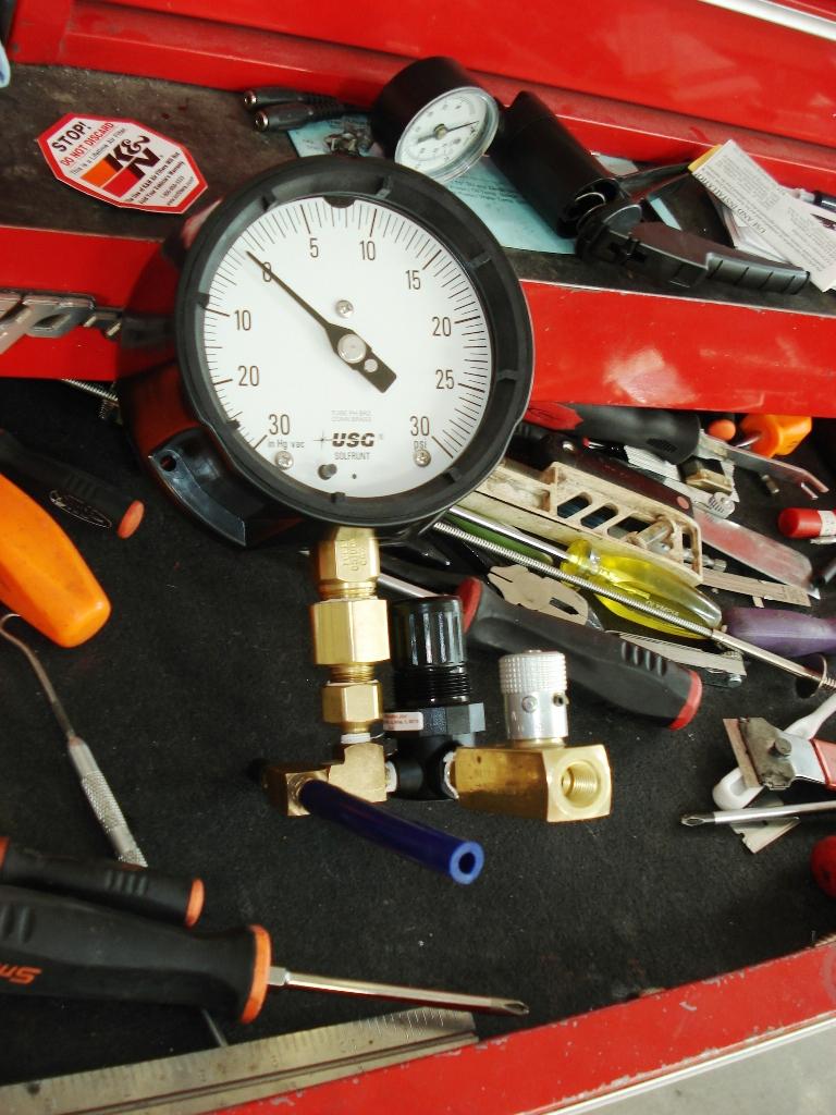

In anticipation of putting a 3 bar GM MAP sensor in place I built myself a little calibration tool. The gauge is huge, but it was the only one that had the accuracy I wanted and not cost $100+, the one I really wanted was $860.

Hey Adam, I have a media packet from KRONTEC if you want to look @ their "wiggins" clamps.
let me know if you want to take a look.
Great pics!

IT LIVES!
http://videos.streetfire.net/video/I...lly_170746.htm
I got my oil inlet fitting, best $63 dollars I've spent in ahwile.
So I drove it home last night, had a small localized fire inside the heat shielding of the Headers, no big D. Maybe debris or the fiberglass strands caught on fire. Drove it to work today with no issues.
Just have one small leak at one of the earl fittings on the steering system. Too tight of a bend for the steel braided line maybe....
Registration, 3 Bar MAP and a few other things today.
Peace
