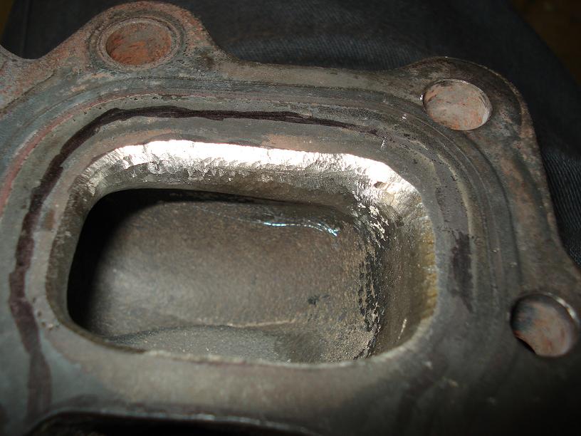

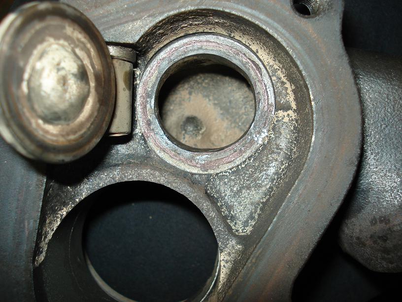

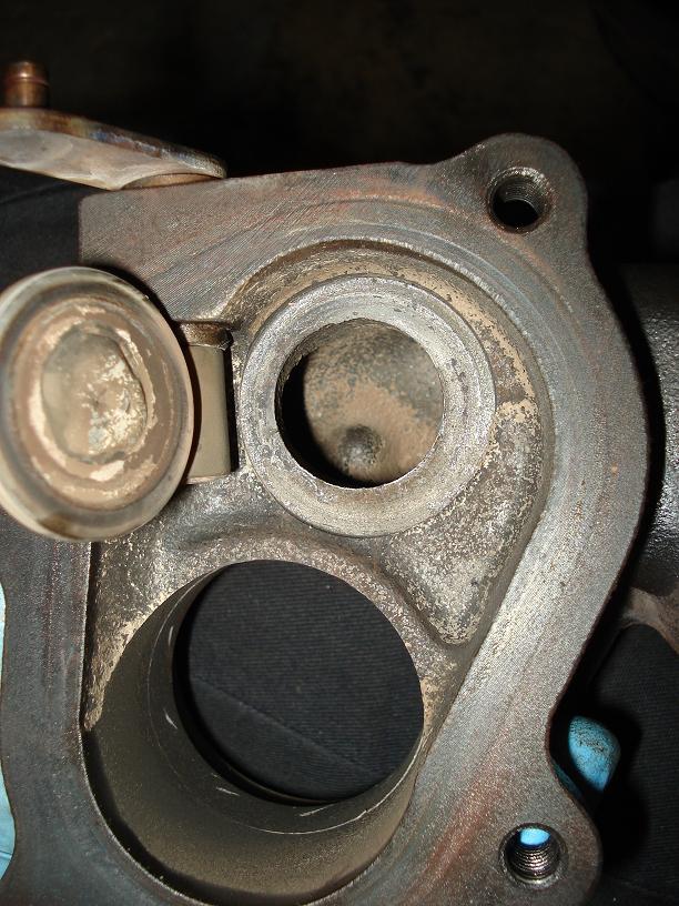

AOC007 have you ported your wastegate opening?
ID:	268503   Click image for larger version

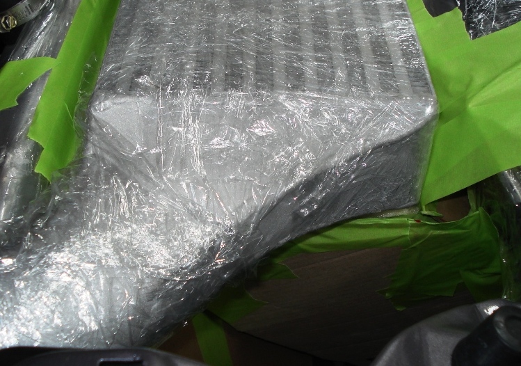

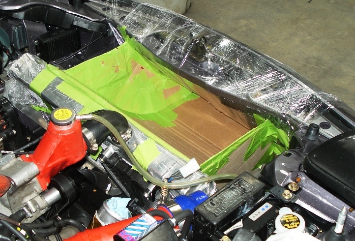

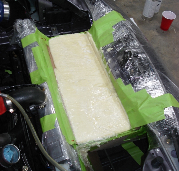

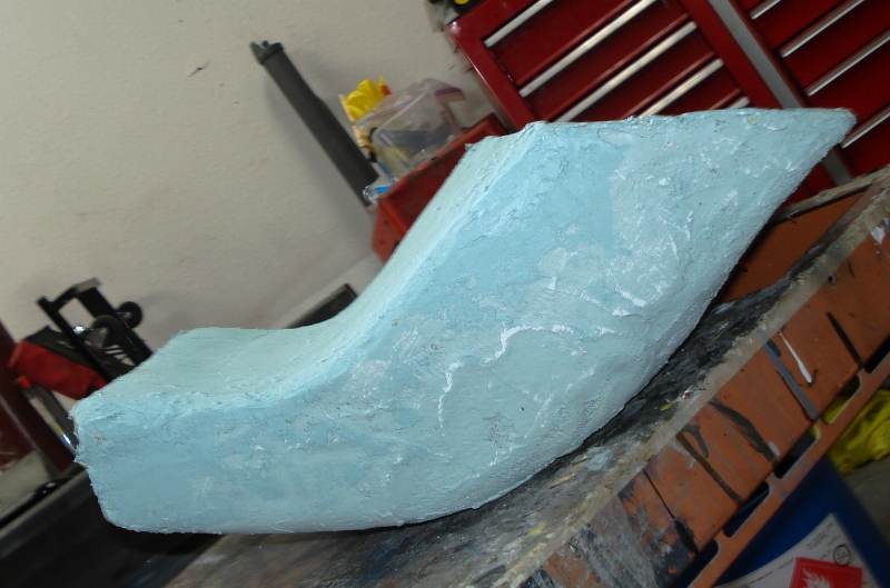

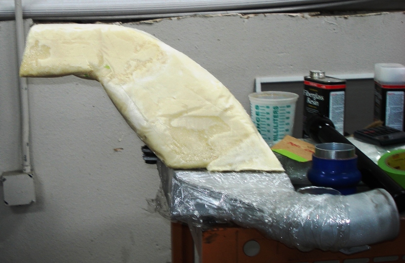

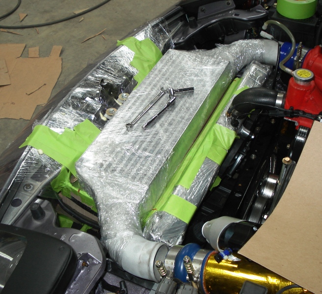

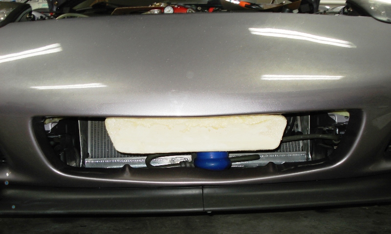

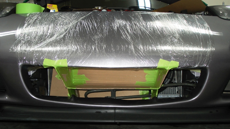

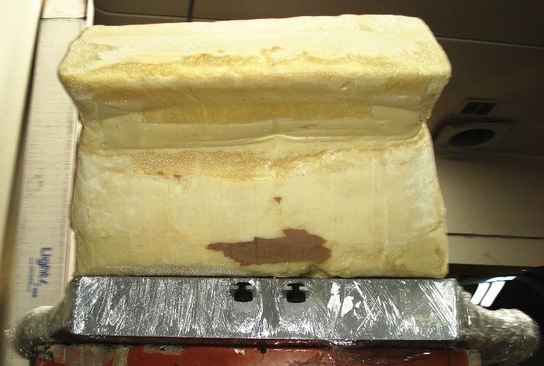

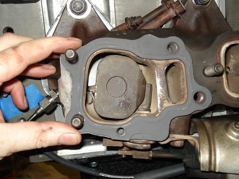

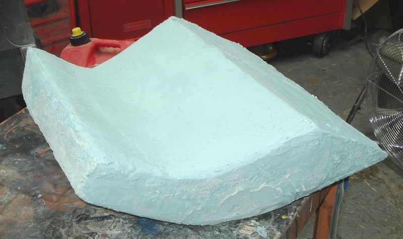

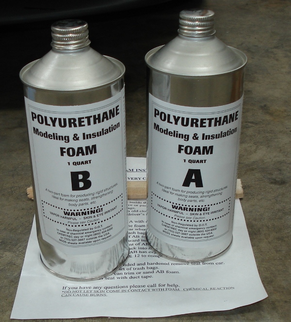

Well, I found one of my boost leaks, but I think I still have more. One possible one is at of all places my SARD boost controller, may be auditorial delusion though .
Also started making the plug for my intercooler duct. Need to finish shaping and cover the plug surface with body filler. Once done I will use this to make my carbon intercooler duct.
Need to do the same for the oil coolers, air box and radiator block off plates.

I love that foam

that expando foam is fun stuff, I take it your going to fiberglass/carbon fiber it or something? I used to know a guy that was good at that but he's in another state, seems like the way to do it is lay it and vacume seal it to make it look all fancy, as you can guess I've never done it but it looks somewhat easy.

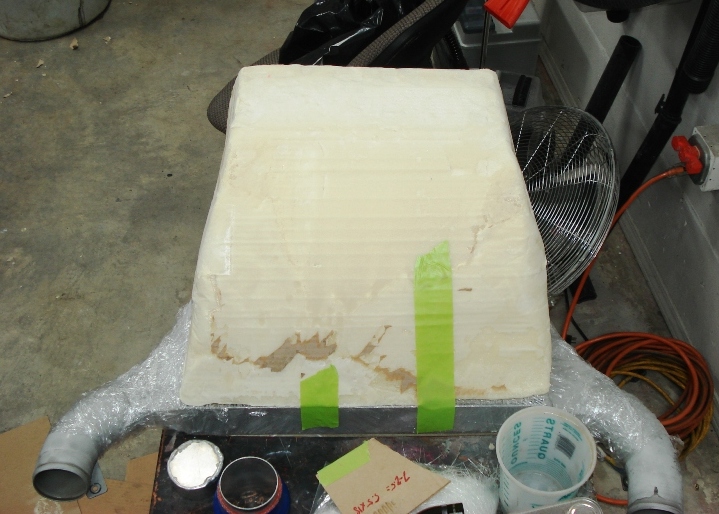

Started tuning for 14psi last night and getting good results, but have an issue where the boost is tapering off badly beyond 5K. Maybe the turbos are just running out of breath, need to verify there is no boost leak at the boost controller.
The intercooler duct plug is all body fillered and will be sanding it this weekend and making a fiberglass unit for a trial run to verify performance and mounting.
See attached vid of a quick 12psi run with the Synapse BOV valve going off. The noise is actually louder than what's on the video. Nice and crisp. If figure some of you audiophiles are wondering.
