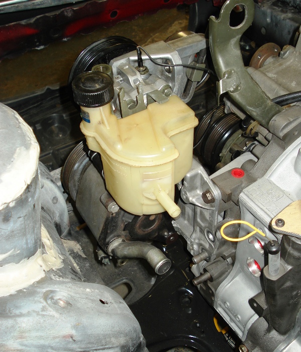

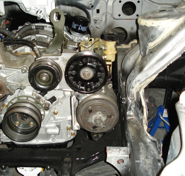

I also put my custom steering/air pump setup on and clearances look good, need to mod the outlet fitting on the air pump. The air pump will require an individual air filter or have a long ass tube to the air box I will be making. Started playing around with Rad/IC positioning and after looking at it I gonna need a new core similar in size to John’s IC. The one I have has a core height that's just too tall, yeah more money. I also mod'd the front nose undertray, by removing the top piece of the tray I can keep the tray and have the v-mount.

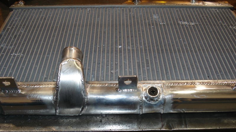

Old 01-06-07, 09:10 PM   #302
afgmoto1978
Location: Portland, Oregon
Posts: 2,503

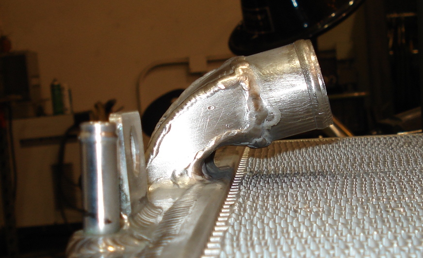

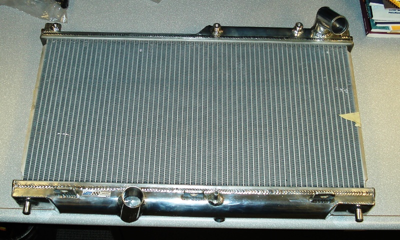

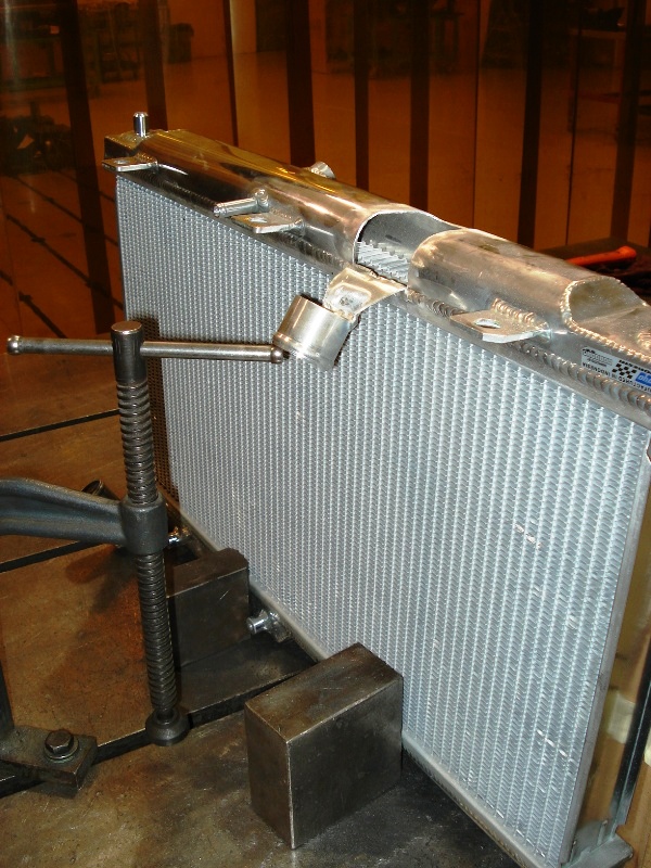

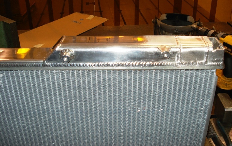

Started the process of modifying the radiator, relocated the drain port, and removed the stupid burp bung that's no longer needed, made a new outlet and plugged up the inlet. Need to play around with some things before I put in a new inlet. Was having a bitch of a time starting the new outlet build, had to be creative with the fixturing.

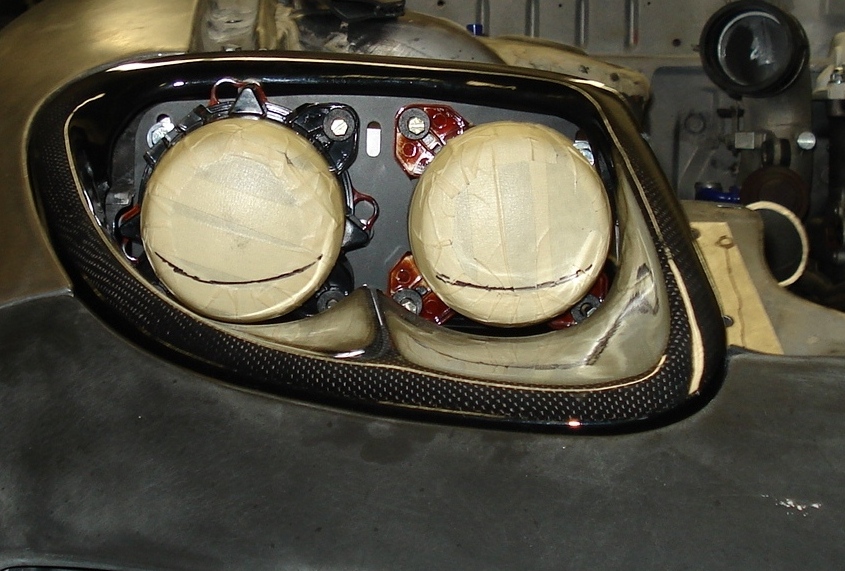

Alright cum guzzler here's your update...after getting the sleek headlight kit all properly fitted up with the new headlight bracket I made, the bulbs are finally in full view (the marker lines show how much of the lens was blocked with original setup). However, I didn't like how little material was left on the remained headlight structure so I've been redesigning and fabricating a welded structure that I should be finished fabricating today and have it welded on the chassis tomorrow.
Thanks Joe, the only reason I’m able to do all this is I’m single, have a place to do it (Apex Restoration) and have full access to a fully equipped machine shop, lol.

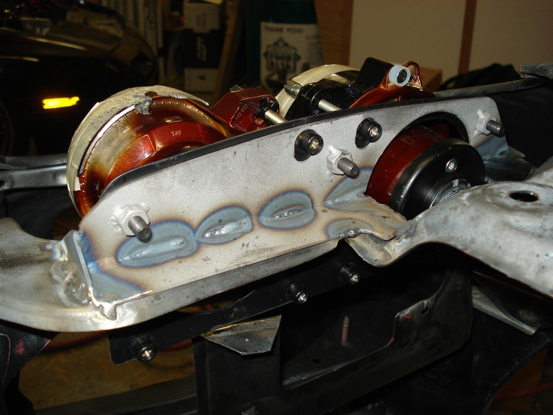

Old 01-22-07, 11:16 AM   #306

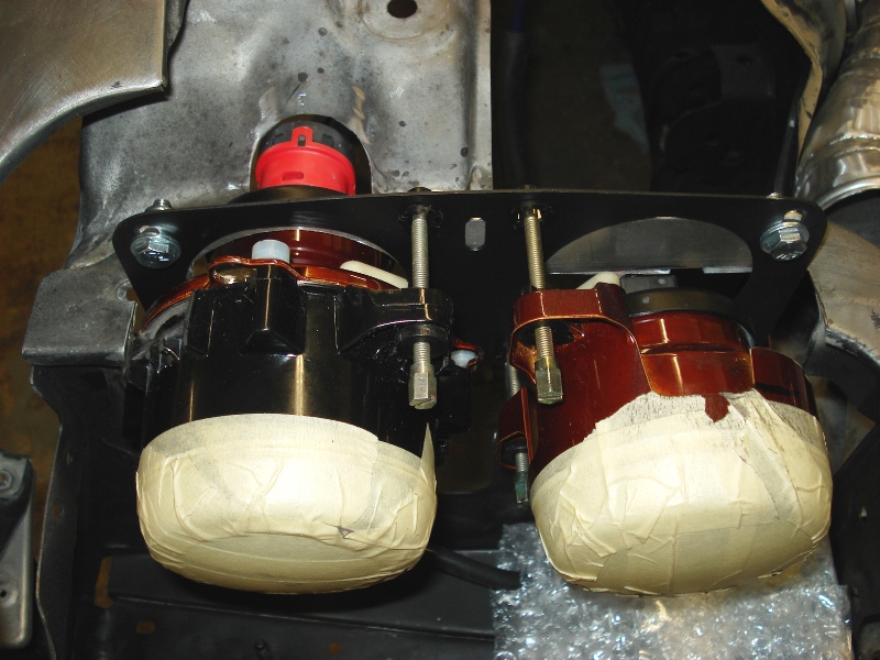

afgmoto1978
Posts: 2,503

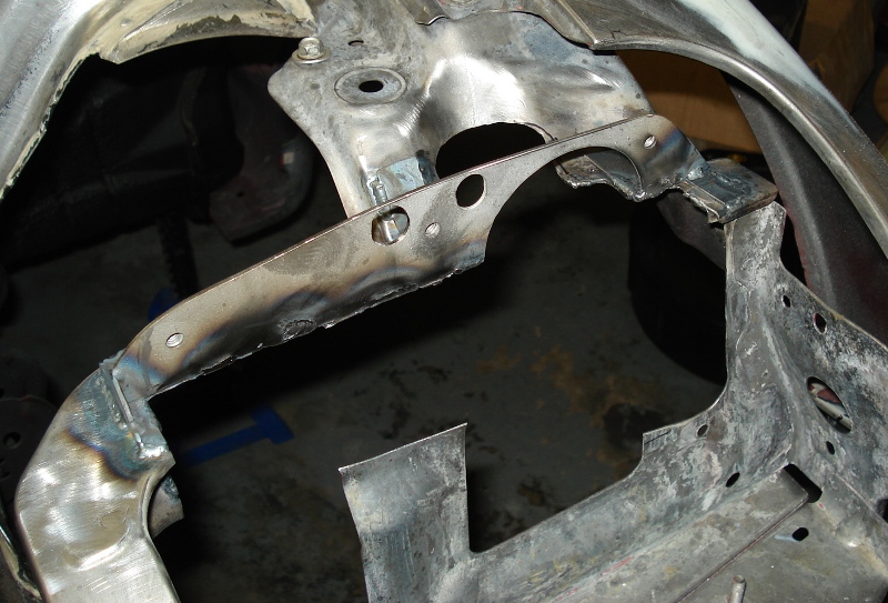

Got the new headlight frame all welded in and it turned out pretty good, nice and solid. I still need to add a gusset to support the bottom of the headlight panel, but other than that, I’m there. Also started playing around with the turbo ducting and how I’m going to join the two turbos, the picture will give you an idea of the direction I’m going. Also I plan on having the bypass valve (Greddy BOV) on the secondary plum back in to the intake serpentine tube.
ID:	217485   Click image for larger version
ID:	217486   Click image for larger version
ID:	217487   Click image for larger version
ID:	217488   Click image for larger version

Old 01-28-07, 03:26 AM   #308
afgmoto1978
Posts: 2,503

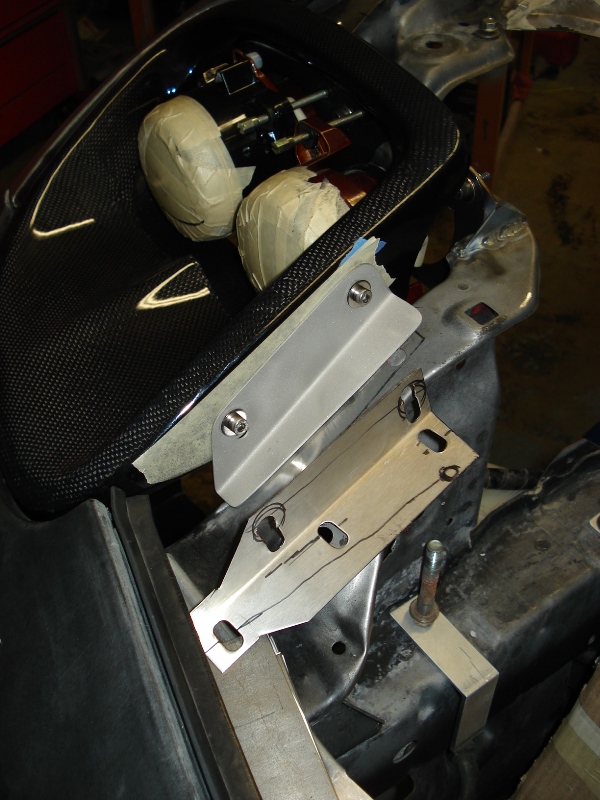

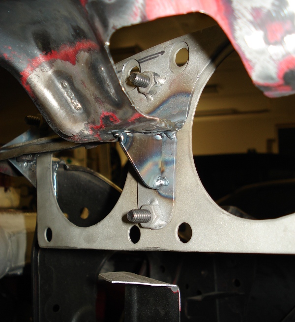

Alright, got the headlight shroud mounting plates done, looks nicer than what came with the kit. Also, I finally got my IC core and proceeded making the end tank for the turbo side and welded it on once I welded and smoothed out the internal seams.

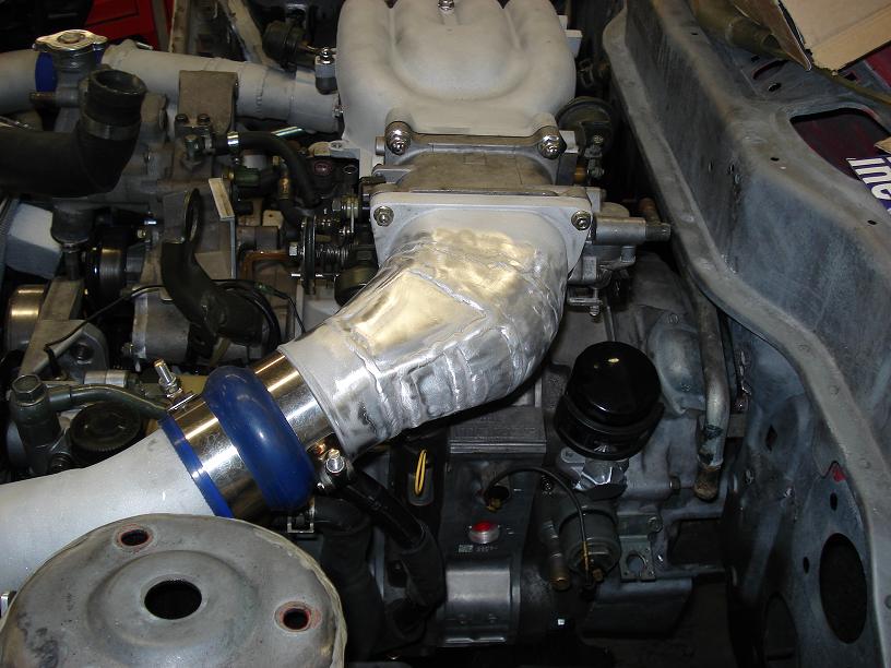

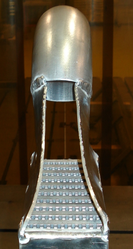

Old 01-29-07, 11:43 AM   #310
afgmoto1978
Posts: 2,503

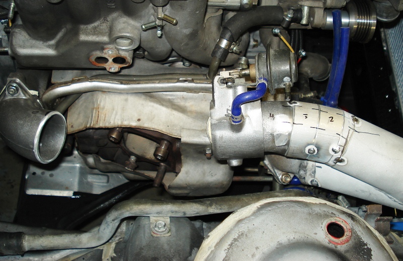

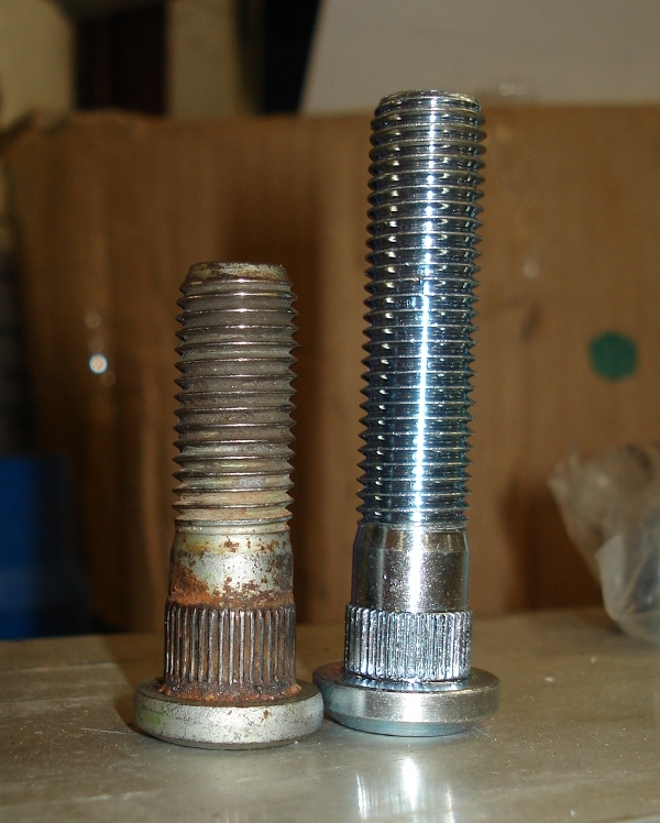

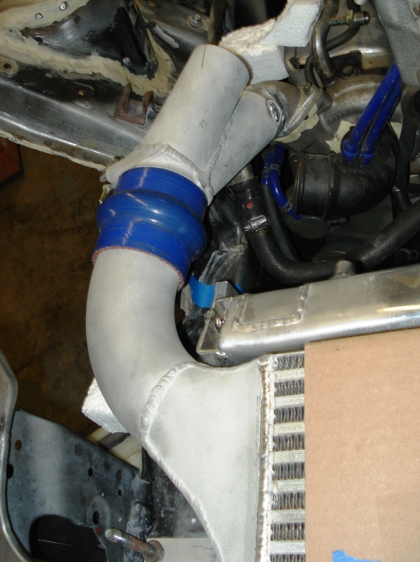

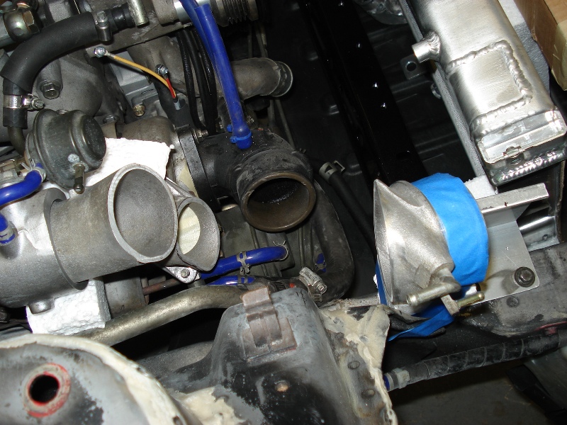

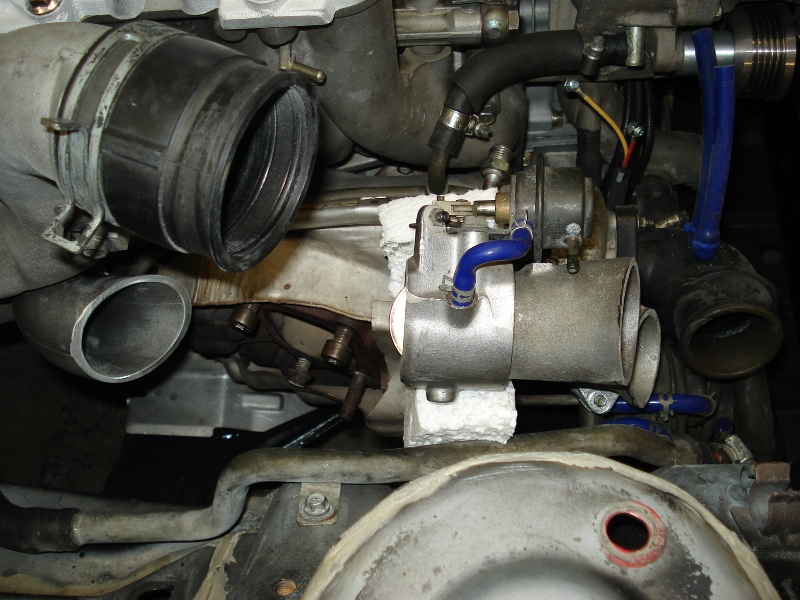

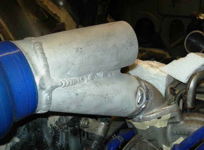

Got most of the routing for the twin turbos done, just need to cut a section for the secondary tubing. Currently have it all tack'd up to confirm everything lines up. I also have the intake side IC endtank started, but need to wait for some 3" tubing to finish the routing before I finish it. I started on modifying the greddy elbow too, but didn't like the direction I was going....need to put more thought into that. Man, I tired.
Oh, I also got some Mackin industries 20mm longer than stock wheel studs.

Old 01-29-07, 12:56 PM   #311
Upgrayedd
aka mazdatim
Upgrayedd's Avatar
Join Date: Dec 2005
Location: Seattle
Posts: 3,928
Send a message via AIM to Upgrayedd Send a message via MSN to Upgrayedd

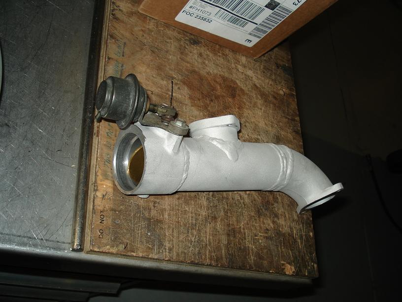

In the third picture did you place an actuated valve to keep the secondary from sending boost to the IC?? Mimicking the stock Y pipe?
Upgrayedd is offline   Reply With Quote
Old 01-29-07, 03:21 PM   #312
afgmoto1978
Posts: 2,503
Actually I'm using part of the y-pipe for my setup and yes I'm retaining the secondary actuator valve.
Old 01-29-07, 04:58 PM   #313
Upgrayedd
aka mazdatim
Upgrayedd's Avatar
Join Date: Dec 2005
Location: Seattle
Posts: 3,928
So is that the piece from the y-pipe? Just REALLY clean? I've never seen a clean y-pipe lol
Old 01-29-07, 06:46 PM   #314
afgmoto1978
Posts: 2,503
Hehe, it's a lot easier to weld when it's clean.

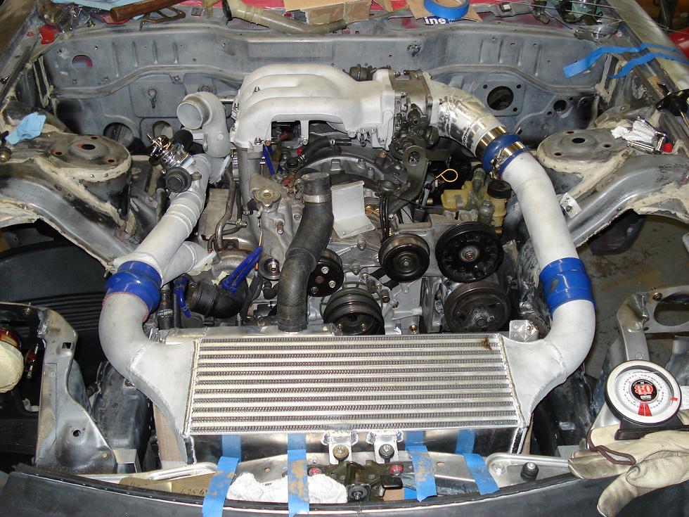

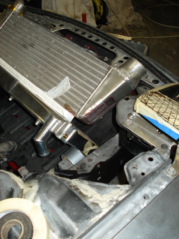

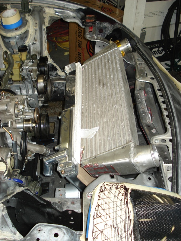

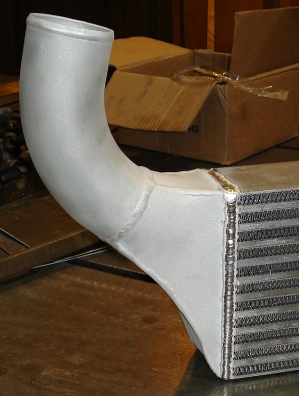

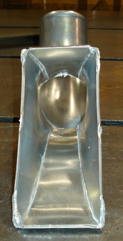

Old 02-04-07, 10:59 PM   #320
afgmoto1978
Posts: 2,503

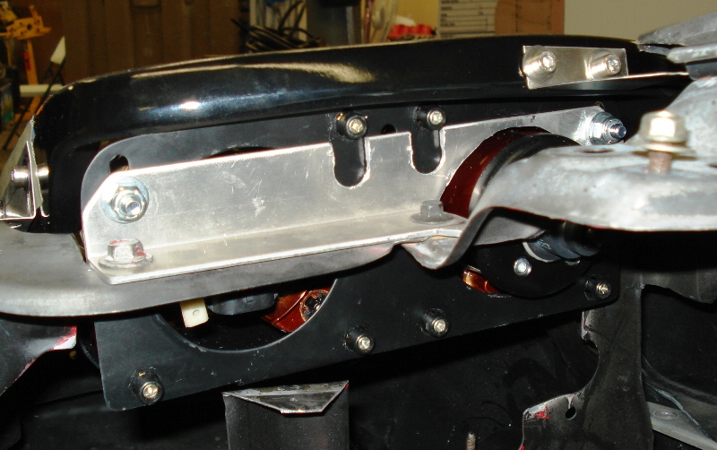

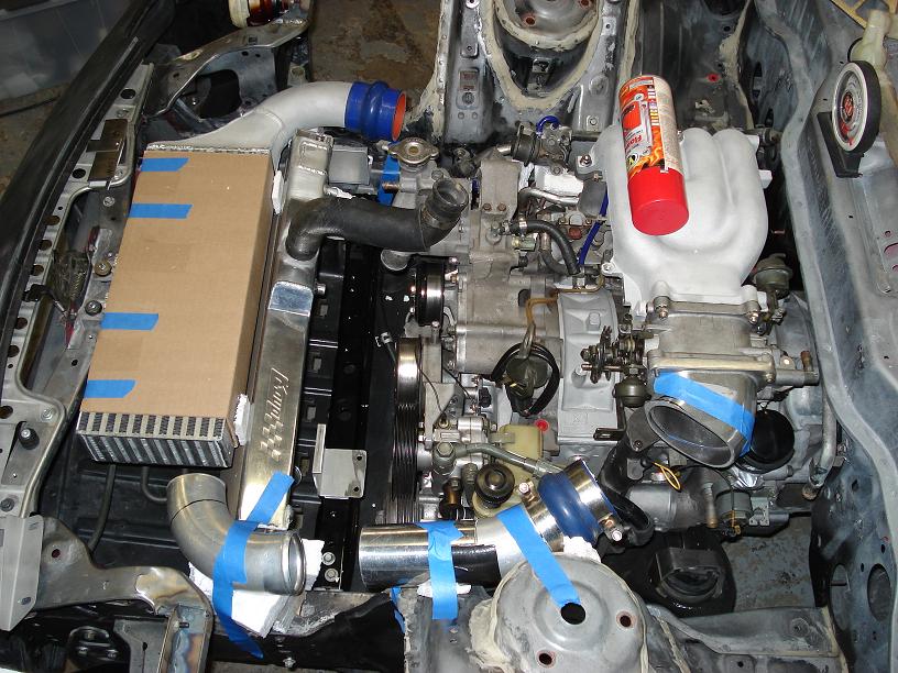

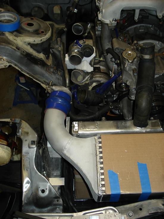

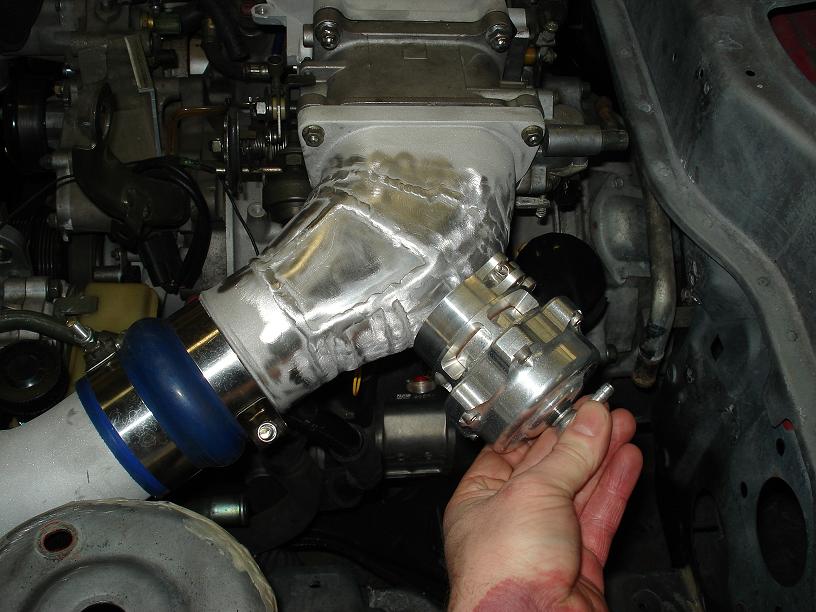

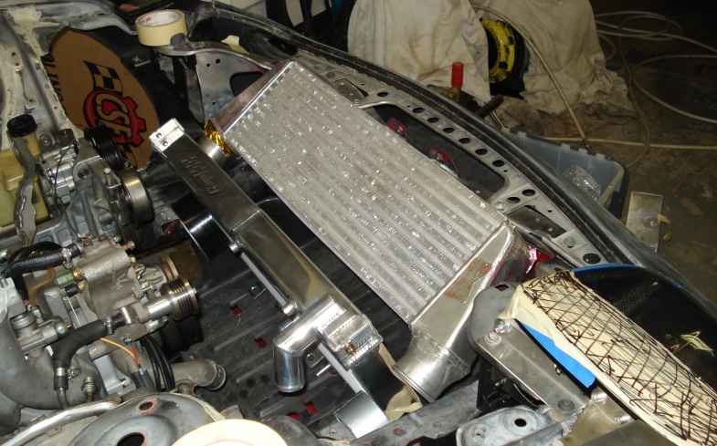

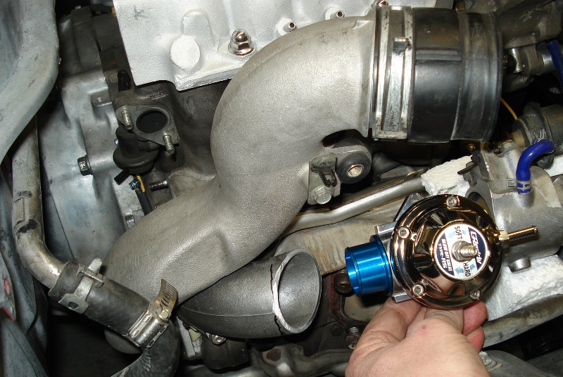

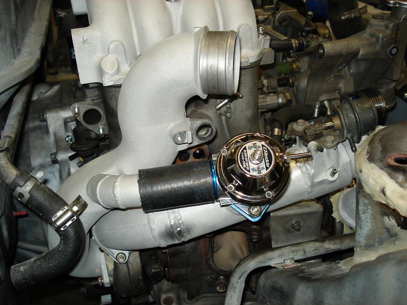

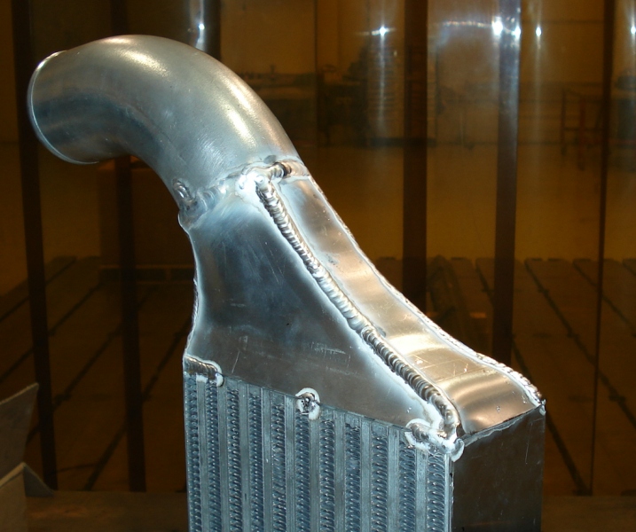

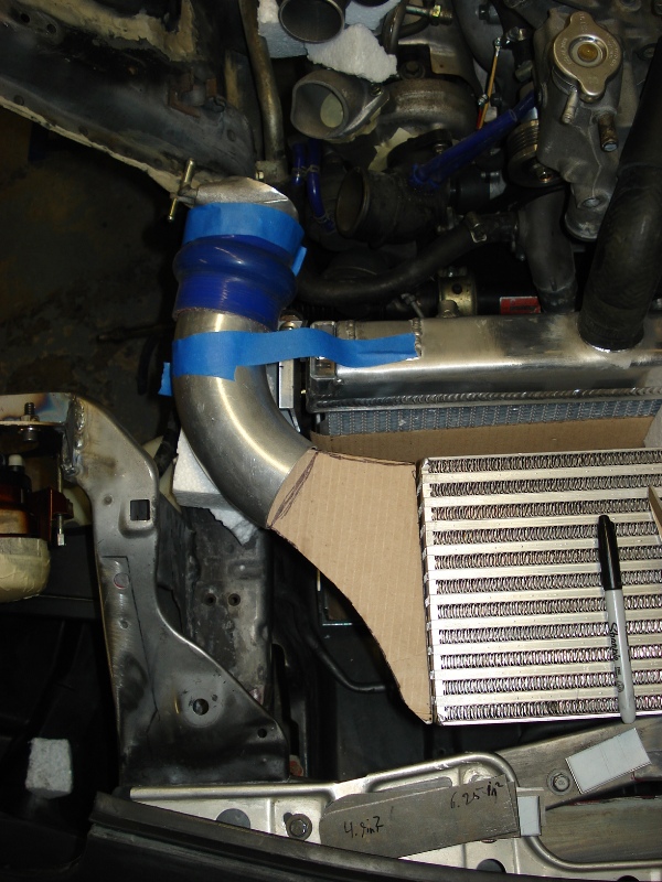

Alright, got the IC and ducting done. The Secondary turbo BOV is in, just need to finish welding in the recirc tubing. The throttle body end tank is a bit frankensteinish, but it will work great. Trying to decide if I want to weld on the Tial BOV on the throttle body end tank or at the cold side end tank of the IC.
I need to get the rad fan I want and I should have all the mounting done by end of week. I still need to do the oil cooler mounting, waiting for some fittings before I go further on that. Making progress.
I'm also trying to decide if I want to mod the hood so it's vented. A lot of work, but it would be functional and bad ass at the same time.......

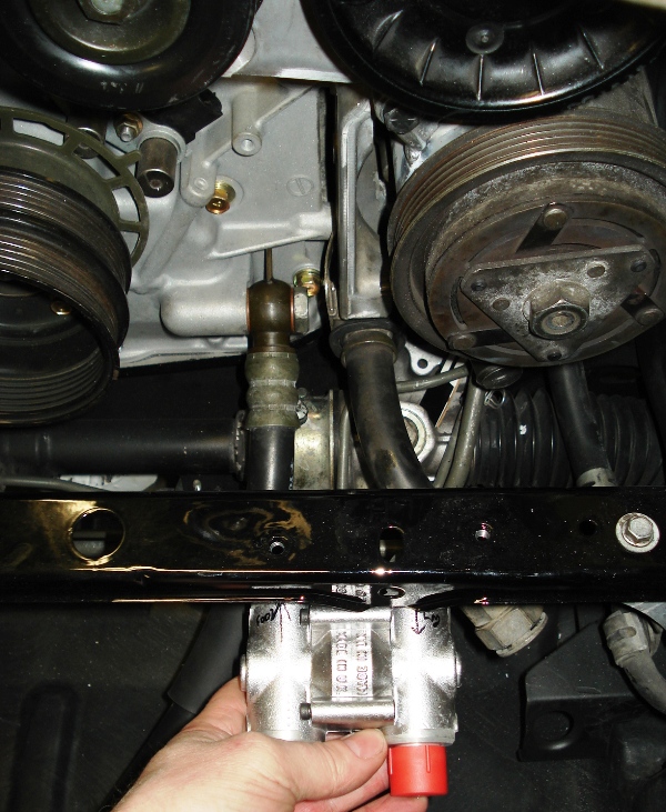

Old 02-12-07, 12:30 PM   #322
afgmoto1978
Posts: 2,503

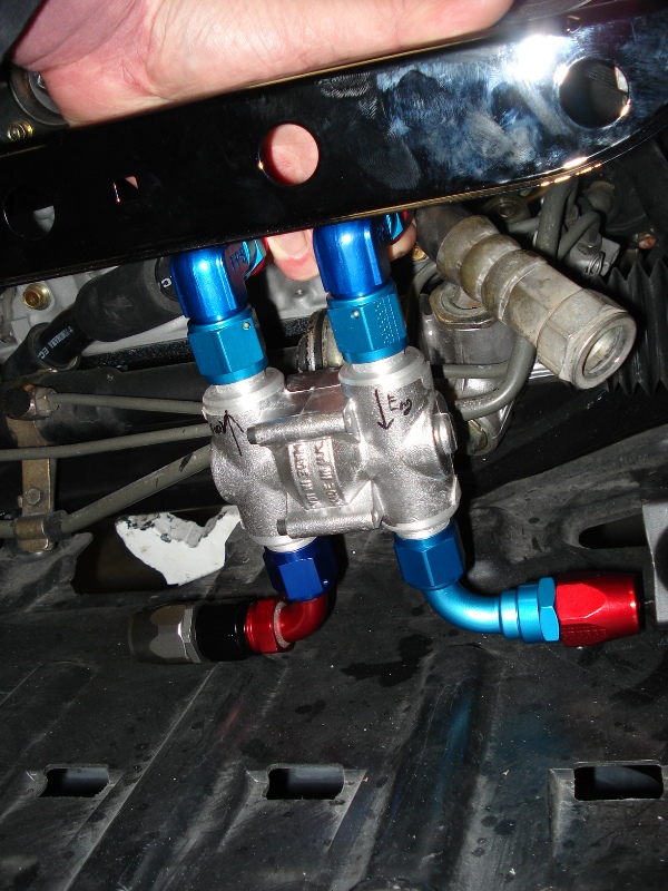

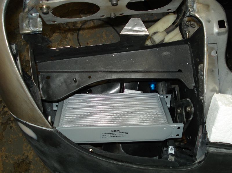

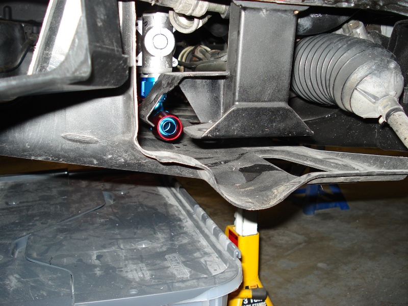

Okay, so I fab’d up a mount for the Radiator and I didn’t like how it turned out so I’m redoing it. However, I was able to put rivnuts on the driver side frame rail for the rad mount. FYI, if you ever use these things be sure to do a mockup on another piece with the same thickness to get the crimping settings right. These things are prone to spinning if not installed properly. On that note I added epoxy to the mix to further reduce that risk. If you look at the mockup panel I did you can see three different degrees of crimping, the center on is what you want to look for.

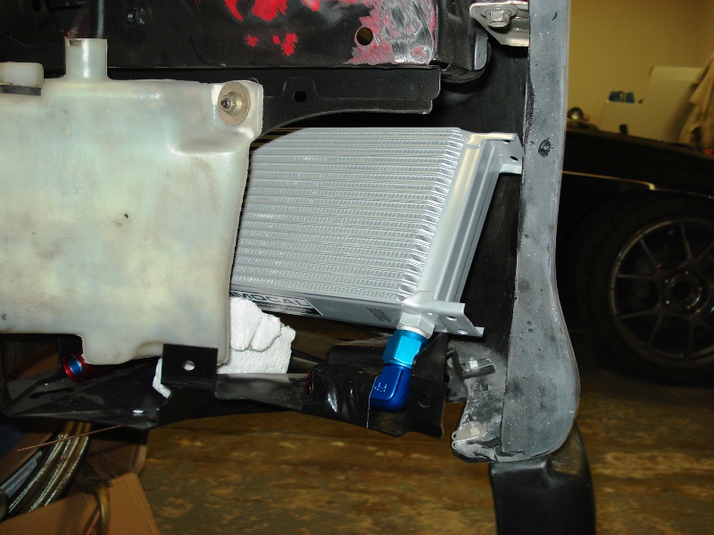

I also started playing around with the mounting location of the Mocal oil thermostat. I was hoping to utilize the stock inlet/outlet lines, but it’s not looking like that will work. I have to go buy more fitting for the twin oil cooler setup.
Tack’d the headlight support tabs too, welding upside down isn’t easy.
Peace

Old 02-13-07, 12:05 PM   #323
afgmoto1978
Posts: 2,503

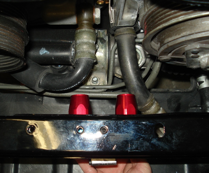

Got most of my oil line fittings so I went ahead and started playing around with the setup.

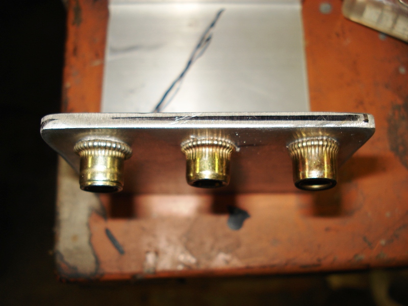

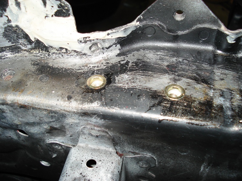

Old 02-17-07, 12:13 PM   #324
jkstill
jkstill's Avatar
Join Date: May 2002
Location: Portland OR
Posts: 1,237
Can you get the splined rivnuts locally?
If so, where?
Old 02-17-07, 01:30 PM   #325
Blake
Blake's Avatar
Join Date: Aug 2001
Posts: 2,267
If so, where?
Parkrose Hardware has them. They also have an awesome metric section.
