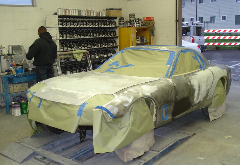

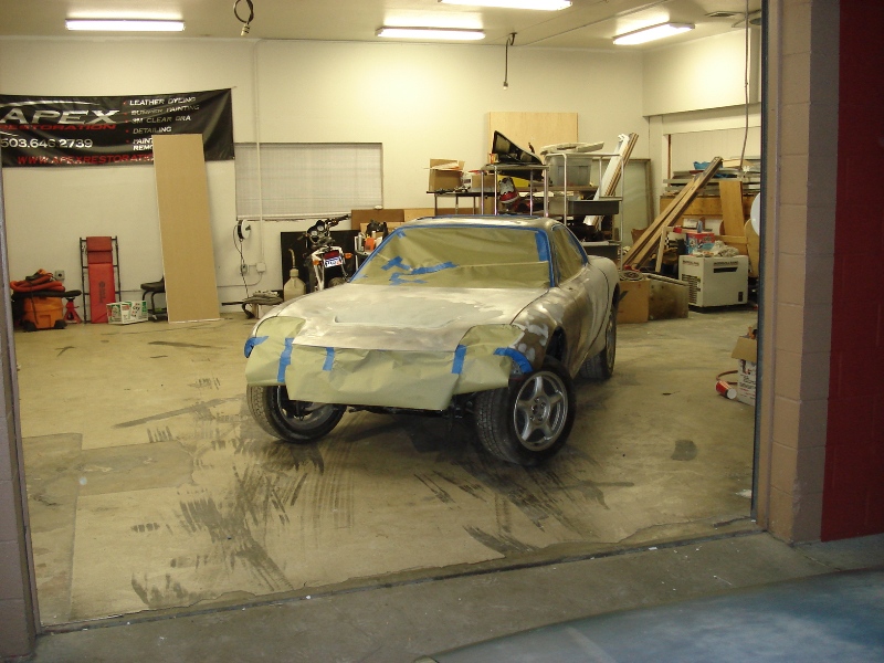

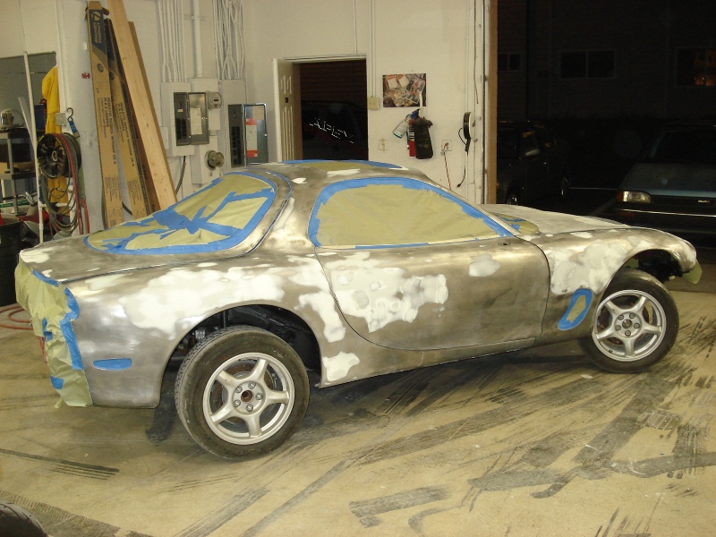

Alright, did some touch up on some of the ~wavey~ sections and got the car all taped up for the spray on "Mud". Also fixed one of my fender vents with the nifty plastic welder I got. Well worth the money buying that kit. Also, for those who have hood struts, you might want to grind off the excess material on the hood mounted pivot tab. It won't sit properly otherwise.

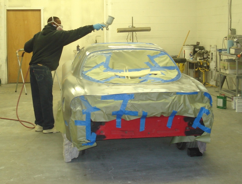

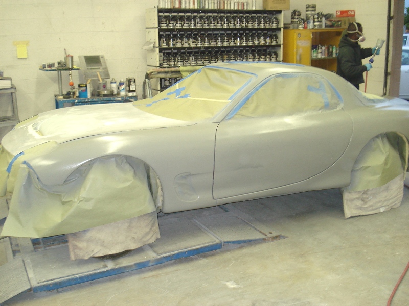

Alright, Leo helped me put on the spray-on bondo, 3mm thick! After looking at the options I'm going to try and see if I can rent are booth and have Leo paint it.

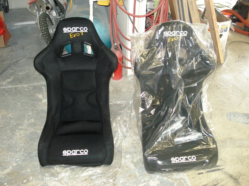

After looking at the dimensioning of the Evo 3's I went with Evo 2s'. It's going to be tight, may have to modify the center console and possibly the door panels to get the seats to fit. Well see. http://www.sparcousa.com/pseats_comp.asp?id=469 Went through Speed Concept off of TV highway http://speedconcept.com/. Got a 20% discount on both the seats and wheels. The wheels will take some time to get, custom ordered set from Japan.

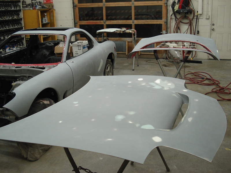

Well finished sanding at 2am today. Very, very sore now. Primer and jams painted shortly.

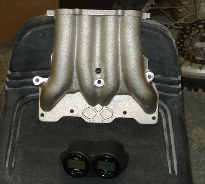

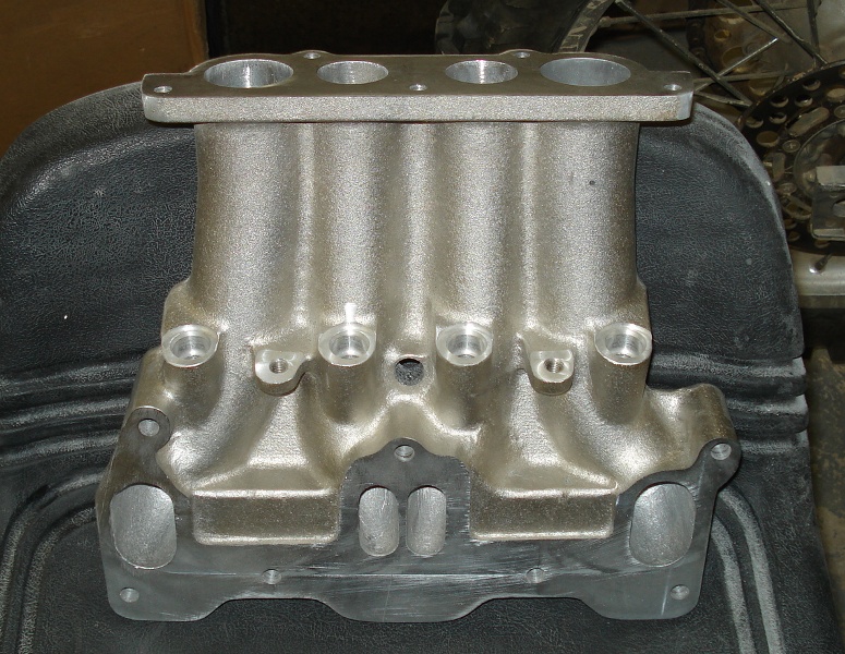

I also got somemore goodies this weekend.

Well it's looking like Firday is the day for it to be painted.

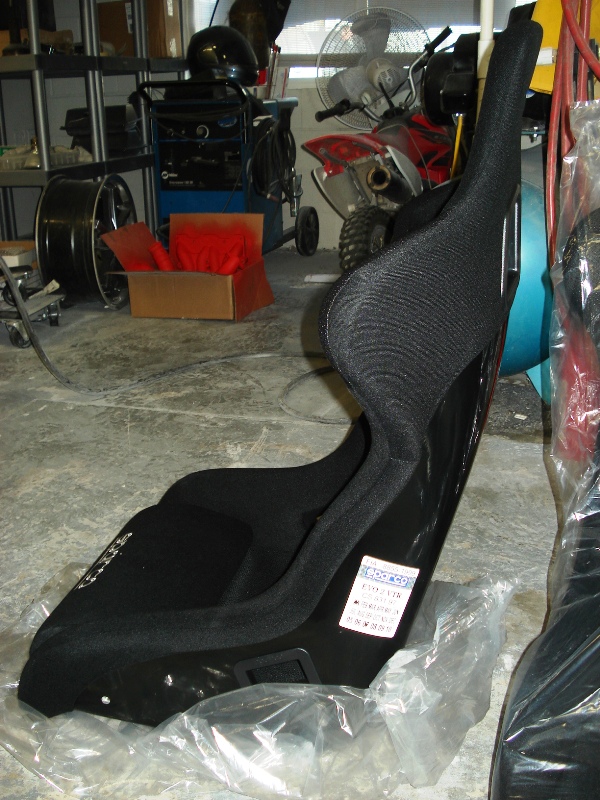

Got my seats in Yesterday, it's going to be a tight fit, but it will work. Will have to modify the floor and make custom side mounts for them.

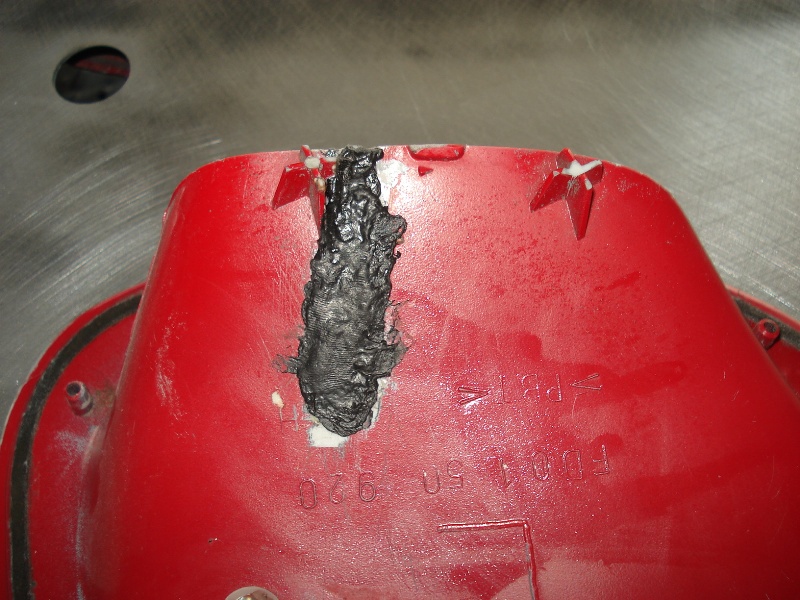

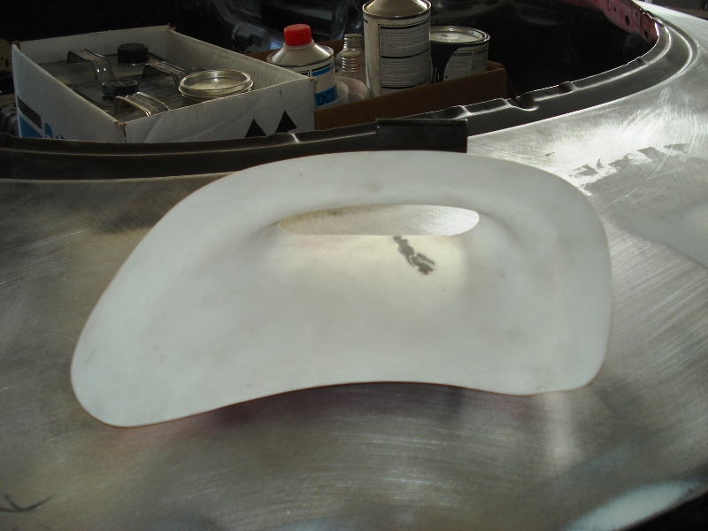

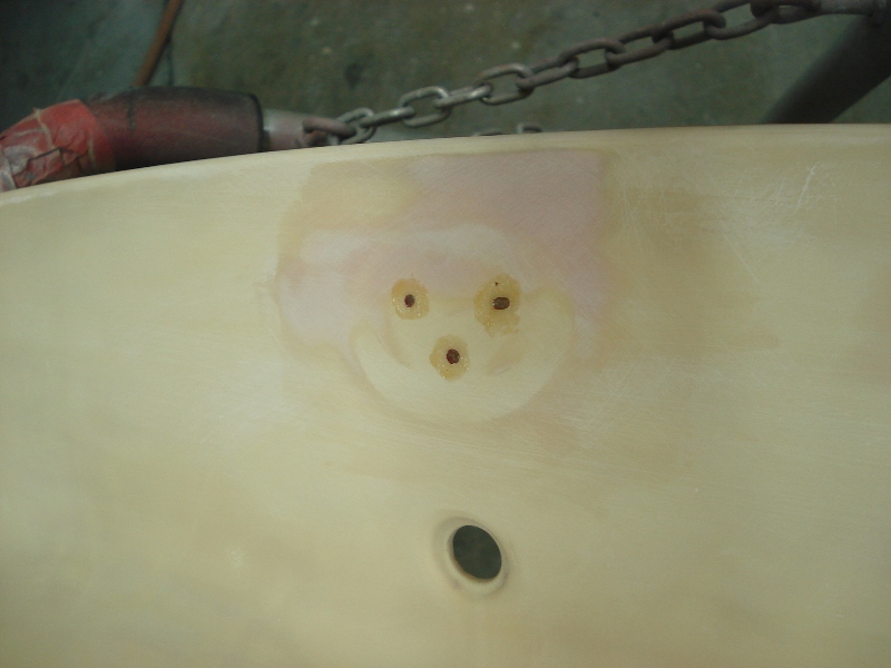

See picture for Snap-On plastic welder part number and the a view of the emblem hole I filled on the rear bumper. View of surface before I sanded.

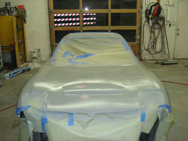

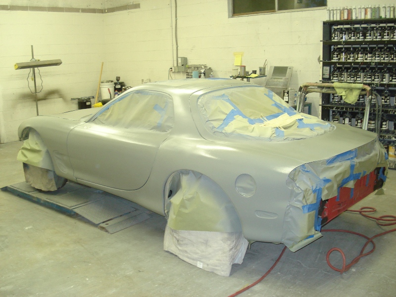

Car ready for primer, hopefully Leo will have the primer on by the time I get to the shop today to wet sand it.
