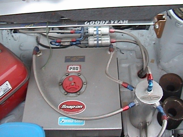

Here's a pic of the surge tank on my car. It's roughly 3" round and 18" deep.
-Destin
ID:	142373   Click image for larger version

The intank pump before the surge tank doesn't have to be as big as the inline pump after the surge tank. You plumb the return from the engine back into the surge tank and then an out from there back to the main tank. Also most surge tanks aern't more than 2 liters or so.
