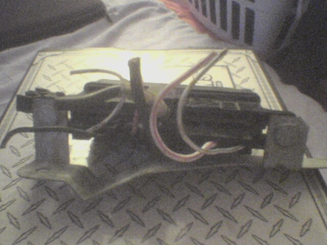

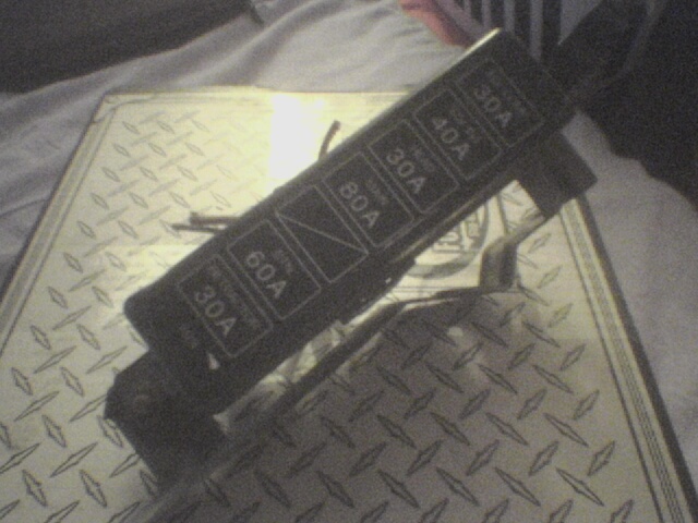

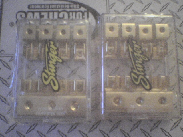

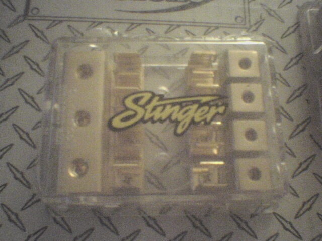

Okey, for those who asked...
Two pics of the aftermarket fuse blocks I bought:
Two pics of the FC fuse block I salvaged... I think I have another somewhere...

BTW,
The 2nd gen block is spoken for, and so is the second one, once I find it.
The aftermaket blocks are gold-plated, solid brass, and quite heavy.
They look to able to take a 2 guage input wire in any of 3 locations, and about a 6 guage output. They use standard LARGE size tube-style fuses (which are available in nice high amp-ratings)
I have an -SE so I need 5 fuses for the stock wiring. I'm going to need at least one more for the stereo/computer set-up I have planned, one for the amps... and probably one more for an alarm...
