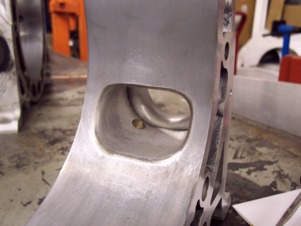

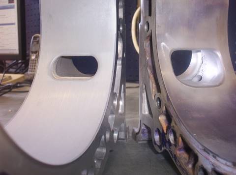

Originally Posted by Turbo23 View Post
I know the r26b housings are specially made. But I figure a hole is a hole, and I wasnt sure with that angle what the port timing they had figured it to be
I used my MFR housings as a "template", a few milimeters below center of the water passage block-off is pretty damn close to the MFR holes.
NOTE: Previous owner ported the fuck out of the MFR housings
what the fuck was that guy doing with that housing?
I woulda have loved to have seen the dyno on that thing, no power before 9k.
I also wonder what the VE on a motor with ports like that looks like.

What do you mean? That's a stock Mazda peripheral port housing.
Yeah... actually, it looks about what the baseline in that paper I keep flaunting was (IO 100BTDC, IC 75ABDC) which puts the torque peak around 7.5-8k RPM. Incidentally, it's also rather bigger than the numbers Yaw has on his site... hrrm.
Question. I've heard talk of at least two different styles of MFR housings (qualifying with more square ports, race with rounder) and I've come across at least three different port timing configurations... anyone have any data on when the various setups were run? Were the MFR housings supplied as-cast to people and then various teams did their own porting setups on them? Well, okay, rather did Mazda provide data on where to port to; I know that Downing at least makes mention of reworking the MFR housings.
'course, there's the NA drag guys who keep occasionally making vague comments about port sizes and horsepower levels that came from developing far past MFR bits, but I don't think any of them are going to talk about their setups in detail...

Wow, sorry then, I have just never really gone to much into PP housings.
Nice stuff there.
Probably that's what the guy wanted.
The good thing about PP's are that they can be tuned to make power anywhere you want it.

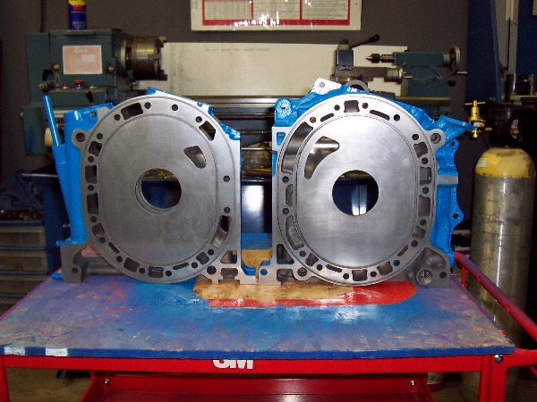

This is a very interesting thread. Another question for you. I have read that you have to run 1 piece apex seals with a PP is this true? If so why? They can cope with passing over the exhaust ports why can`t they cope with the PP?

Intake ports are plugged by filling with some sort of epoxy; Devcon being the most commonly cited one.
One piece seals... I thought that was just a bridgeport thing. Can't see how it wouldn't work with peripheral ports.

Any way cool site I was just kidding around in the above post but ....Yes azrotaryrockets is Paul Yaw's aprentise Glen Weaver .... Cool P ports check out azrotaryrockets soon for new pport tech.......
Pics I was talking about in above post.
Oh and the last one is azrotary rockets extreme race port next to a fd3s stock port after Paul trained a bitch meaning me....
