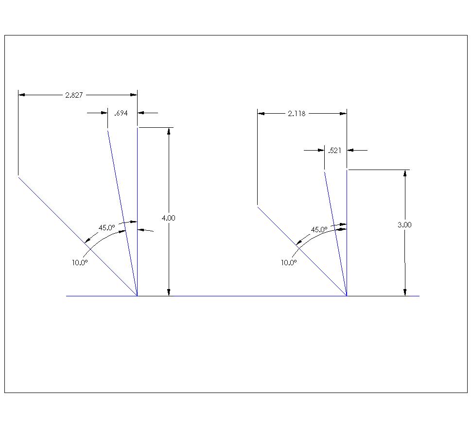

Originally Posted by Kentetsu
If it were slightly shorter, then you would reduce the number of "turns of the wheel" needed to make the corners. Right?
Shorter would increase the number of turns for the same amount of wheel angle change. I did a quick drawing. The 4" and 3" numbers were just pulled out of the air, not true pitman length.
It shows that changing the length shorter will give you less angle. You would also need the pitman and idler to change the same amount (As posted above). This would effect bump steer not caster though.
-billy

Nice work Billy, and good point Moses, I overlooked that entirely.

Ah, yes Billy I did have that backwards. Also, the idler arm would indeed have to be changed. I know that Datsun Racing offered shorter knuckles for the Z cars to quicken the steering ratio. Too bad we don't have something like that available...
