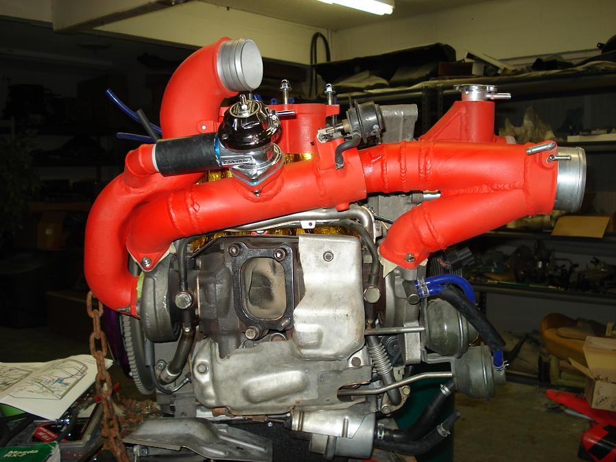

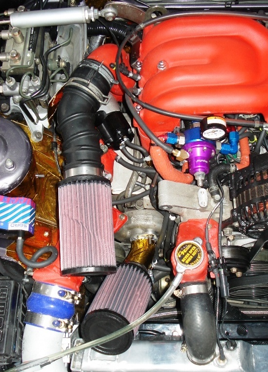

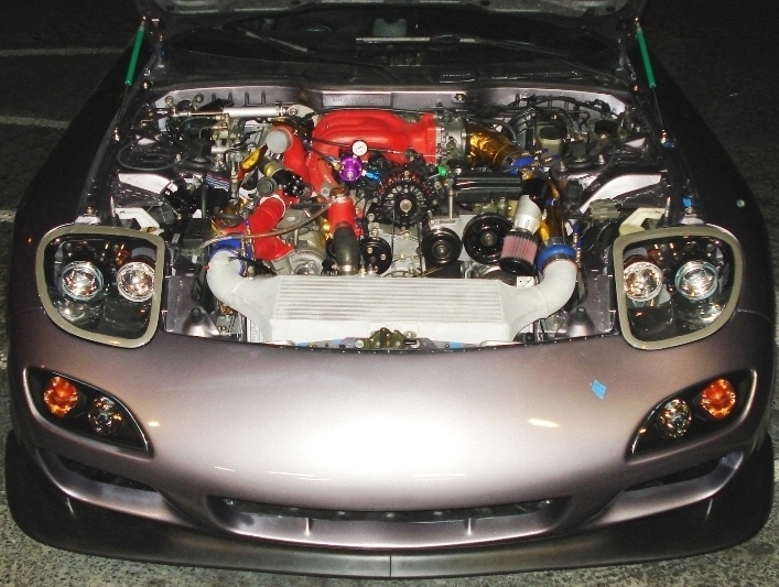

More Pic's for reference of my setup.
ID:	268753   Click image for larger version
ID:	268754   Click image for larger version

Location: Oakland, CA
Posts: 732
That's a pretty insane pipe job for the Hitachi twins. It gets me wondering what's really inside them.

Originally Posted by puzzlerok View Post
It's only necessary for stock closed-loop MAF setups so you don't run rich between shifts. If you have a standalone that uses open-loop and a MAP sensor you can vent to the atmosphere. This BOV stays open under vacuum to bypass the turbo restrictions so it's recommended that a K&N filter is fitted to the dump fitting, that's how I run mine.
In other words, it is optimal to recirculate on the FC, since it has a MAF fuel injection system. The FD does not measure air flow (it has a "speed-density" FI system), and so can vent to atmosphere.
-Max
