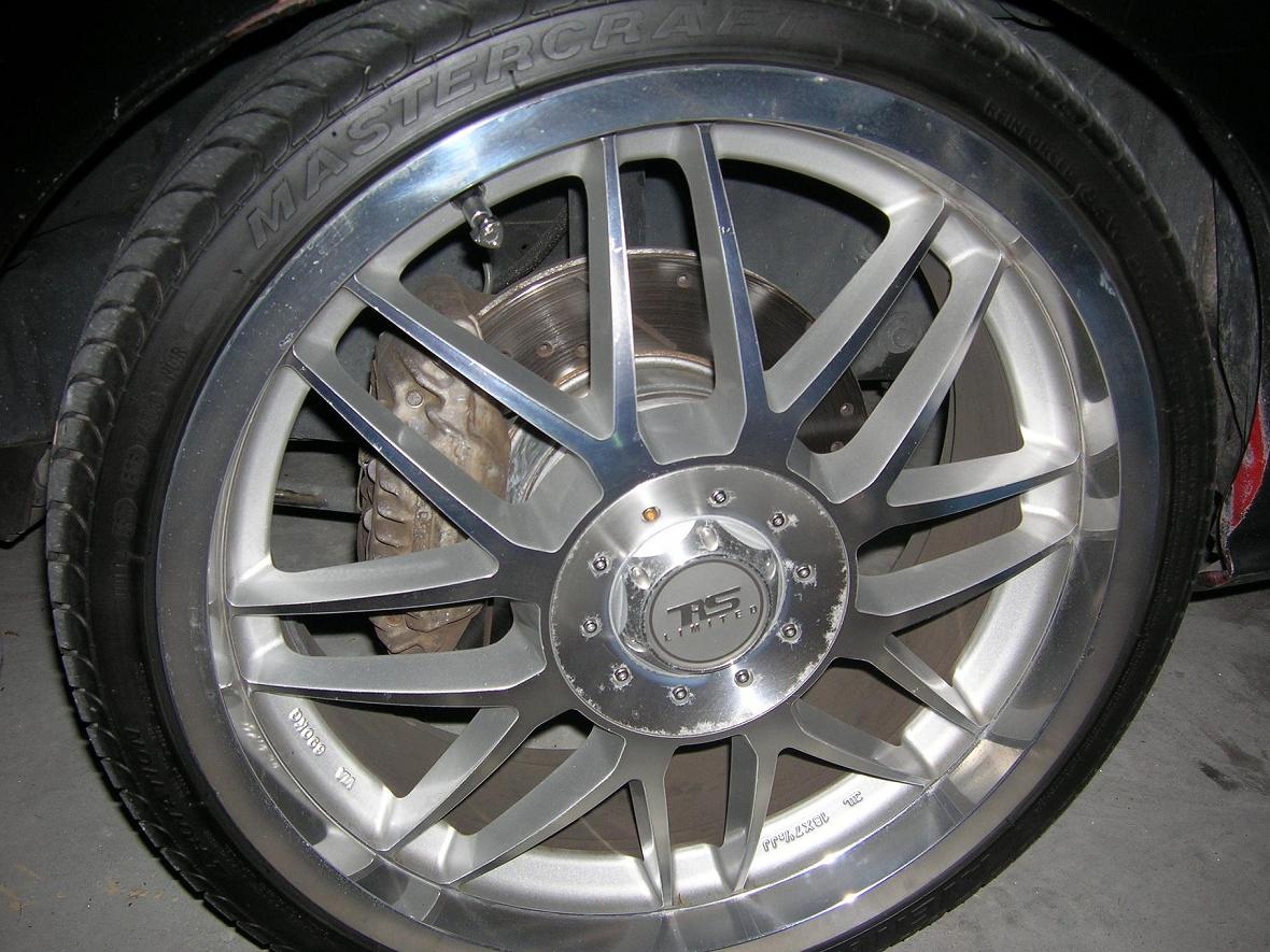

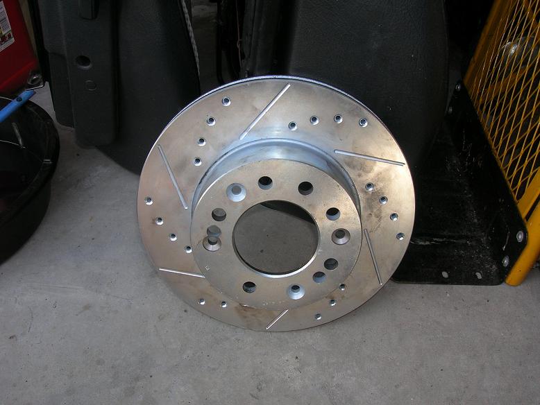

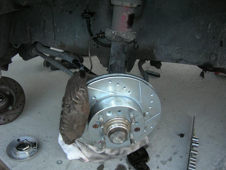

i did it about a year and so ago also on mine.
