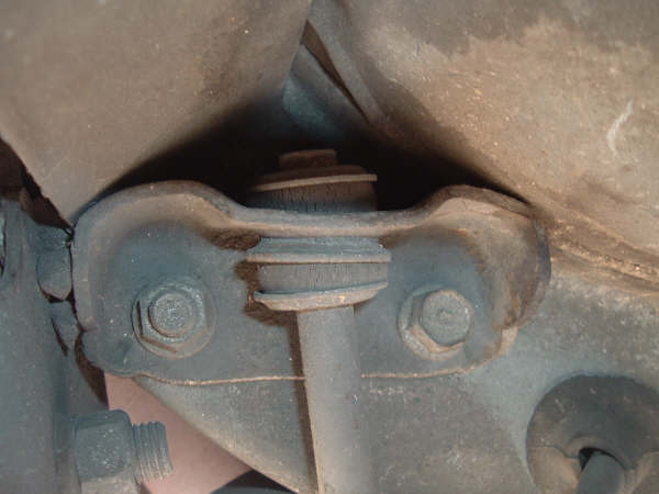

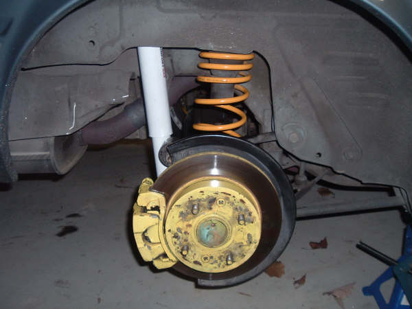

Hey guys i replaced the rear shocks on the weekend its done a world of good. the rear left shock made a scary sound of leaking fluid when depressed by hand after i removed it!

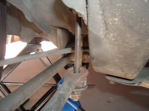

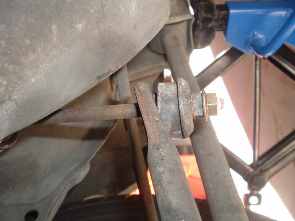

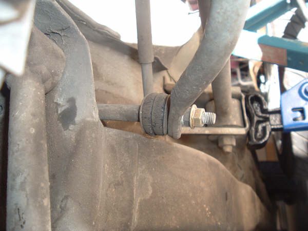

Its the first time ive been able to get under the car since ive had it, i was shocked to see the state of the rear sway bar!! it was missing rubber on one side and has what seems to be a makeshift shaft with a used shock bushing on it? plus the bushings are rooted!
ive posted some pics just so you can see how bad it is! ill be replacing the inferior chassis linking shaft and also putting in new poly bushings once its been cleaned up.
The front is pretty much the same as the rear and its a work in progress.
But the rear shocks went in fine and are working well.

Measure the length of the end link, then go to a parts store and pick up an aftermarket one. I don't know if you have Energy Suspension parts down there, but I paid like 8 bucks for a set on my car and they are very heavy duty and include urethane bushings...

Those are the correct bushings, however, they aren't installed properly, so basically the bar isnt doing all that much, its just along for the ride. Once you replace those you should notice a significant difference.
