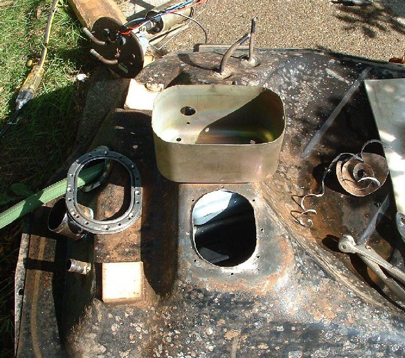

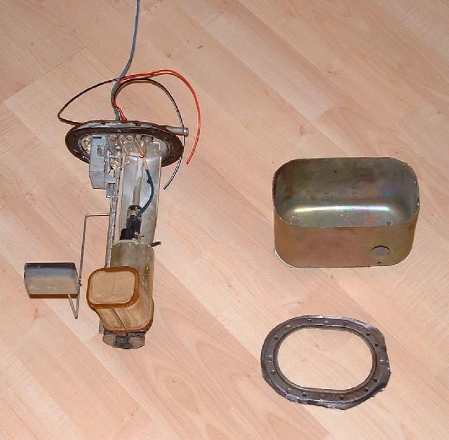

An FC fuel pump assembly, mounting flange, and slosh cup were scavenged from a tank at the auto wreckers. Tanks are already cut open to drain fuel when a wreck comes in, so the tanks are scrap value only.
The parts as removed can be seen below:

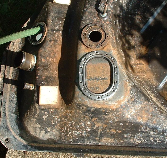

On the SA tank there is only one location where there is enough space to mount the FC flange. The mounting area was sand-prepped and then the cutout marked with a Sharpie. See pic below:

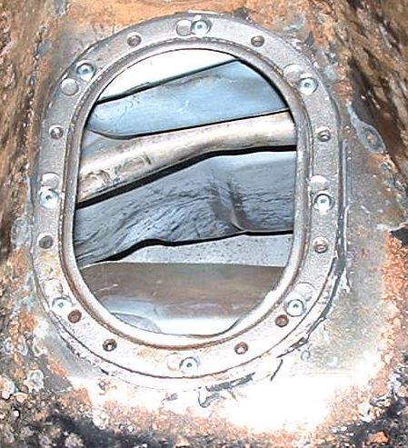

The FC flange was prepared for rivet mounting by drilling and countersinking eight 1/8" dia. holes around the perimeter of the mounting flange between the already existing threaded holes that the pump assembly fastens to. About 1/8" of the lip of the tank opening can then be carefully bend upwards to mate nicely with the FC flange. Once the flange was fit nicely to the tank, the rivet holes were drilled through the tank using the flange as a guide. Clecos were used to hold the flange in place to ensure all holes matched. Rivets or suitable screws could be placed in the holes temporarily as well if clecos aren't available. Be sure to clean any chips from the tank periodically during this process.

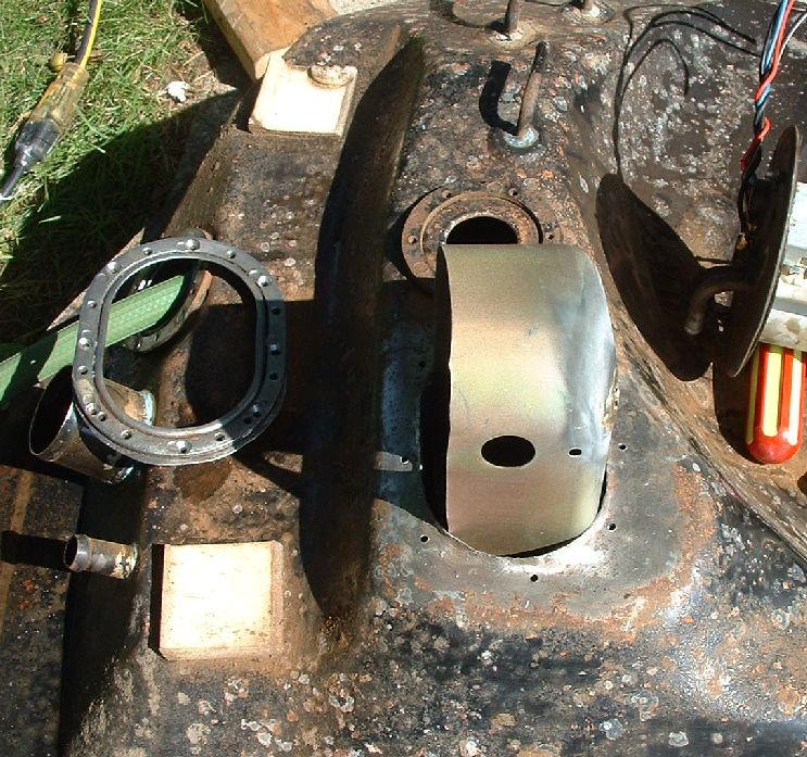

Now the tank is ready for the flange, but it should not be mounted yet. The slosh cup needs to be fit to the inside of the tank first. The stock slosh cup won't fit into the hole in the tank. To fit, it needs to be trimmed down about 1" in height. Had the mounting flange already been fit, it would need to be trimmed even farther, as the flange has a slightly smaller opening than the tank hole.
The stock internal baffles within the tank needed to be bent forward slightly to make room for the slosh cup. The next pic in sequence shows the baffle 'tweaking' needed. The slosh cup location was finalized by trial-fitting the pump assembly and checking for clearance with the return tube and pump pickup. Two 3/16" dia. rivets were used to fasten the cup into the tank. To seal these rivets, a small amount of metal-filled epoxy (JB-weld) was placed around the rivet, and at the interface between the cup and bottom of the tank.
The tank flange can now be mounted by applying a small continuous bead of JB-Weld around the mounting flange, and riveting with 1/8" rivets. Be sure to clean any JB-Weld out the pump mounting screw holes (those 8 threaded holes in the flange) prior to it curing!

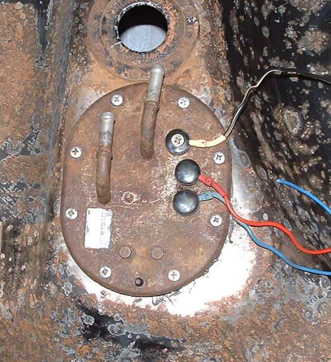

Drop in the FC pump assembly, and wire it up. Depending on pump type used, new pump wiring may be needed. To power the Bosch pump in this install, a dedicated 12 ga. feed was run from the fuel pump relay.
The final assembly looks like this:
Sorry but no pics were taken after the final cleaning and painting of the tank. Access to the lines on the top of the fuel tank is impossible once the tank is mounted, so run sections of line from the supply and return lines first.

What's the small tube next to the fuel pickup?

The one on the pump assembly? That's the return line. It runs right down near the bottom of the tank as well, to eliminate splashing of fuel on return.

I meant the really small tube with the block on the end.

Oh, that's the fuel level sending unit. It's all one integral unit to keep the number of tank connections to a minimum. I checked the FSM, and the resistance range of the FC unit is identical to the 1st gen cars, so it should work fine. I haven't bothered wiring it up, though. It's just along for the ride.
There's also a low-level sensor that hangs down beside the pump as well. This would be a nice addition, perhaps driving an LED tucked into the instrument panel somewhere. A good rainy day project when the to-do list gets a bit shorter!
