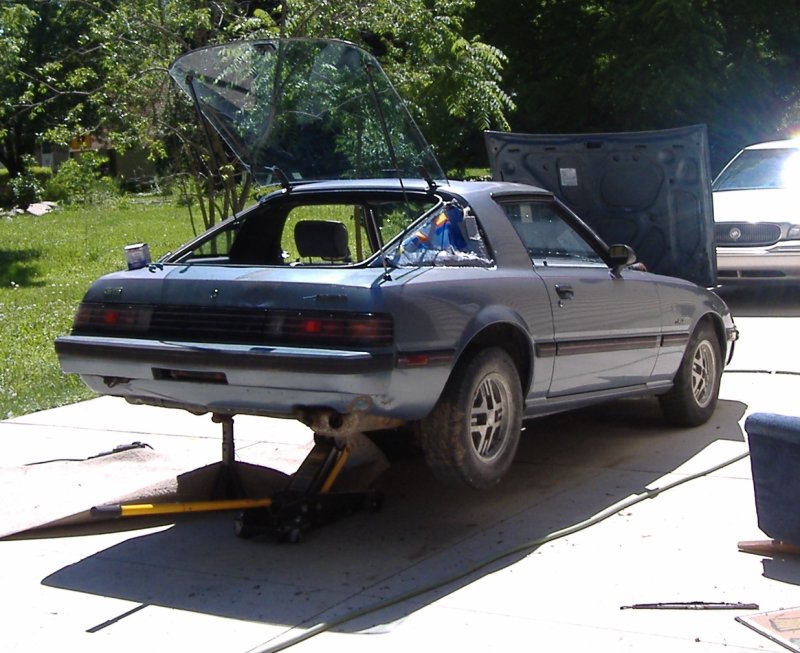

Here she is...

Quite possible. There is a screen on the pickup tube in the tank and they tend to split, letting debris, particularly rust, collect in the tube. I've had them idle perfect, but as soon as any throttle was applied, the engine died immediately.
Your S3 has a drain plug, remove the fuel that way. Have you changed the fuel filter? If draining and a fresh filter doesn't resolve the supply problem, drop the tank, remove the pickup unit, clean it and the tank out. If the screen is split, toss it and carry a spare fuel filter with you. The one I had that plugged, I used my bead blaster to clean the inside of the pickup tube out.
Another method that was posted on cleaning the tube was to chuck a guitar string in a drill and spin it inside the tube. That may save the hassle of trying to remove the rusted screws securing the pickup unit. If you do remove the pickup, replace the screws with new allen head screws, for the next time.
While the tank is down, it's a good time to replace the aging rubber fuel lines and always use new clamps. Spend the extra and buy the FI rated clamps, not the worm drive ones.
Also check the metal hard line between the tank and pump. I have found pin hole leaks from rust under the mounting clamp that killed any chance of the pump drawing fuel,
