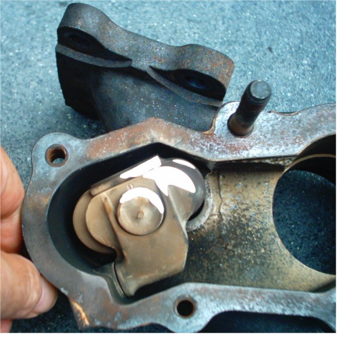

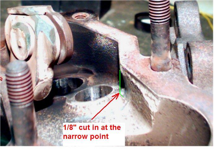

There are some other tweaks you can do also:
File the back side of the door, so it can open wider.
Open up the narrow spot in the exit passage.
Although the wastegate arm does hit the backplate (it leaves a mark on both), if you remove the backplate and open the flap by applying compressed air to the wastegate actuator you'll see that the flap's travel is limited by the the spring in the actuator reaching full compression. You can only get ~1mm extra travel by grinding either the arm or the backplate, which would have neglibible effect on wastegate flow.

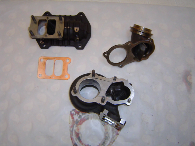

I port-matched the manifold to the turbine housing and also widened the two passages a little bit. Since the die grinder was out, it seemed silly not to...

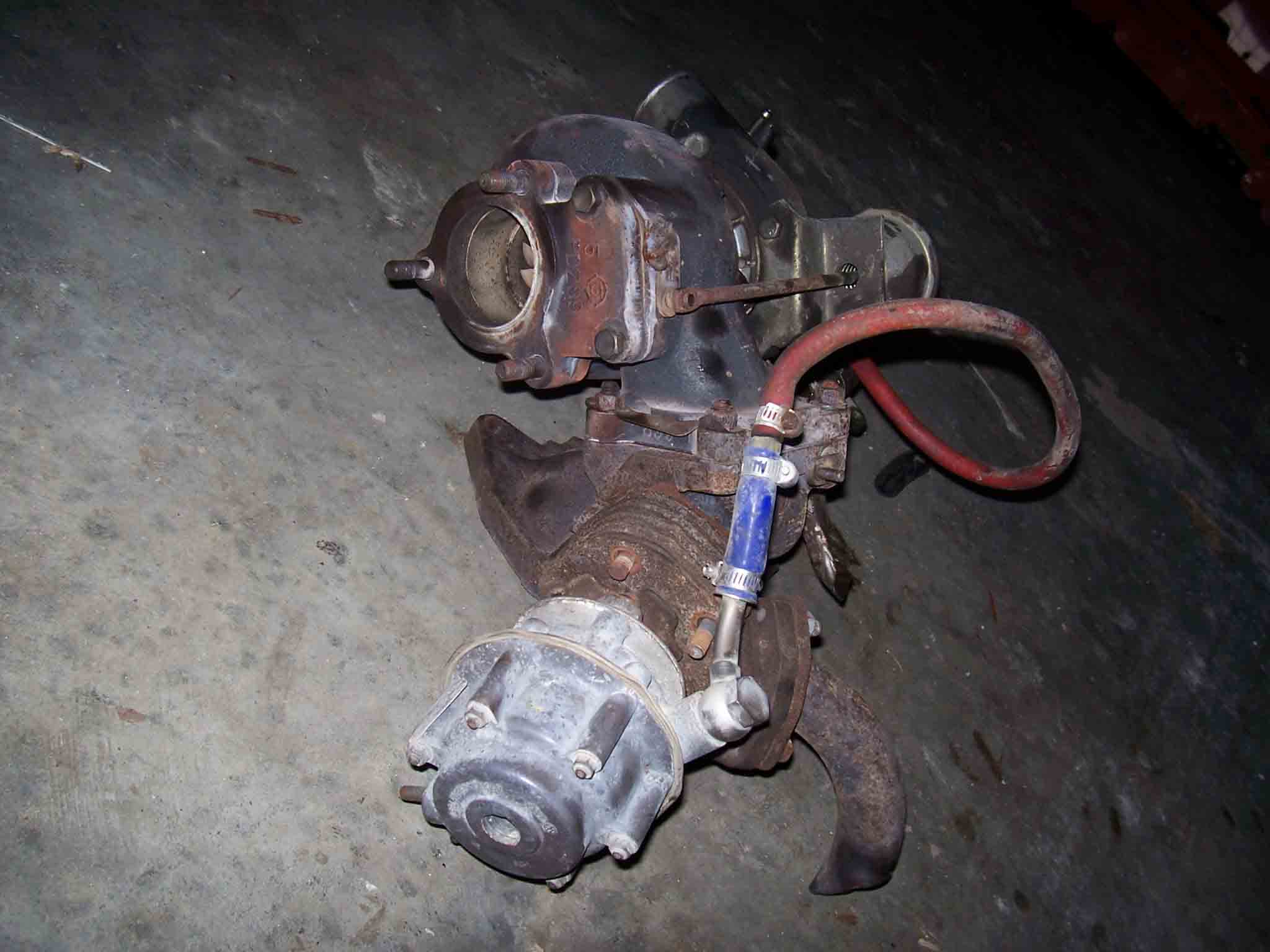

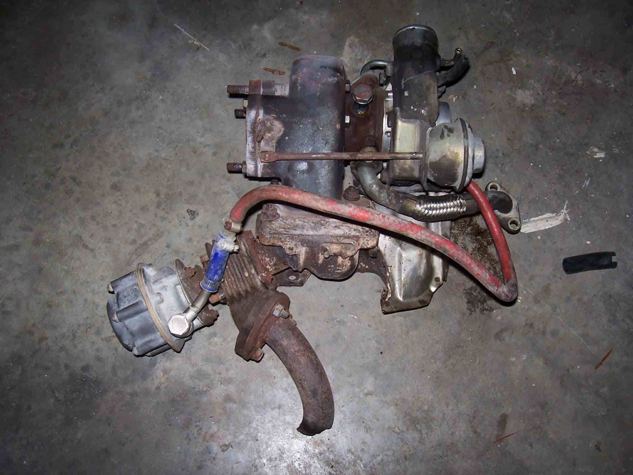

how about an external setup if you really want to get crazy?
I ran this setup last summer...loud as FAWK with the dump tube...
But I never had any creep issues baby...the gate is a VW (probably audi) and is 34mm......

WORD TO THAT!!! haha, I get a little port crazy....
Finished the smaller hole, took it from 18mm to 26mm. Going for the big hole today and finish up port matching.

well, the factory internal was welded shut, so only the external was functional

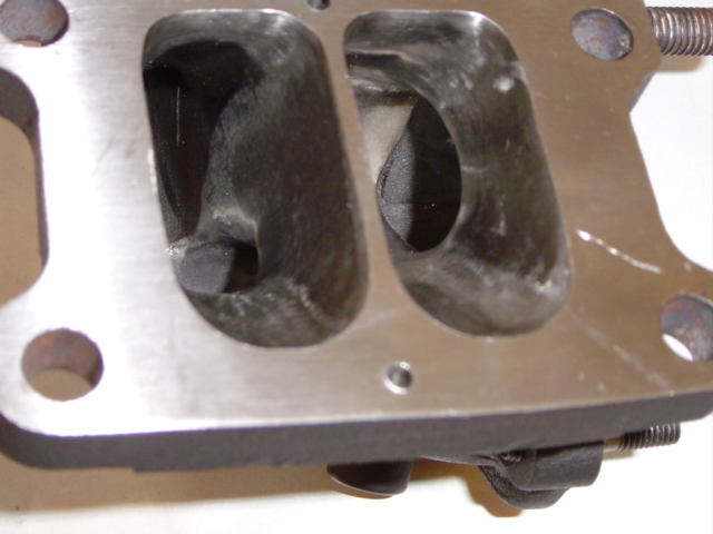

My S5 wastegate ports- still had boost creep with clipped P trim exhaust wheel...
But what finally solved the boost creep was porting the turbo manifold and runners to reduce velocity before the wastegate holes as seen in this pick. Spool was still full 15 psi by 3,500rpm on my little 3" exhaust.
