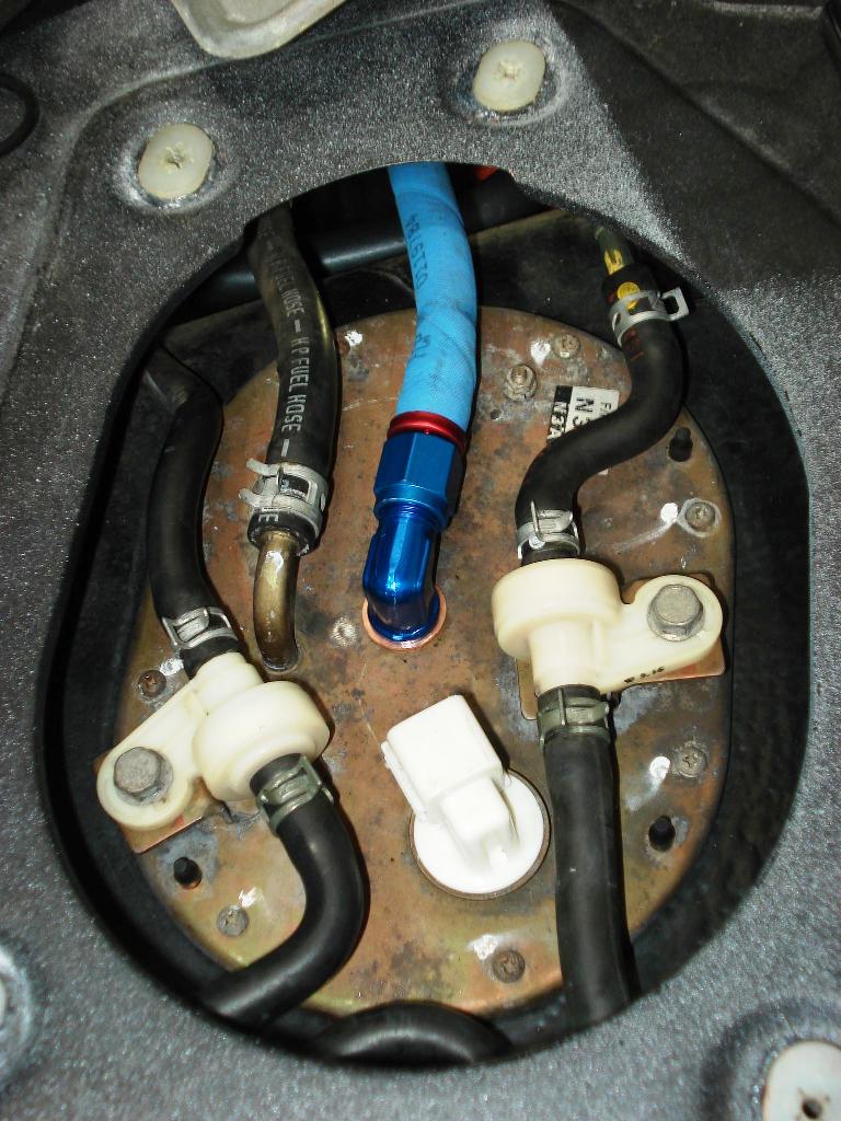

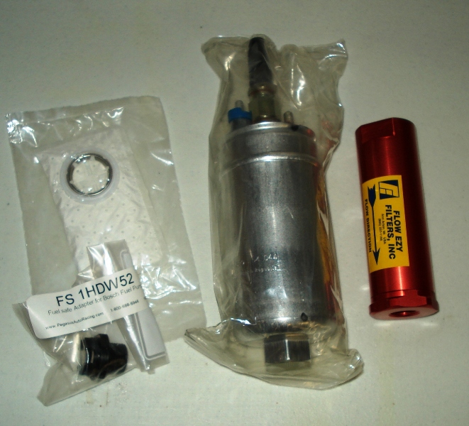

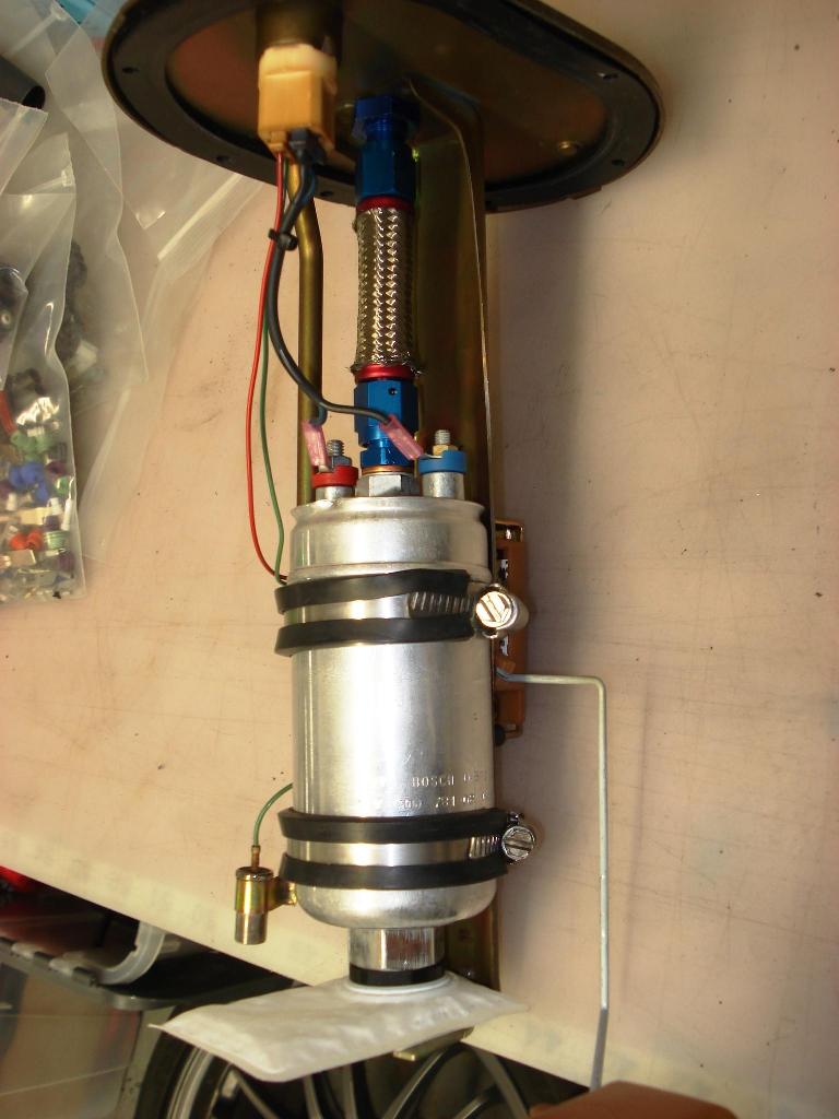

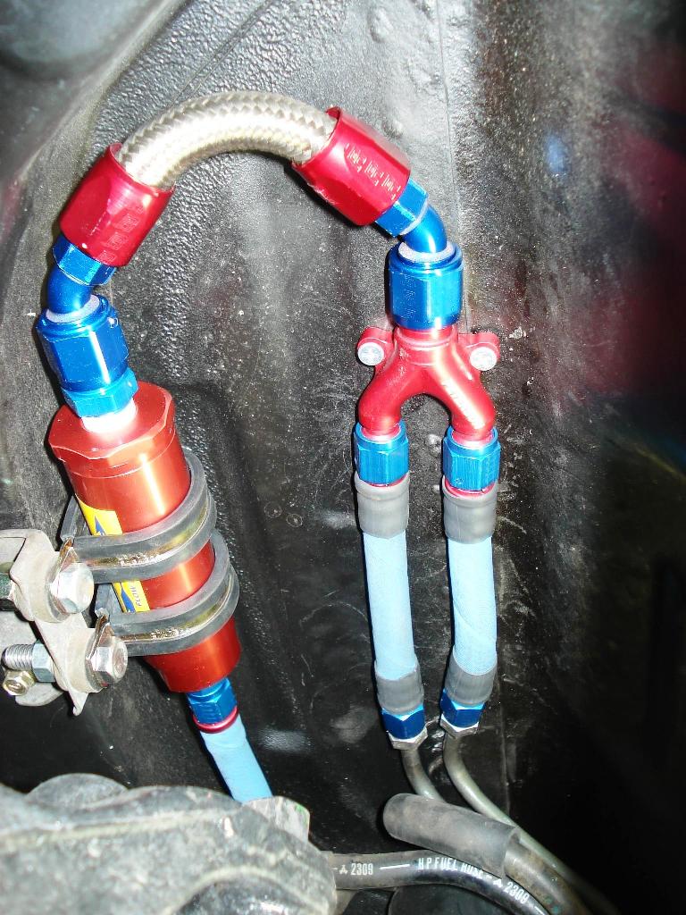

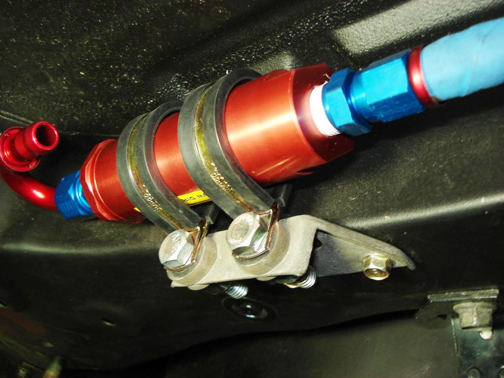

I bought a similar setup from Pegasus racing and the sock that came with it has internal framework in place to prevent it from collapsing.
Pump http://www.pegasusautoracing.com/pro...asp?RecId=6119
Sock http://www.pegasusautoracing.com/pro...asp?RecId=5813
Adaptor http://www.pegasusautoracing.com/pro...asp?RecId=5812
Inline fuel filter http://www.pegasusautoracing.com/pro...asp?RecId=3469
For the outlet A/N fitting I bought a fitting that was originally for a caburator, but machined the hole in the fitting to as big as possible for reduce flow restriction.

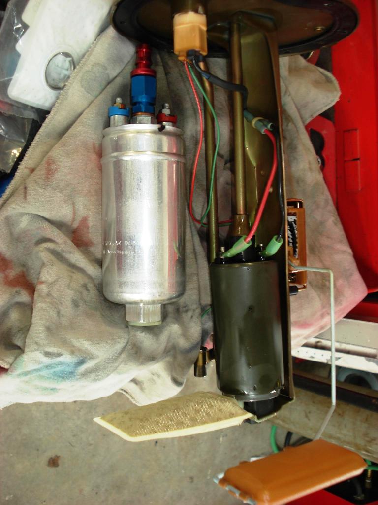

This helps with the fuel slosh.
