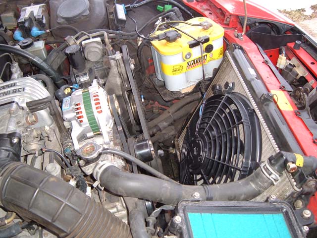

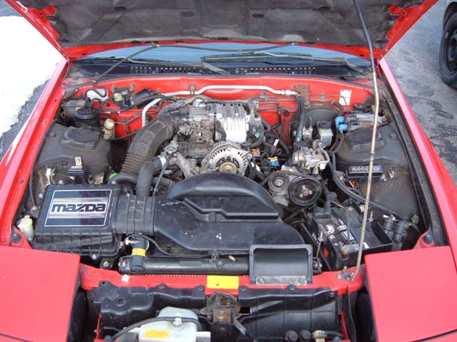

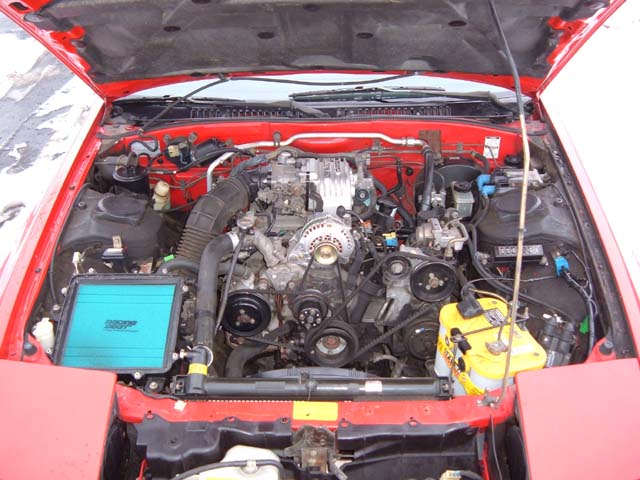

heres some B&A pics of my setup. I used a 2000cfm fan (like i said before), a SPST relay with connector, and a GM Weatherpack connector on to the fan it's self. You can see the relay because it's blue but i plan on replacing it with a black one
Bone Stock
And the new fan setup

^ you there better off with the stock fan, at least the stock fan pull air through the ENTIRE RADIATOR SURFACE, shroud + aftermarket radiator + e-fan, if you drove your car out here in AZ with an electric fan setup like that without the shroud . . your car would die, and you might want to look into gettign a cone air filter . . . my Bonez/K&N filter kicks ass get one from rotary performance, well worth $120, just wait until i get my cold air box, and headlight vent set up woot woot
