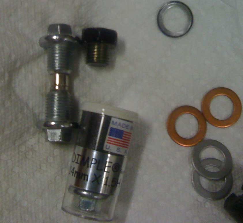

Pic of the Dimple drain plug w/ stock drain plug. I tried to do a side by side pic but the magnet on the Dimple drain plug would just pull the stock plug whenever it got within 2" of it. Definitely a strong magnet!
